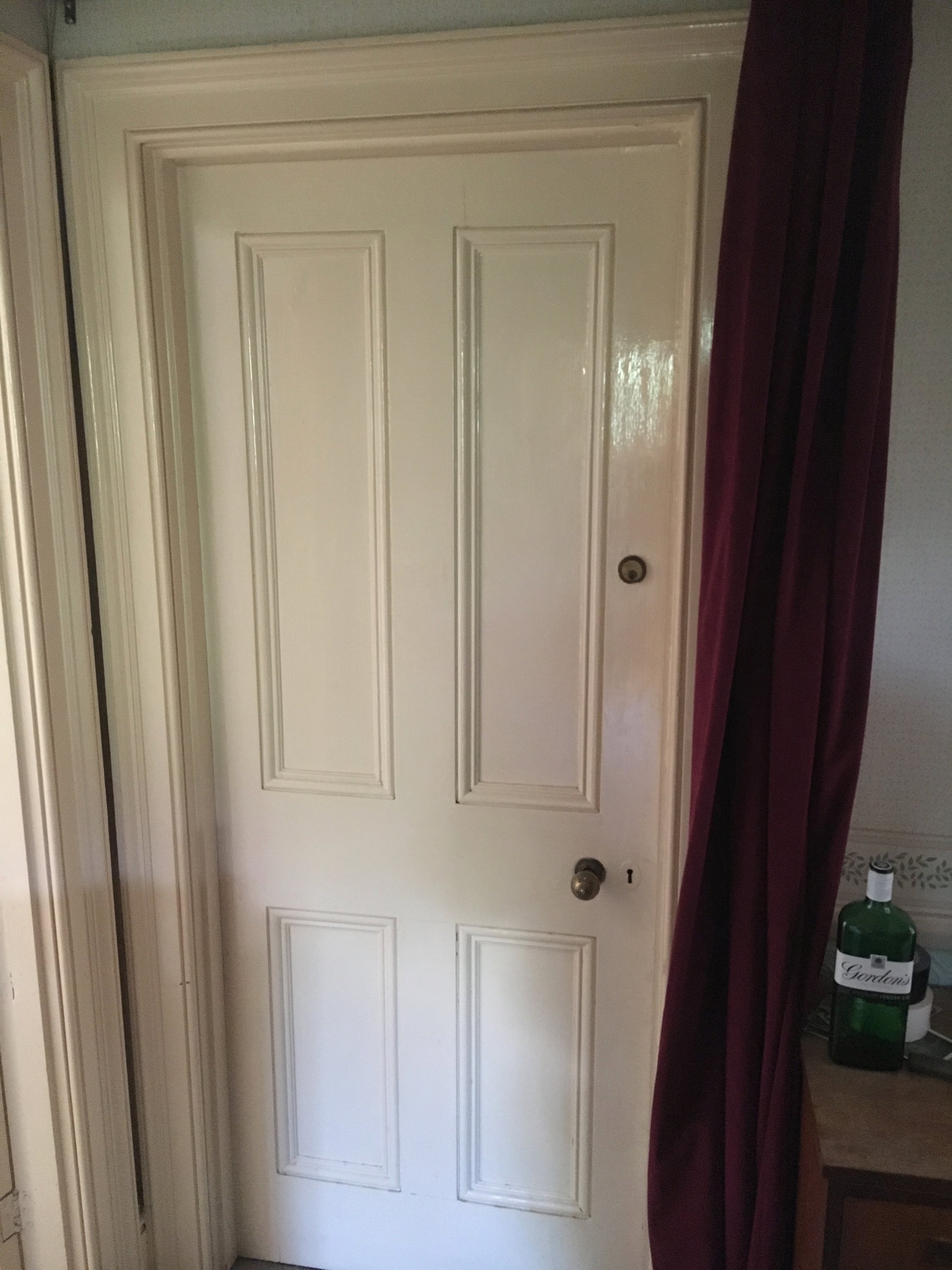

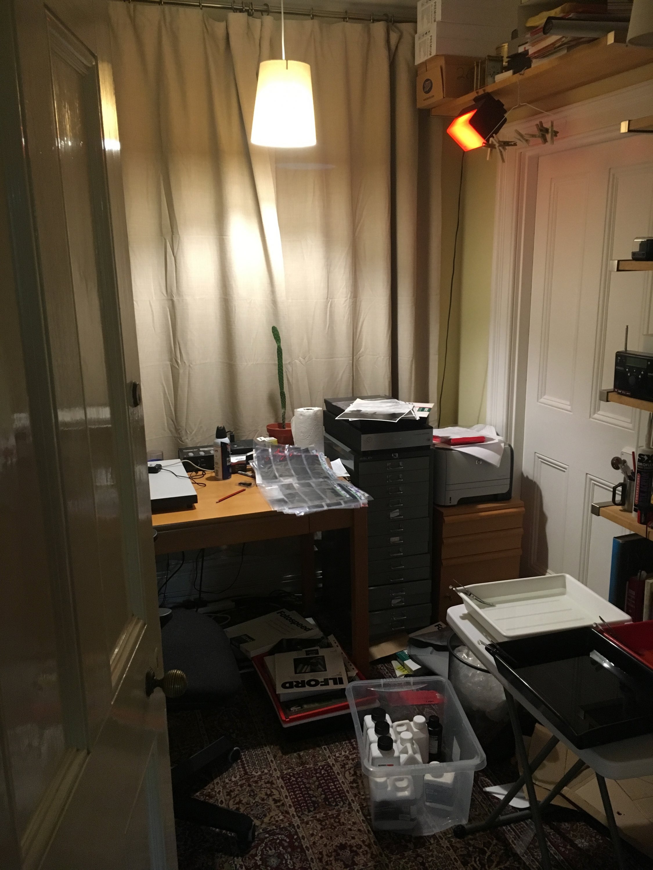

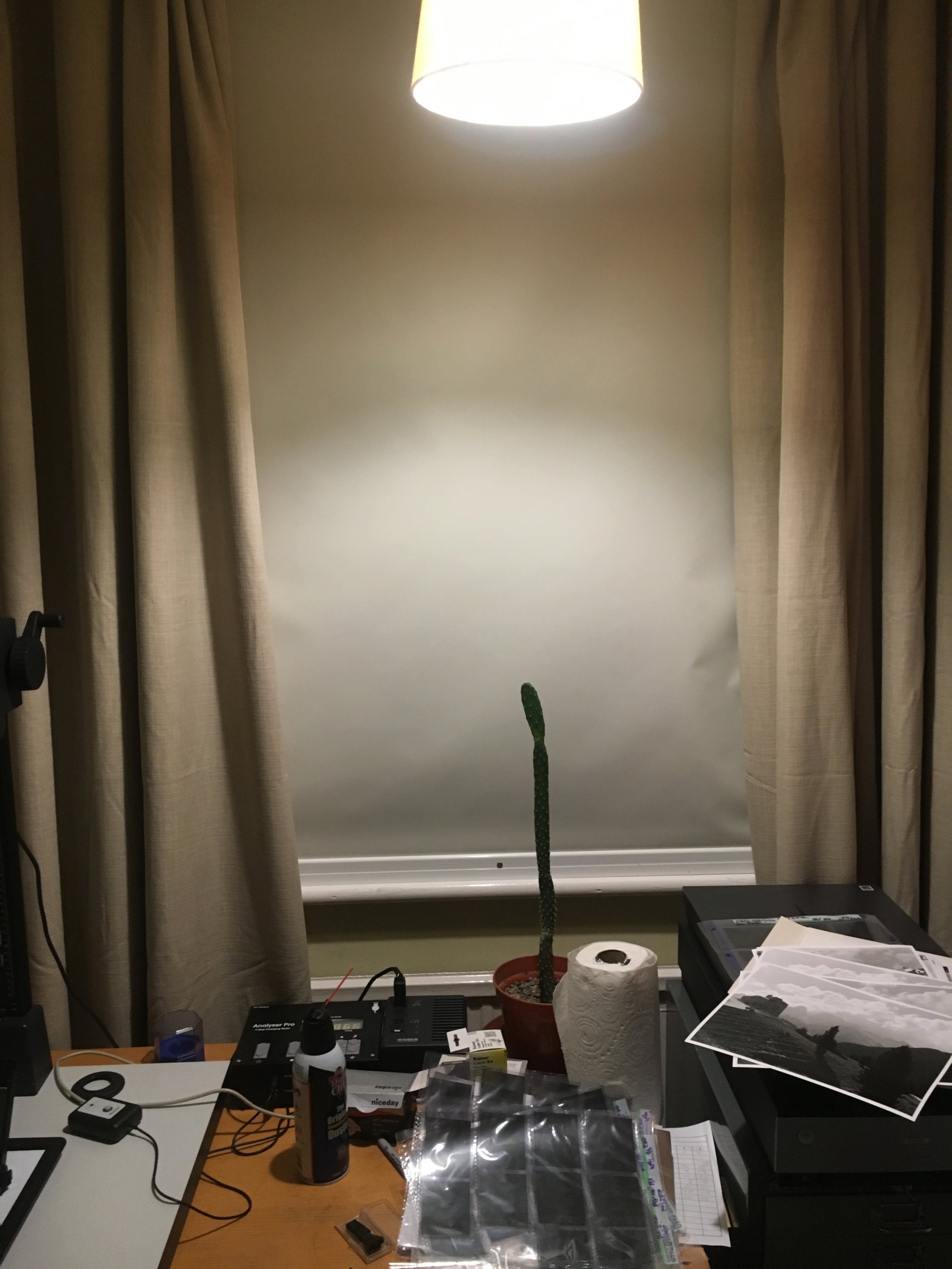

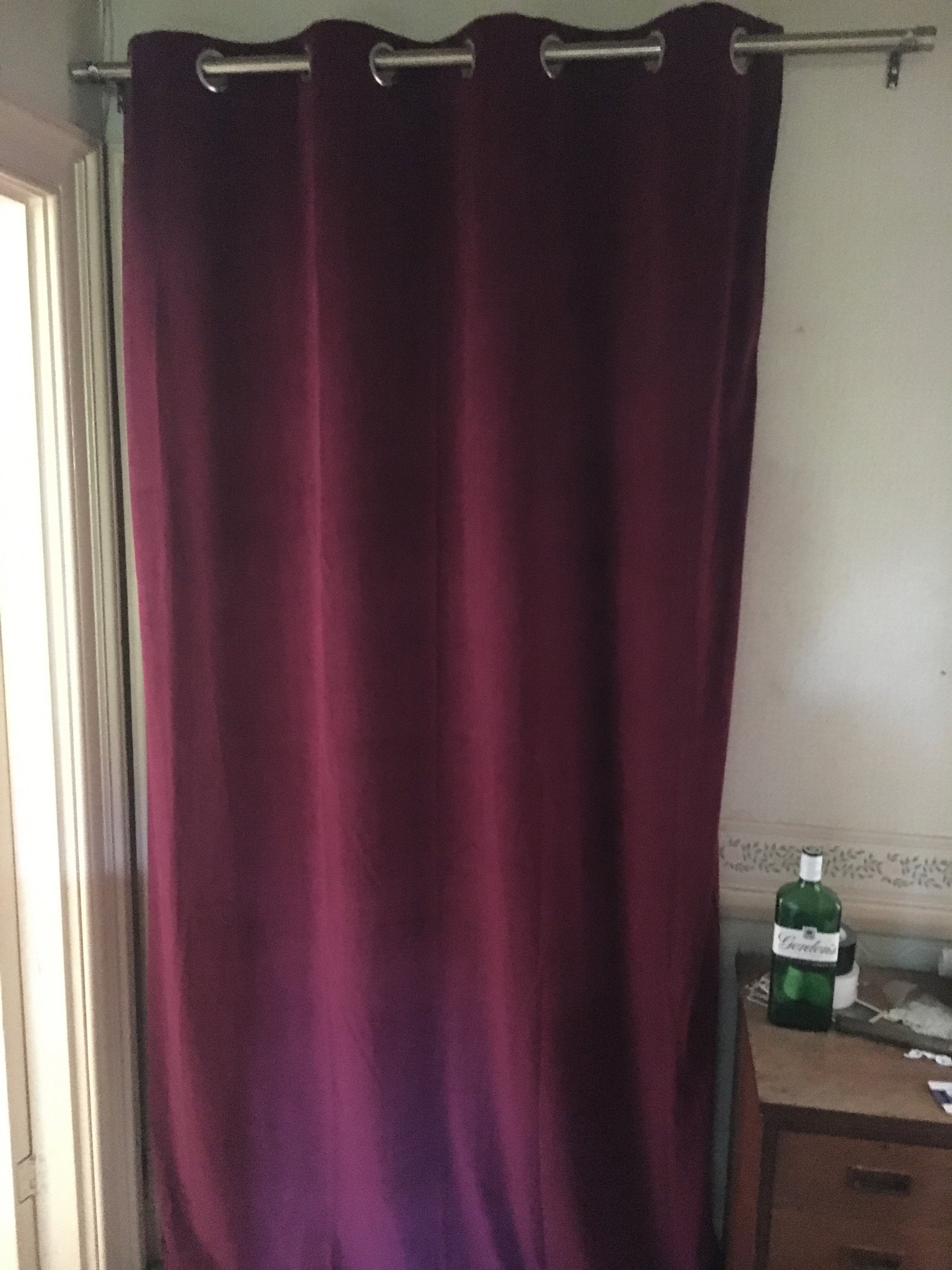

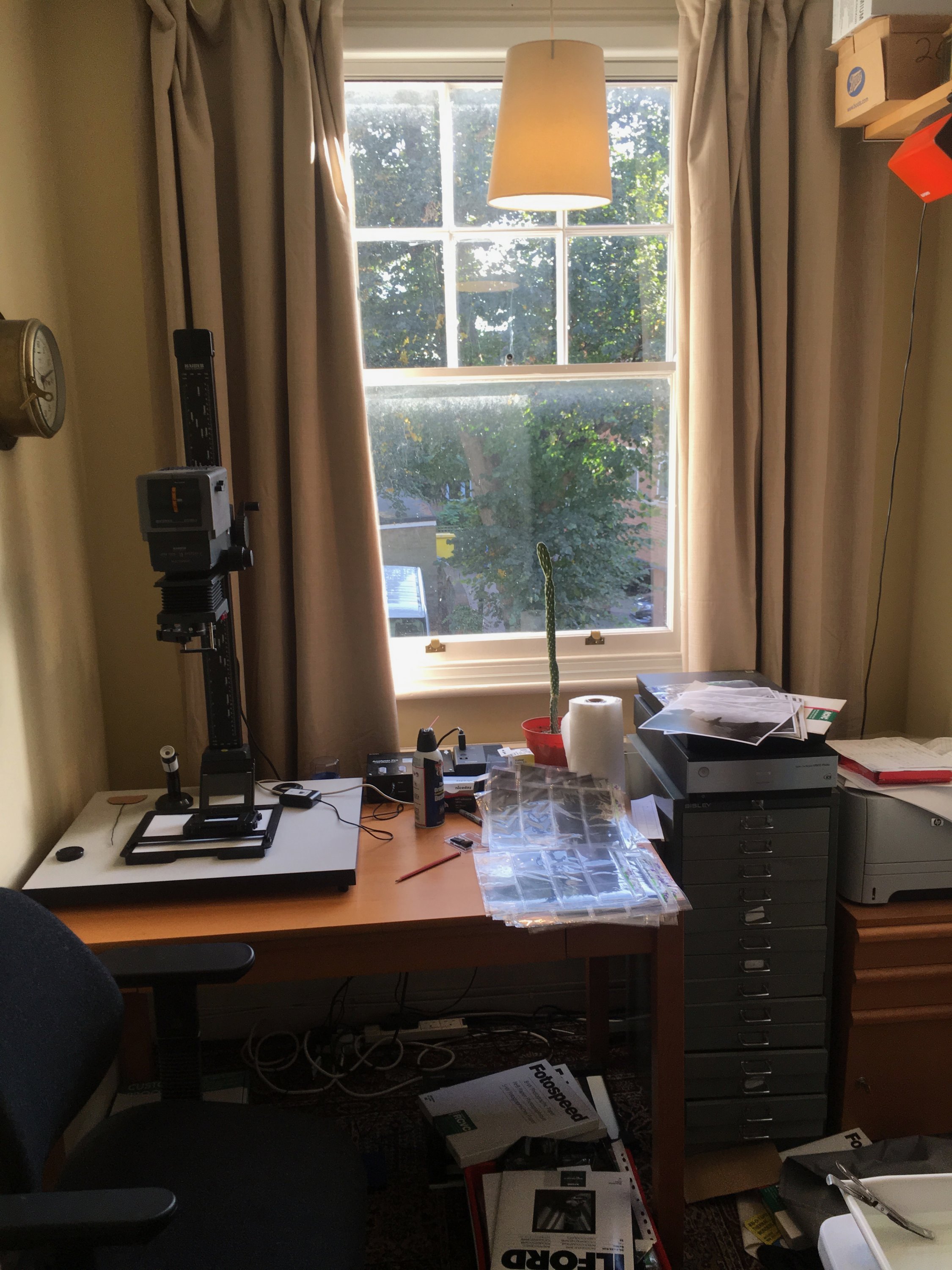

My house is old and my darkroom also has 2 doors and a large sash window. The room is maybe 9 feet x 7 feet but the window is as big as any on the front of the house. It also faces due South, the worst possible for a darkroom. For the window I had a blackout blind custom made. This is the type of blind that runs in side channels and has a header and a footer. Even then it was not good enough so there are heavy, long, lined curtains over the blind. For the doors I put up poles and curtains. It is good enough for printing during the day. For loading film on reels it is only dark enough at night or in a changing bag just to be sure. It can be done!
Hi Svenedin,
If you can just put a picture of how your doors are set up, i will be very grateful. Thanks!
Dear Flavio. Hopefully this gives you an idea of the setup. I do not have water so I put the prints in a bucket and then carry the bucket to the bathroom where I wash the prints. By the way the bottle of gin has Xtol in it not gin! Regards, Stephen

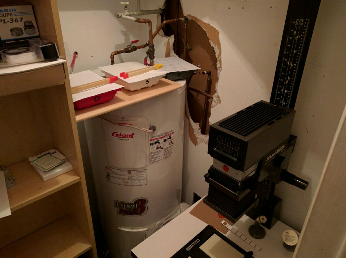

I have just enough space for a chair to setup the enlarger and there is room for 3 8x10 trays, I started with 5x7 trays in this picture until I realized it bit 8x10 just. I wash prints in my bathroom. And for larger prints (up to 16x20) I use drums and a uniroller. I started doing all print development in drums, but developing in trays is a lot more fun! In fact I really have to push myself to use the drums now, even though larger prints can be quite nice.
The other day I was even contemplating stacked 11x14 trays but alas, I doubt it will fit, and it's a closet in my bedroom I don't want to risk any chemical spills in there.
I've also thought of making my bathroom a darkroom, but besides the blanking out of the window I don't like the idea of leaving my enlarger in that everyday humid environment. And carrying a big and heavy enlarger that just fits through the doorway in and out every time seems awkward too. But maybe one day!
