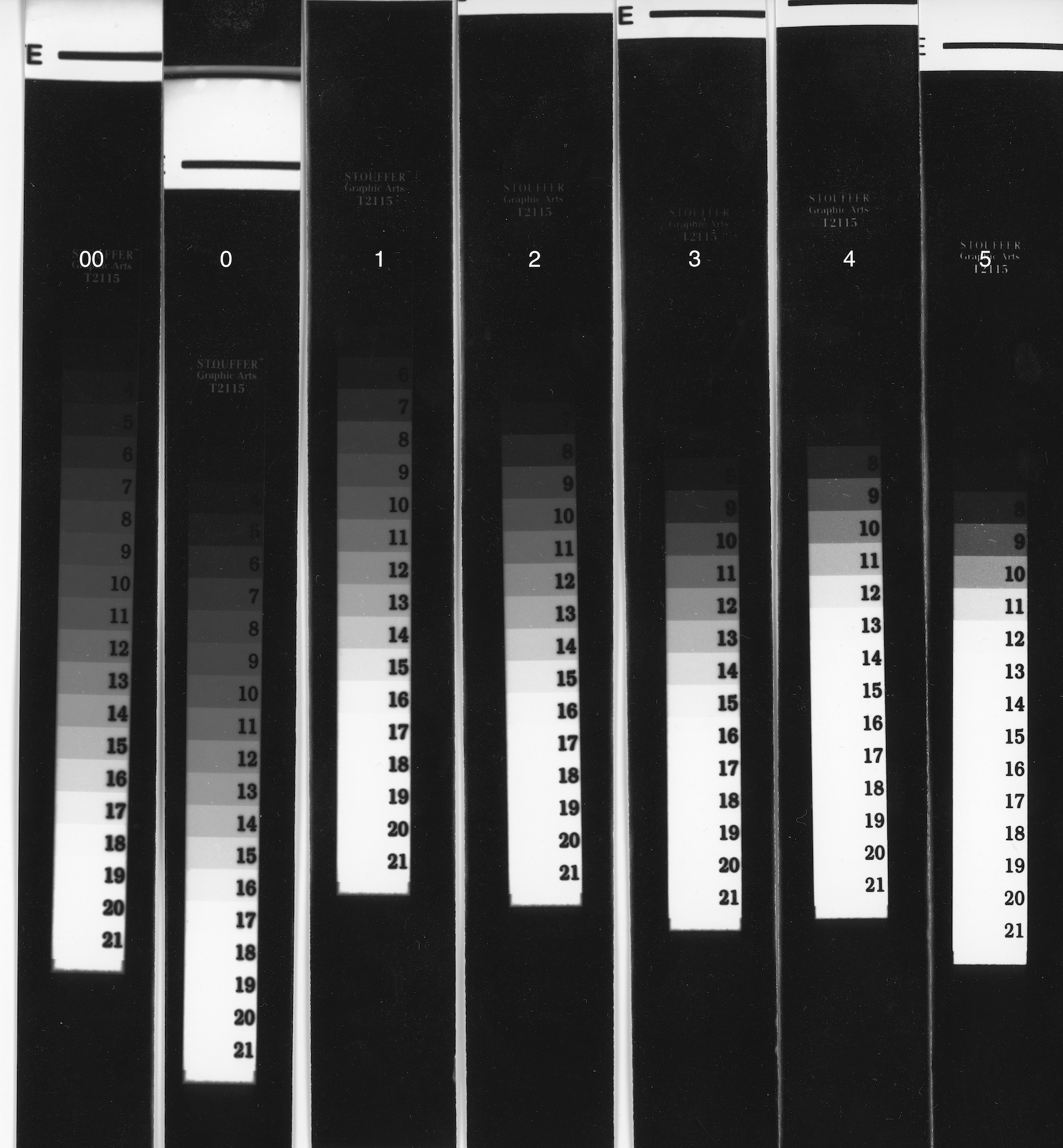

I know this is a bad picture but here is a photo of some step wedges I made about 2 years ago (Ilford MGIV RC).

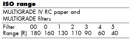

Correct me if I´m wrong, but I´d say your step wedges are too soft, too. With a grade 5 filter, MG IV RC has a copying range of R 40. That only leaves room for total black, total white and two shades of grey. Your No. 5 step wedge has visible distinction on screen from No. 6 (total black) to No. 12 (total white), thus showing a range aprox. R100 which corresponds to a No. 2 1/2 filter:

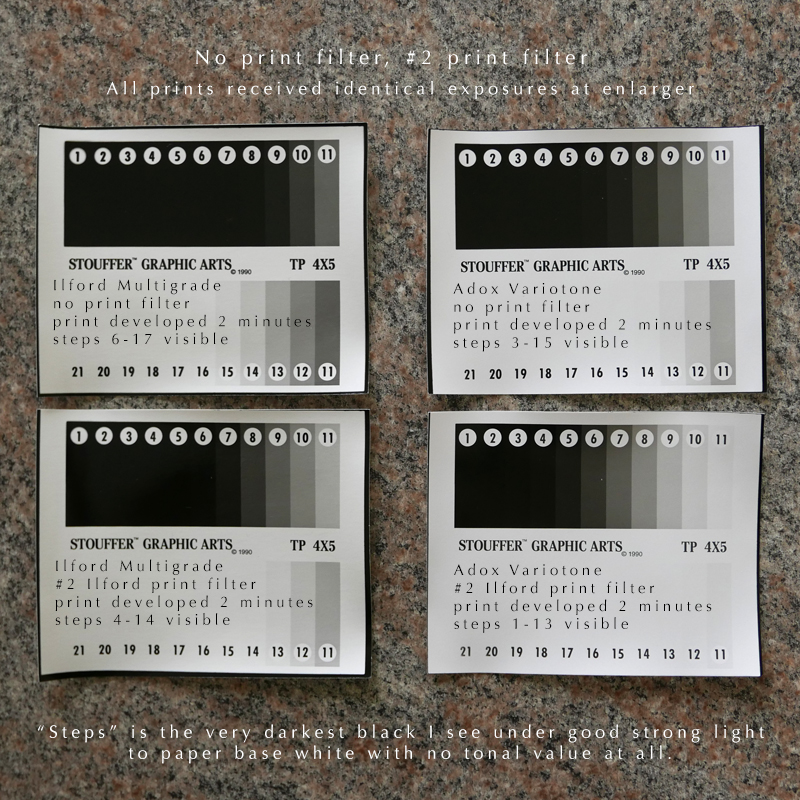

Rauschen, I see what you mean yet I'm not intentionally underexposing the print. I live in an area that allows some okay views of the night sky that aren't totally washed out by city lights. When I'm out with the camera at night the skies aren't a inky, solid black. There's actually a lot up there. Printing the night sky as a solid black destroys the delicate tones and values I've recorded on the film.
I left my test strips next to the prints in my photo above so everyone could see the progression in tones. I do have some solid blacks there. However I chose the exposure time that gave me the most detail, not solid black. If I print for a maximum black, very little is visible and the detail is gone in the increasing murk.
Besides that, I'm clearly not getting contrast grades I should be in my darkroom. From Ilford paper or Adox. Some of my fussier negatives (landscapes, and not just astrophotography) would really benefit from a true hard contrast grade, and I can't figure out what's going on.

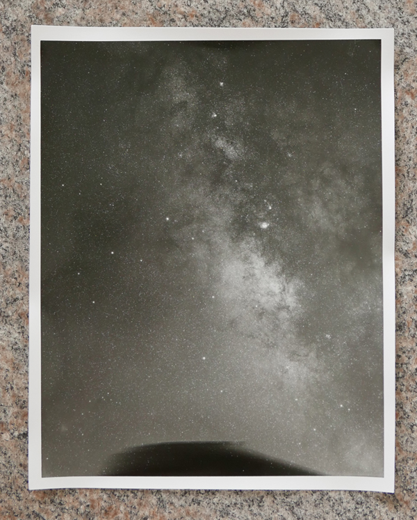

And it's not to say Variotone isn't working for me. Here's a print made with absolutely no printing filters at all. When I tone this later in selenium it will get even better.

The print you are showing without filter seems to have more contrast than the one with a No 5 Filter. Have you made a step wedge without filter? To which grade does it compare from the filtered step wedges?
Correct me if I´m worng, but I´d say your step wedges are too soft, too. With a grade 5 filter, MG IV RC has a copying range of R 40. That only leaves room for total black, total white and two shades of grey. Your No. 5 step wedge has visible distinction on screen from No. 6 (total black) to No. 12 (total white), thus showing a range aprox. R100 which corresponds to a No. 2 1/2 filter:

First, to Rauschen: I'm not sure your demands on paper contrast are in line with reality: Does any paper at a supposed grade 5 really ever get to R40 and only "two shades of grey" between black and white? It would be nice if this were so, but it's not my experience.
To the OP: It seems a bit futile to strive for extremes in paper contrast when simply developing the negatives longer will get you what you need. You should be targeting you negative contrast so that it falls somewhere close to the middle of the available paper contrasts you have (regardless of what these are for your paper of choice). This will give you a bit of leeway to adjust either direction with paper contrast. Of course, this doesn't help with existing negatives, but should make life easier in the future. Existing negatives can be intensified by a number of means (I prefer bleach/redevelop in a staining developer).
As regards the color temperature of the lamp being used: If you have good filters, the color temperature of the lamp will have no effect on print contrast, just on print exposure time. Say you have a lamp with lots of red, some green and little blue being emitted. When using the highest contrast filter, which only passes blue and no green, you will have to simply expose longer to build up the proper exposure of blue light; the green is being filtered out and will not affect the image. In order to make the image less contrasty, the paper would need exposure to green light, which, in this case, is being filtered out.
As Rauschen points out, there are a lot of things that can reduce paper contrast. I think it's pretty easy to rule out many of these.
First, print development times are not carved in stone. Most modern papers simply increase in effective speed with extremely extended development (some papers gain contrast with longer development, but that can only help here...). Being sure you are developing long enough to get the maximum contrast from your paper is, therefore, simple. A four or five minute developing time will ensure that you are getting the most contrast from your paper (you'll have to adjust print exposure, of course, but that's easy). And, be sure you are using a fresh developer that is designed to give good contrast.
Second, safelights can affect contrast in other ways than fogging. Prolonged exposure to red safelights can reduce contrast by means of the Herschel Effect. To eliminate any possible effect of safelights on print contrast, just make a print in the dark.
Possible enlarger fog and/or fog or degradation from the lens can be eliminated by simply making a contact print. (As an aside: I find that enlargements are always a bit softer than contact prints even with the best lenses).
Certainly filtration has a direct effect on VC-paper contrast. If I were not getting as much contrast as I thought was correct, I'd check my filters by exposing a print through a Wratten #47 blue filter. This will ensure that your paper is seeing only blue light and, if you are doing the things mentioned above, ensure that you are getting the maximum contrast your particular paper is capable of. If that is still too soft, then it is the the paper. The paper may have lost contrast for a nuber of reasons. Try again with new or different paper. Or, the paper is fine and you are simply asking more of it than it was designed to give, in which case, you need to address the shortcomings of your negatives.

Not a demand of mine, just what Ilford is giving us as reference under perfect circumstances. Probably, such a result cannot be achieved with most setups. But the Ilford Data Sheet is the reference to determine how much off we are. In the end, everybody needs to be happy with their process and results and that´s all what matters.

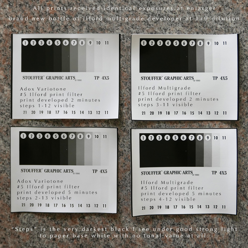

Doremus, both you and Rauschen have mentioned something that's clued me in to a potential culprit--the paper developing time. For over fifteen years I've only used one time, two minutes, for every fiber based paper I've ever picked up. I have noticed that Adox Variotone has a long delay for any image at all to show up in the developer tray and I think it's increasingly likely I've been snatching the print out of the developer before the full range of tones have had an opportunity to fully form. As I still had a black value appear in the paper I never suspected anything amiss. I was taught long ago and the manufacturer's literature said two minutes at the minimum, so I never even considered a too-short developing time.
I'm going to increase the print developing time. I can't wait to get in the darkroom tonight to try it!

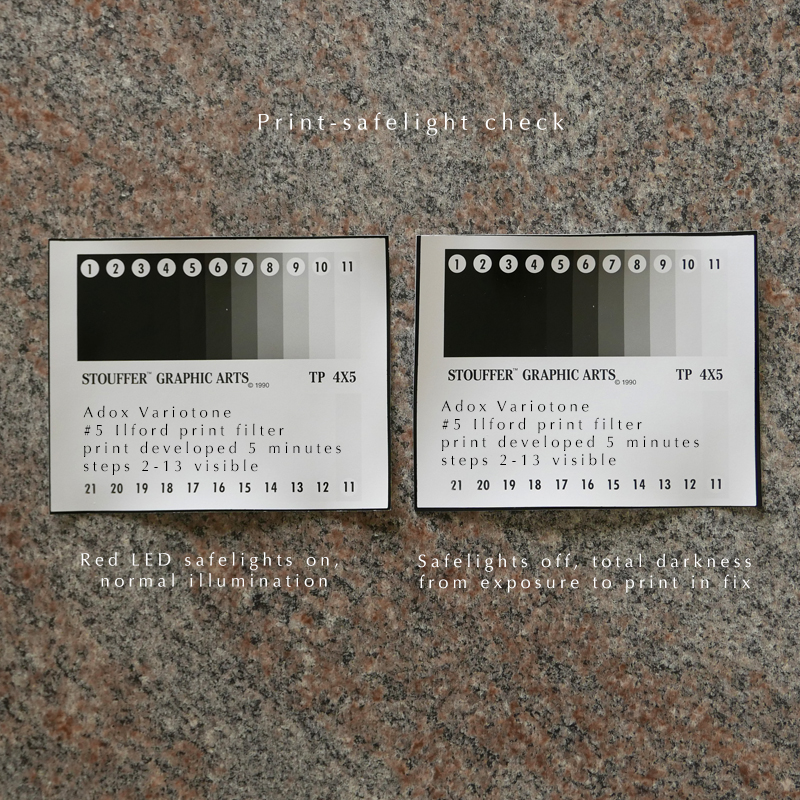

Doremus, you also mentioned red safelights can have an effect on contrast. I'm using red LEDs as safelights in a fixture I built. I've heard of this red-light effect only once before. My safelight tests have come out clean, yet can you elaborate on how red light can be affecting my prints?

There's a phenomenon known as the Hershel Effect in which a blue-sensitive emulsion loses contrast after prolonged exposure to red light. Some here (notably Ian Grant) claim this can have an effect on some photo paper emulsions. This is a separate issue from safelight fogging.
I haven't yet had the opportunity to test it definitively, but I did have problems getting max contrast out of Adox MC110 in a darkroom equipped with red safelights (Kodak 1A filters). My present darkroom has OC filtration, so that's not an issue. I mention it just in case it may possibly be affecting your particular paper. The easy way to test is to make two identical prints, one in normal safelight and one completely in the dark from start till it hits the stop bath and see if, indeed, there is any difference.

Well, I really thought the print development time was it. Another round of step wedge prints last night are showing me that isn't it either. I opened up a brand new bottle of Ilford multigrade developer too. Looked perfect, no oxidation or any other problems I could see in the bottle. I also timed how long it took an image to appear in the developer. For both Adox and Ilford papers (these are fiber base), it was fifteen to twenty seconds. I'm back at the beginning with the same problem.

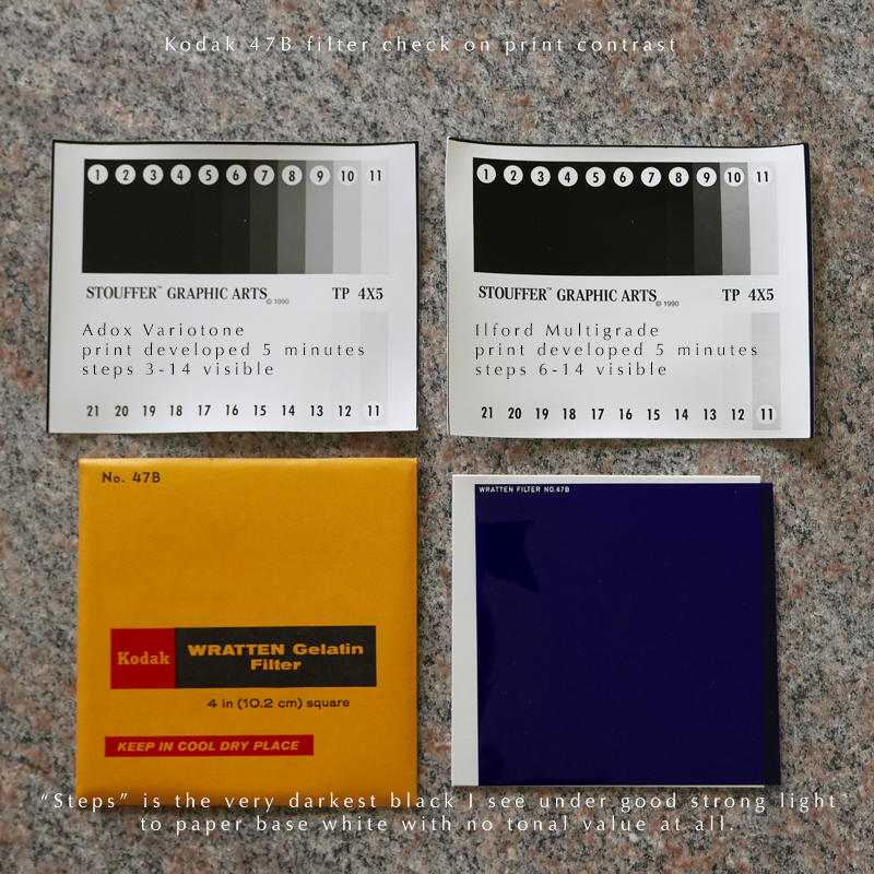

Doremus, I do have a Kodak 47B filter here (I used it earlier as well, see posting #10) and I made step wedge prints with that too last night. It prints the same as the Ilford #5 filter other than the 47B needing four times the exposure.
And I did a print with my safelights off. Identical to the prints with the safelights on.
Lastly just to see if the print contrast filters were doing anything at all over an unfiltered exposure:
So the filters are working, it's just not in the ranges I've come to expect. Increasing the contrast on Variotone continues to vex me.

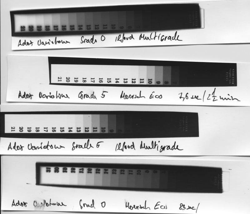

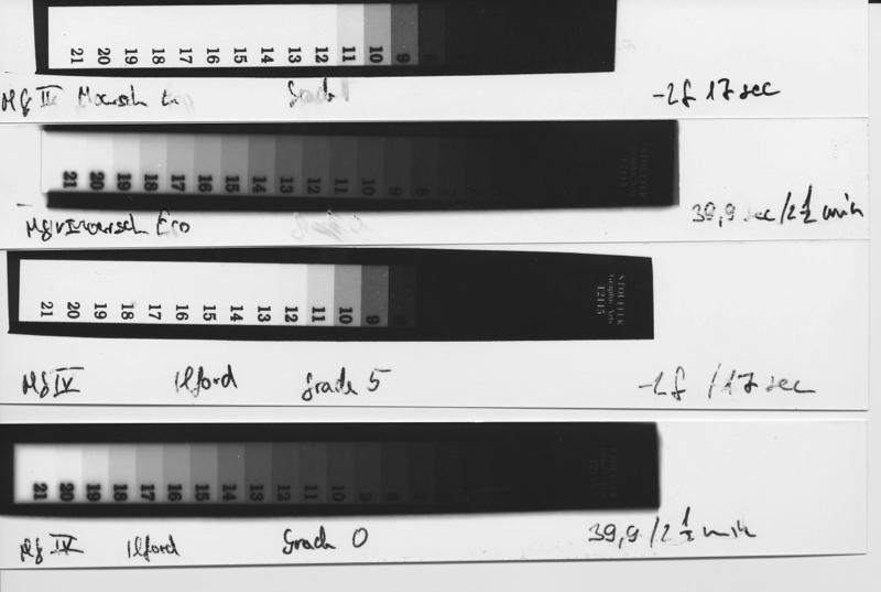

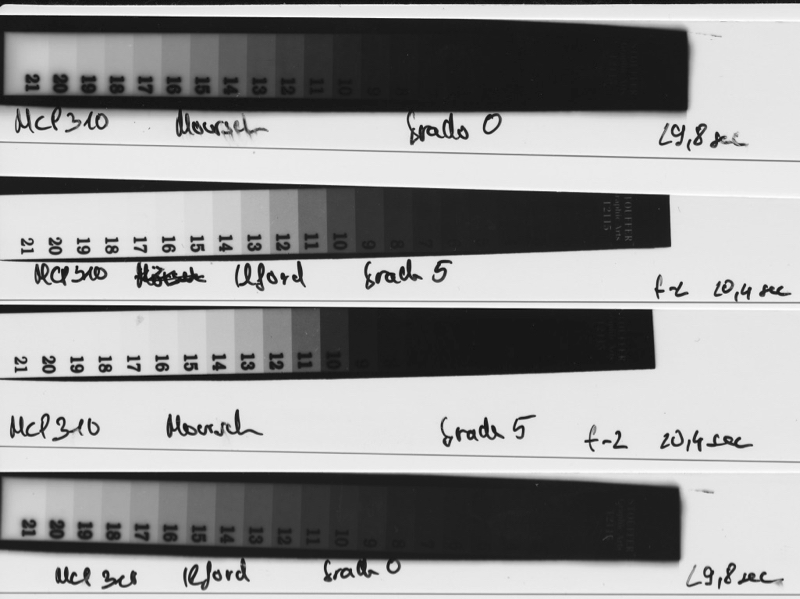

Test Wedge Adox MCP 310 - 1.jpg Test Wedge Adox Variotone - 1.jpg Test Wedge MGIV - 1.jpg
Inspired by this thread, I have made a test series looking for the "Holy Grail" (i.e. true Grade 5).
I have made some test wedges (Stouffer 21 steps strip, 0,5f or 0,15 density each step) some nights ago which I will show you below. I have tested Adox Variotone (matte), Adox MCP 310 (glossy) and Ilford MGIV (matte) making test strips at grade 0 and grade 5 developing in Moersch Eco 4812 and Ilford Multigrade developer.
The process: paper at room temperature (21,5 degrees centigrade), cutting the strip under safelight, exposure of all strips (one by one), storage of the cut paper and exposed strips in a light safe box. Then development without any prolonged exposure to safe-ligth except for the necesarry times.
Exposure via contact printing with a Heiland Splitgrade Filter Module in a Dunco 67 unit. This gave a few problems due to the heavy relection from the contact printing frame.
Development for 2 1/2 min (MCP: 2 min only) @ 21-22 degrees
Stop bath: 2% citric acid
Fixer: aprox. 1-2 min. in Moersch alcaline rapid fixer
Washing as required for the purpose (not archival)
Drying in an hot air dryer
examination under Just Normlicht (aprox. 5400 K)
The Moersch Eco was pre-used and not at its best but still good. The Ilford Multigrade was freshly mixed from a bottle of brownish concentrate, just after the Adox MCP310 failed in the already mixed batch.
The Variotone gave the following visibility ranges (including full white and full black):
Moersch Eco: Grade 0 steps 4-19 - Grade 5 steps 5-12
Ilford Multigrade: Grade 0 steps 5-21 - Grade 5 steps 5-14
Dmax: around 1,65
The MGIV gave the following visibility ranges (including full white and full black):
Moersch Eco: Grade 0 steps 3-21 - Grade 5 steps 6-12
Ilford Multigrade: Grade 0 steps 4-21 - Grade 5 steps 6-12
Dmax: around 1,7
The Adox MCP310 gave the following visibility ranges (including full white and full black):
Moersch Eco: Grade 0 steps 5-21 - Grade 5 steps 6-17
Ilford Multigrade: Grade 0 steps 2-21 - Grade 5 steps 3-17 (results not reliable, the developer,had to be replaced)
Dmax: around 1,85
The Variotone and the MGIV gave the results I expected. The Adox giving best results in the Moersch developer and the MGIV giving best results in the Ilford developer surprised me a bit. I would have expected that the Ilford developer as a neutral tone developer would build higher contrast than the Moersch Eco Warmtone developer. Maybe totally fresh developer at a higher concentration could give a little additional boost to contract, or a special high contrast developer. The MCP310 has been giving some trouble for a while. I usually print it a +0,3f and +0,5 Grade (compared to the measurements with the Heiland Splitgrade) to get good results - this print was "standard". Also Mr Heiland updated his firmware once because the adjustment curves of this paper had given problems.
