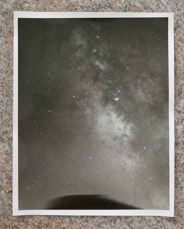

I use Adox Variotone Warmtone fiber paper as my standard go-to in my darkroom. I really like how it renders the values of my negatives, and the toning qualities are just excellent. However, for some time now I've been struggling to get the paper to print at high contrast grades above a 3. The paper doesn't want to react at all to a 4 or 5 filter. It seems to plateau around a grade three and won't go any higher. I changed my printing filters to check if that was it. Bought a brand new set. No improvement. I cannot get a high contrast grade out of this paper.
Has anyone who has used this paper noticed any problems getting it to create high contrast grades?

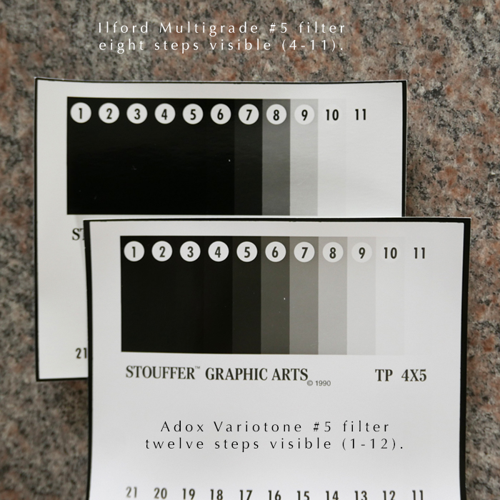

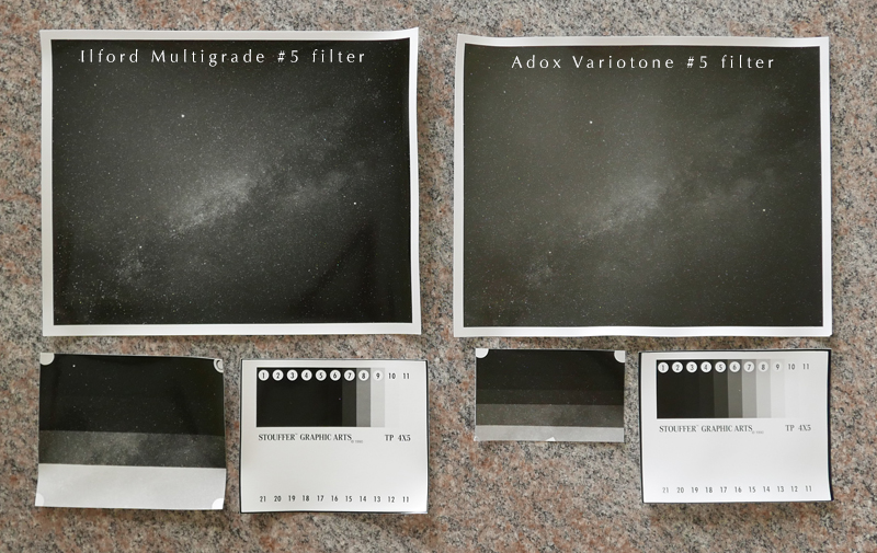

Svenedin, last night I reprinted everything, and used some Ilford Multigrade right next to my Adox Variotone. The Multigrade paper worked fine and as expected, please see the photo I've attached below. For whatever reason my Variotone just doesn't want to print at high contrast levels.
I re-made both prints at the same time, same enlarger, same Ilford print filter, same print developer. I also did some step wedge checks, using filters for grades 2-5. Again, same enlarger, identical exposures, exact same tray of developer. I'm only showing the #5 filter results. My notes in the photo are what I see in good light from maximum black to paper base white. My prints and the step wedge are indicating to me Variotone just doesn't do high contrast.
I even pulled out a Kodak 47B tri-color filter for making separation negatives. It's a deep, deep blue filter with an incredibly narrow range of light it allows to pass through. If anything will trigger the hard contrast grades in paper, this filter would do it. I printed through that onto my Adox Variotone and even that filter wouldn't increase the contrast either.

Have you properly adjusted the exposure time to the filter / paper combination? The Dmax of your print on Variotone seems too low (on the computer screen). Have you tried making a print with +0,5f in addition to the normal time adjustment due to the filter?
Which developing time are you using? I have test MGIV RC / Adox Variotone / Foma MG Classic, and the Variotone can take a little more time in the developer. The MGIV RC in Ilford Multigrade in my process usually gives good results after 90 seconds, the Variotone and the Foma MG Classic need more like 3-4 minutes before the Dmax and tonality are ok.

Thats not grade 5 on ilford either. Steps 4 to 11 with each step being half a stop is 1.2. Ilford says one should be able to get 0.4-5 or 1.5 stops from memory for grade 5. 4 stops is a hard 2 i think.
(Im assuming your wedge goes in half stops)

Rauschen, I use a two minute developing time for fiber papers. I did notice when I had both papers in the tray that Ilford Multigrade has density that appears rather quickly once it goes in the developer, and my Adox Variotone takes much longer to appear in the tray before an image appears. I do compensate for the printing filters, and my Variotone print above is deliberately light on exposure just so I can retain the milky way in the print. Adding more exposure and printing darker I lose most if not all of the nebulousity.
Craig75, my step wedge is in increments of .15 and / or half stops.
Really bothersome is I just compared all my step wedge prints last night. Adox Variotone with a #5 Ilford print filter is matching step by step tone for tone my Ilford Multigrade paper exposed with a #2 filter.

I have looked through my notes & samples, I did the test with Adox MCC which gave best results (in my process, my opinion and visual inspection only) @ 3 mins in Ilford Multigrade developer. If it helps, I checked the Heiland Electronics Splitgrade Controller Manual, and Heiland recommends developing Adox Variotone for 3 mins in Moersch Eco (1+14). In my experience, Moersch Eco is a little slower than Ilford Multigrade Developer, but not enough to make up for an entire minute. (Side note: for the Ilford Multigrade Warmtone, the developing time by Heiland in Multigrade developer 1+9 is 2 mins)
I am not sure if I understand you right, but in the end, you underexpose to keep Dmax (and contrast?) low, right? Underexposure does affect the tonal range of the print. Probably you are seeing the combination of some underexposure with some underdevelopment which significatly pushes the midtones into the highlights.
+1.000.000!!!!!
You are so right. The 8 steps (4 to 11) correspond to a range of R 120 - which according to Ilford data sheet (https://www.ilfordphoto.com/amfile/file/download/file_id/1945/product_id/739/) should be achieved with the Filter 1 1/2 !!! A filter 5 should produce a range of R 50 only which correspond to 3 steps of the step wedge only.

Rauschen, I see what you mean yet I'm not intentionally underexposing the print. I live in an area that allows some okay views of the night sky that aren't totally washed out by city lights. When I'm out with the camera at night the skies aren't a inky, solid black. There's actually a lot up there. Printing the night sky as a solid black destroys the delicate tones and values I've recorded on the film.
I left my test strips next to the prints in my photo above so everyone could see the progression in tones. I do have some solid blacks there. However I chose the exposure time that gave me the most detail, not solid black. If I print for a maximum black, very little is visible and the detail is gone in the increasing murk.
Besides that, I'm clearly not getting contrast grades I should be in my darkroom. From Ilford paper or Adox. Some of my fussier negatives (landscapes, and not just astrophotography) would really benefit from a true hard contrast grade, and I can't figure out what's going on.
And it's not to say Variotone isn't working for me. Here's a print made with absolutely no printing filters at all. When I tone this later in selenium it will get even better.

So now it looks as if you cannot get the required contrast grades with either Ilford or Adox paper so seems less likely to be anything to do with the paper. I would check the light source as I suggested in post #6. You say you have fresh, new developer and have already checked the safelight is "safe". Have you checked anything else in the light path (lens, condenser etc) ? I suppose it is possible that a really filthy or fungus ridden lens could reduce contrast.
