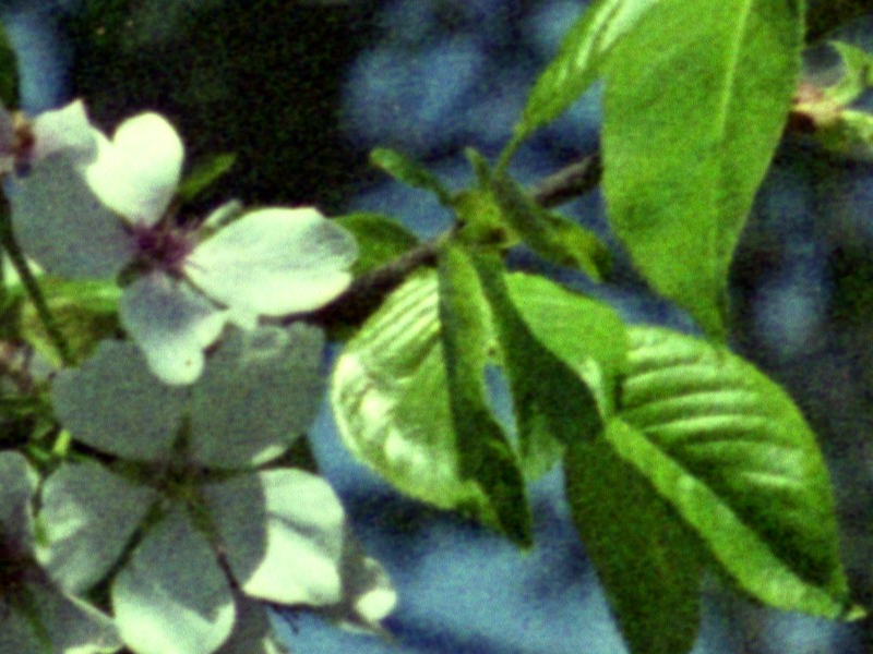

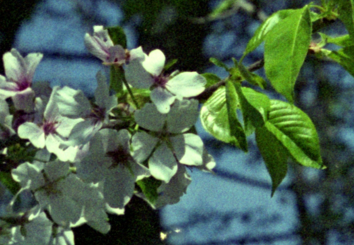

My film carriers arrived today -- and I discovered the ones I bought aren't the right ones. Apparently the 4870 and 4990 use very different film carriers (I thought they were the same bed, just a resolution upgrade for the 4990).
So I still don't have a set of negative carriers that fits this scanner, though I've done a couple tests by dropping the negatives on the glass in their archive pages. With the old Arcus 1200, this would have resulted in slightly out of focus images; with the Perfection 4870, it works reasonably well (backing up the claim of autofocus). With the image/file size limitations of this forum board, I'll have to post large scans externally (which doesn't bode well for the long term aging ability of this thread). Given the focus adjustment exists, let me see if laying the Agfa's negative carrier on the Epson's glass will get me anywhere (I suspect the calibration slots will cause trouble, but let's find out).
Sigh. No, that didn't work at all. Calibration problems, as I suspected.
Let's try the 4990 carrier. Works, in that it will scan film in the carrier slots. Doesn't work in that it's too far off the glass and even in manual, I can't force it into focus.
Time to go shop for the right negative carriers.
Okay, change of plan.
Apparently, the only film carriers available for the 4870 I just bought are modified 4990 units, at about $127 each (vs. the $70 plus shipping I paid for a set of four -- 4x 35mm 6-frame strips, 2x 120 1/4 roll strips, 2x 4x5, and 12x 2x2 mounted slides, masked for 35mm frame). Looking closely at the modified units, it was obvious what mods were made -- they took off the standoff feet, and then removed the alignment tabs on the user's right edge. Conversion obviously requires sophisticated tools -- converting the 35mm carrier took me about five minutes, with fingertips (the feet have clip latches accessible from the top side, just squeeze and they drop out), a folding knife I carry every day (to score the alignment tabs so they break off cleanly), and the file blade of my Leatherman multi-tool (to smooth off where the tabs were removed).
With the conversion completed, I found the auto focus apparently succeeds, and got what appears to be a correctly focused scan. Here's a 1:1 crop comparison, all from same negative frame.
From the Agfa Arcus 1200, original glassless carrier at fixed-focus position (pardon the apparently underexposure, this is cropped from the raw TIFF scan rather than the auto-corrected JPG). 1:1 crop.
Epson Perfection 4870, modified 4990 film holder on bed glass, autofocus, 4800 ppi. Yep, it's 4x the size, 16x pixel count. Cropped from JPG (hence exposure corrected).
Epson, closer crop.
Epson, same crop as above, 2400 ppi.
This all stems from the discussion about how "easy" it is or isn't for a new film photographer to digitize their images. Obviously, if you're sending your film out, you almost can't avoid getting a DVD or thumb drive with lower resolution scans than even the Agfa Arcus example above. Digitizing doesn't get any easier than that, but if you don't live in a major city, you probably don't have a local processing lab, so you wind up sending your film hundreds or thousands of miles to one of the big labs that advertises online. Cost will be close to $20, including priced-in postage, to get your negatives back along with the scans (else why both with film, just shoot digital in the first place), a little more to get higher resolution scans, even as good as the Agfa scan above (just under 2 megapixel from a 35mm frame).
This shows that, for about $200 (one time) and a little research, you can get 8-ish megapixels from 35mm even if you're downgrading your scans to half the nominal optical resolution of the scanner. At full optical resolution, you're likely to wind up doing some digital grain reduction (most casual users will do that anyway, along with automatic dust removal). But once you know you need to modify the film carriers, and how easy it is to do, along with learning to process your own film (also pretty easy, and you don't have to spend the money for that equipment at the same time you buy the used scanner), you can shoot film for a couple dollars a roll above the actual cost of the film itself, and the scanner pays for itself in a few months.
So, "easy" is relative. IMO, it's both easier and cheaper to obtain, set up, and use a flatbed scanner than a quality digital macro setup, with either slide copying attachment (only works on 35mm, remember, and requires you have a compatible camera body and lens) or copy stand, macro lens, and backlight source, and unless you've got a professional eye, you'll probably never be able to see the difference in the final images (certainly not if they're displayed on a common computer monitor).
Thank you for going through the trouble to post results of your film digitization on 2 different scanners.
My, sort of, high level view on this (and perhaps a confirmation bias too) that:
the process you went through, the expense, the know-how-needed, the time it took and the results -- are simply not competitive
for online image distribution. Even with that second scanner with higher res.

I really don’t see what you tried to prove or show in the above?
All your scans are obviously horrible, and it really isn’t clear whether it is due to the film, the scanner, missed focus, or all of the above.
There are loads of comparisons out there that show the big big difference between a well executed DSLR scan and a flatbed scan.
I send my film to The Darkroom, and get my film developed plus high resolution scans. If I want prints I can get silver emulsion prints too (I have a few and they turn out well).

@Helge There had been interest in seeing the difference between my old scanner and my "new" old one. Since you're apparently one of those people who only want to see perfection, why do you even read and post here? This forum is obviously deeply infested with imperfect amateurs, and merely opening this site must be physically painful for you.
I scan mainly to preview the potential of negatives for darkroom printing, which I'm not yet (quite) able to do again (and have never, to date, done in color). My Epson is new to me, and I'm still on the learning curve in terms of getting the best scans I can. I have no interest in DSLR or mirrorless beyond scanning my film, so it makes no sense for me to spend more and engage a steeper learning curve that doesn't fit my workspace as well as this Epson, for equipment I'll only use the same way.
What is perfection? The gold standard is an RA4 print with good technique. And by that standard your scans, or any other flatbed falls far short.
