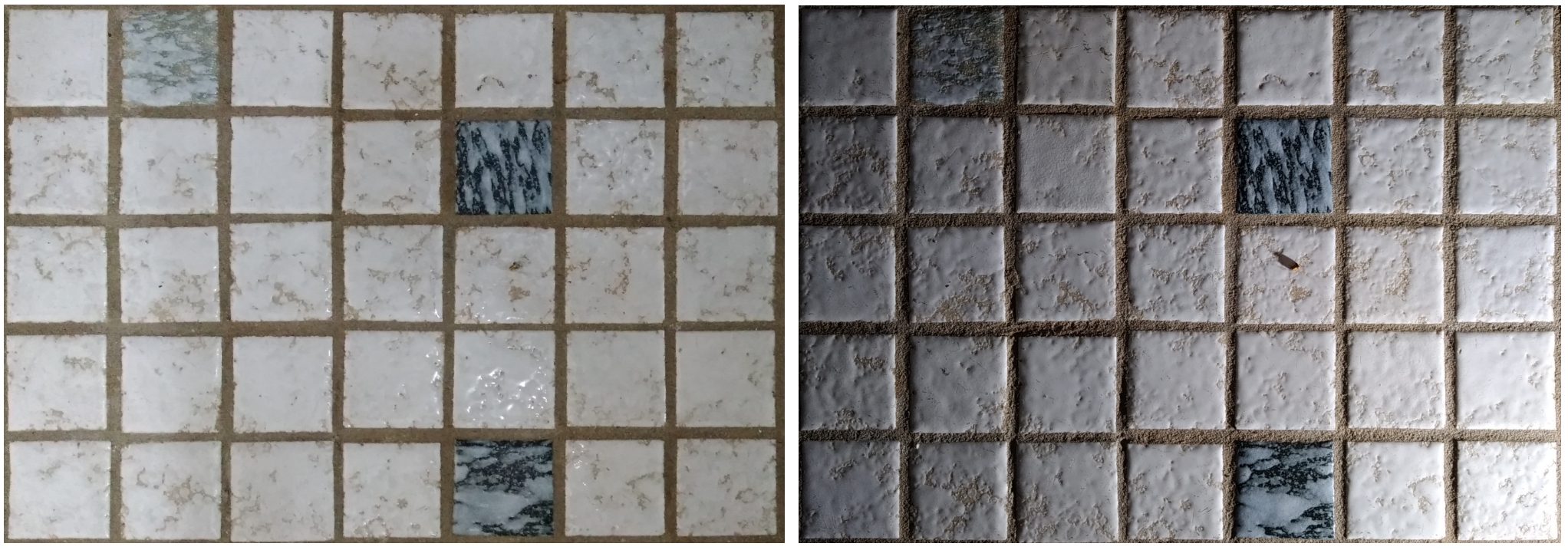

I could add a tip for finding small parts. My tiled mosaic floor is a nightmare when small pieces fall off. If it does happen, I hold a strong lamp as flat as possible over the floor to create strong drop shadows. I often find the piece again, for example this tiny 2 mm long M1.4 brass screw (ceiling light only on the left, lamp on the floor on the right):
We have a similar hard floor here. Falling metal pieces jump off of it in all directions like fleas.
With a strong bar magnet I sometimes manage to catch something. Or with a small broom and shovel. The remaining things disappear forever in secret corners ... 👻
