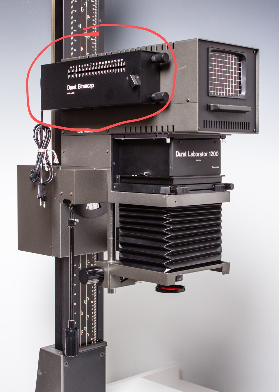

Hi, finally my Laborator 1200 is set up in my darkroom and is operational. Man, it's huge - my old M70 looks like a child toy compared to that monster. I decided to go for classic condensed head - I have never had such enlarger, so I'll play with it for a while before I get LED source.
Now, few questions:
1. Got two condensers for 4x5 - Femocon 151 and 152. I'm aware that convex sides should face each over, but which goes where? If they were the same, the would have the same symbol, so for me, one should go to bottom, and the other to top, but which one?
2. Bulb power - mine was equipped with 250W Opal bulb. Durst manual recommends 150W with 250W possible within short time - what does it mean?
3. Lamp placement - how should I adjust it? I noticed some vignetting which is something new for me (I've been using diffused light before) - does it have something to do with it? How should I overcome it anyways?
4. Focusing - why there are two knobs for focusing? Is there any particular reason for it?
5. 6x6 and 135 masks for neg carrier - is there any need to acquire those?
6. Light leaks - they come from cooling holes at the bottom of B&W head - underneath the filter holder, and on sideways. Is it normal, or some sealants wore off?
7. Lens holders - I've got Lapla 39 and 50 which fits my 50 and 80 Componons and Lapla 50 for Rodagon 150, but I remember that I needed to use recessed plate which I also have now - Sitopla 39. When should I use that after all?
That's all for now, and I hope forever. Your comments much appreciated as always,
Kal800
Now, few questions:
Kal800
Very quick important information.
Don't use a 250W bulb! There is high risk of destroying the mirror due to excessive heat.
Bulp placement is done with the knobs on the left side of the head.
That I know. The thing is that I do not know what should I adjust in terms of an outcome. Other words - how it looks like when the bulb is misplaced?
halfaman
Sep 22, 2012
1,509
Bilbao
If the bulb is not correctly placed it will produce vignetting and you will see it projecting the light without any film though the lens wide open into a sheet of paper. If so, adjust the position with the knobs until you get even ilumination.
