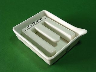

This is what I'm still looking for.
I took these images from the funnest place on the Web
https://www.photomemorabilia.co.uk/index.html
12 pence in a shilling 20 shillings in £ . 5 and 6 would be about 30p in decimal money. Penny went farther in the good old days.
