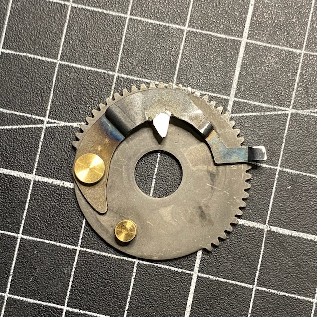

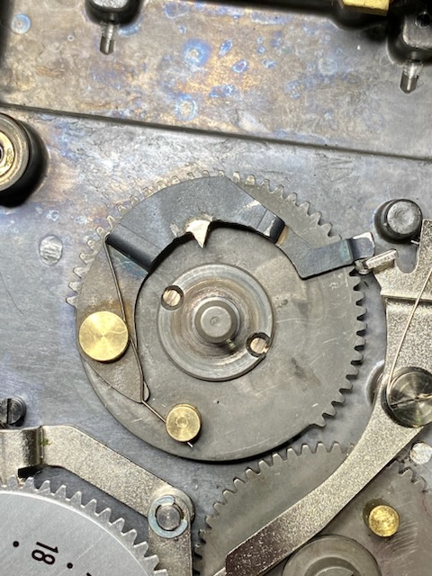

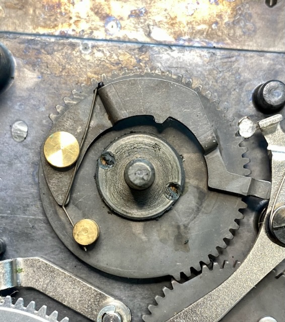

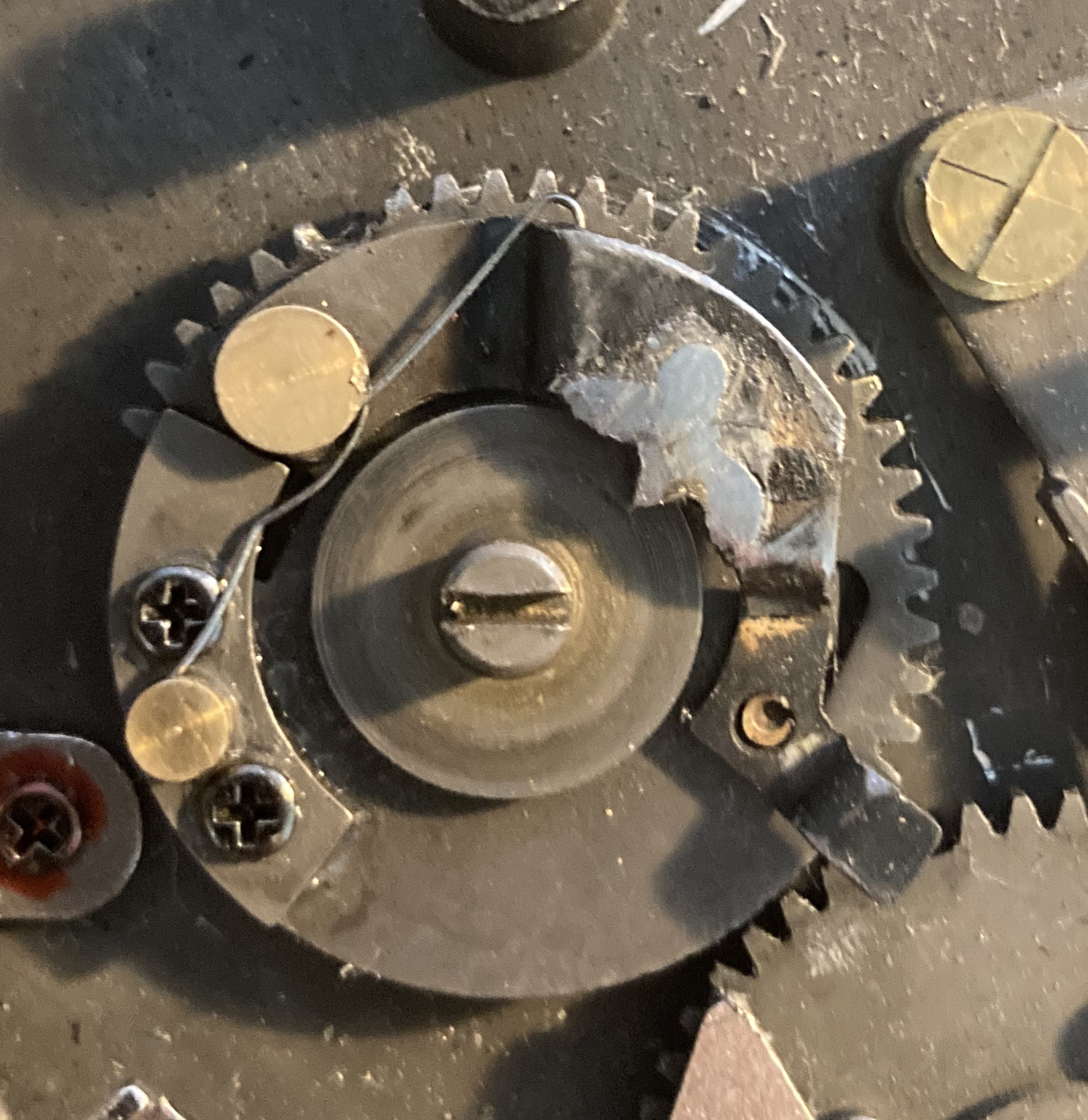

Hi all,
I would lie if I say I’m not happy… here is the piece (fixed) that normally brakes in Kowa Six cameras.
Some photos showing the evolution.
52B4934E-6106-4864-BA20-4B8FE1B8BDE0.jpeg2BC9E6B6-E450-4349-B7CC-9407E48F1BA0.jpeg1053C74C-36CA-49D3-8CB3-2E263F65D6CD.jpegAF5E29D7-F5E2-4988-A3CC-B1D13C18FBE4.jpeg

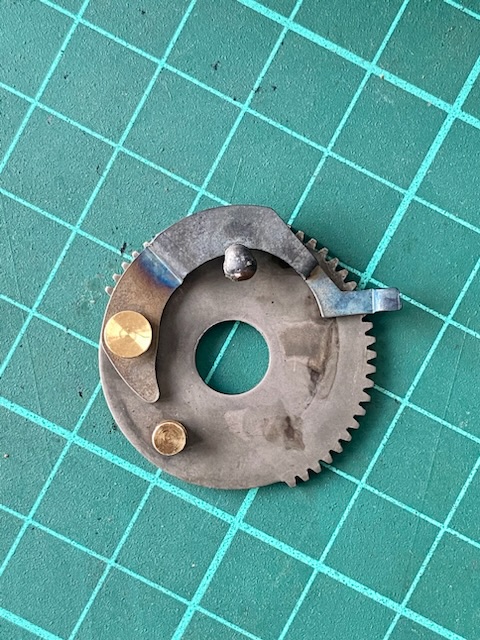

How did you get a blob of steel on that sheared point without melting the entire lever?
Hi Alex,
My welding is not quite as neat as your mans, but seems to be holding ok. See how we go long term
