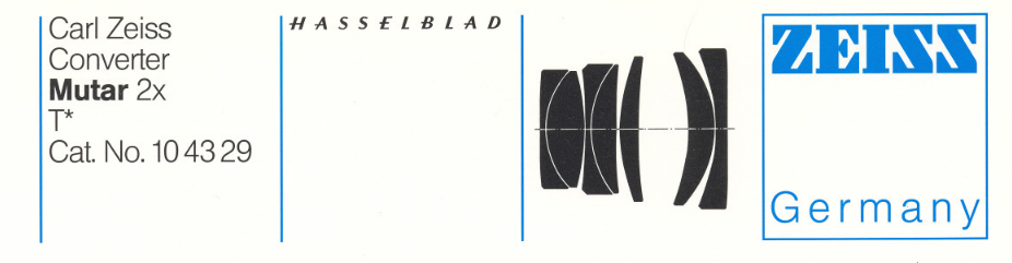

A 7 element teleconverter , I think not ! Peter
However the 2x converter for the Etr models is a 6 element unit.
Now to add to the fun , mention is made of 7 element 2x teleconverters
and I can't find any examples , anyone ?

Many of the better medium format 2x extenders were 6-element.

The latter non-CZ 2XE was also 7 element.
