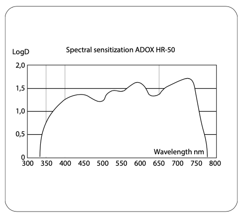

You can see it clearly in the datasheets. First, ADOX says "ADOX HR-50 is based on an emulsion commonly available for technical purposes, featuring an ultrafine grain and superpanchromatical sensitization." Then we can look at the charts.
HR-50 Spectral sensitivity:

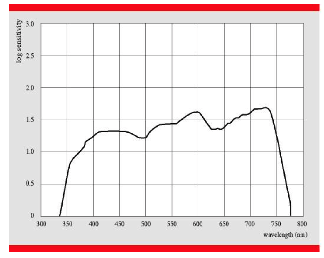

Aviphot Pan 80 spectral sensitivity:
Not quite as perfectly clear as the spectral charts, because of the different developers used and lack of exposure numbers on the ADOX chart, but looks roughly right:

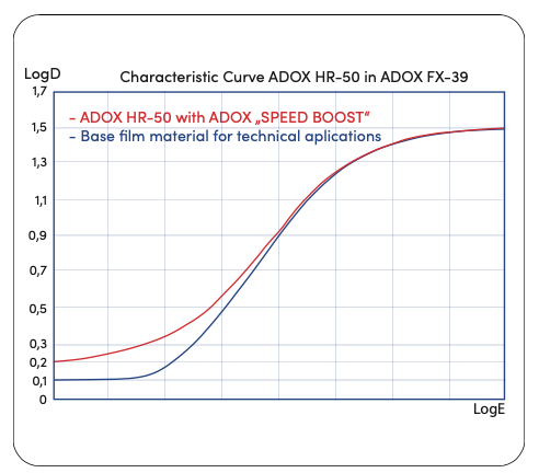

HR-50 characteristic curve vs the basis film characteristic curve in FX-39:

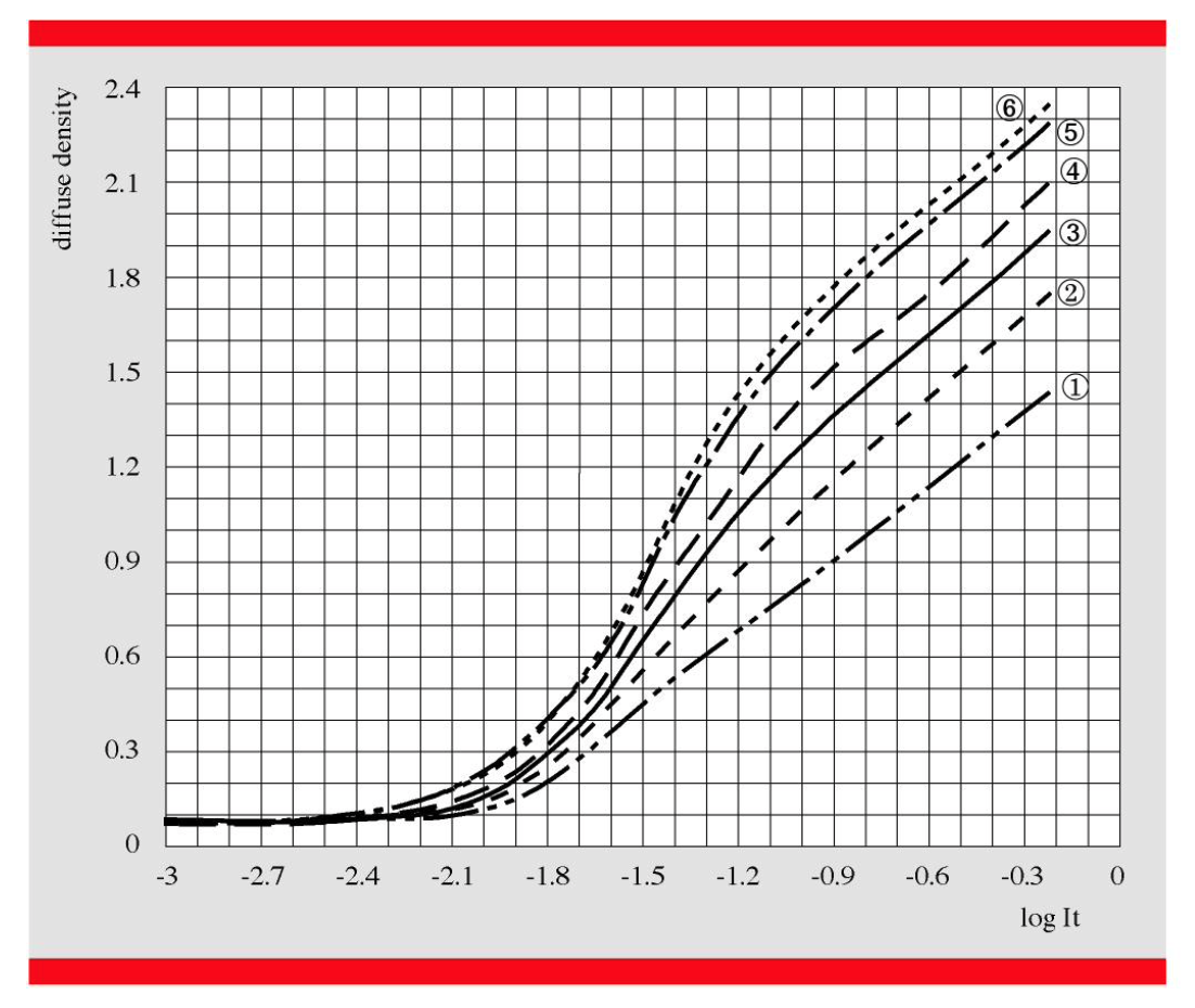

Aviphot Pan 80 characteristic curve in Gevatone 66 developer, specially for this film:
EDIT: You can also Greg Davis' curve for RPX-25 (also Aviphot Pan 80 as mentioned above), in D-76 here:
