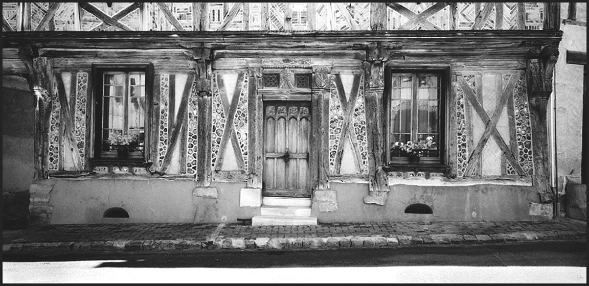

And another...
Same K750 IR film in a Cambo Wide & 75mm Super Angulon...
This time it's a Medieval carved timber house. in St. Julien (Yonne), France
The shady side of the house. Clear sky overhead. About noon.
