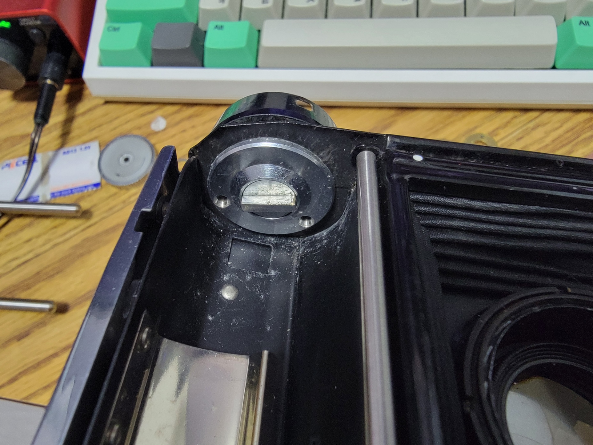

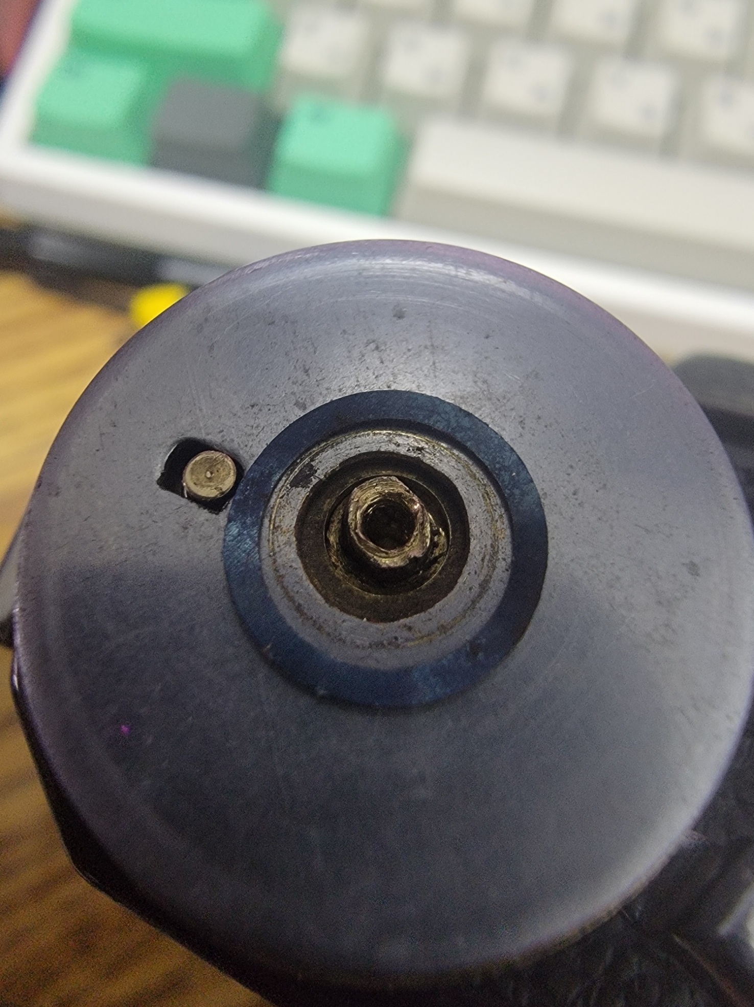

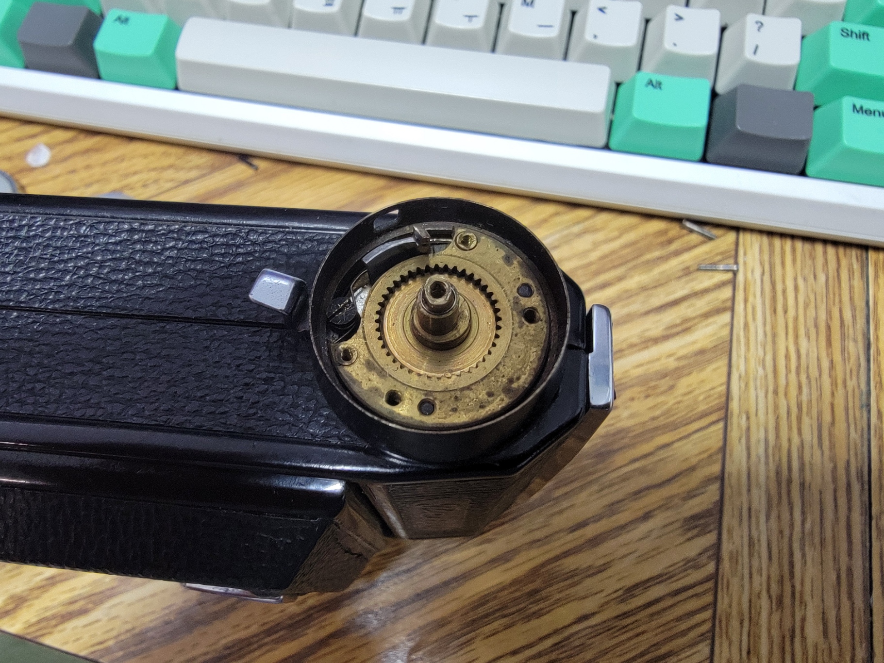

Hello. I've had my pearl iii for quite a few years now. I've only shot a test roll with it and unfortunately the film advance mechanism jammed and since then it's just been sitting on my shelf. Decided to open it up and see what's inside. I have managed to disassemble the film counter mechanism but I am stuck on the advance mechanism. I can't find much resources about it and I'm hoping someone would have an idea what to do next. I've tried removing the 2 screws inside the film intake spool side but that just made the whole assembly spin freely.

Happy to say I did! There were 2 prongs that locks the gear. One is coupled to the advance lever, and another one that I am not sure why exists. There was also a missing gasket based on the photos from the link you shared, which makes me believe the camera has had prior work before I received it.
Now on to the fix. As mentioned, the second prong was preventing the gear from moving. How I understood the mechanism is that when the silver lever is pressed, both prongs should release the gear. Since the second one was not coupled to the lever, it's effectively in a permanently locked state. To solve this, I could find a way to couple it or just remove the second prong and the tension spring holding it altogether. I went with the latter, and now it's working perfectly as intended.

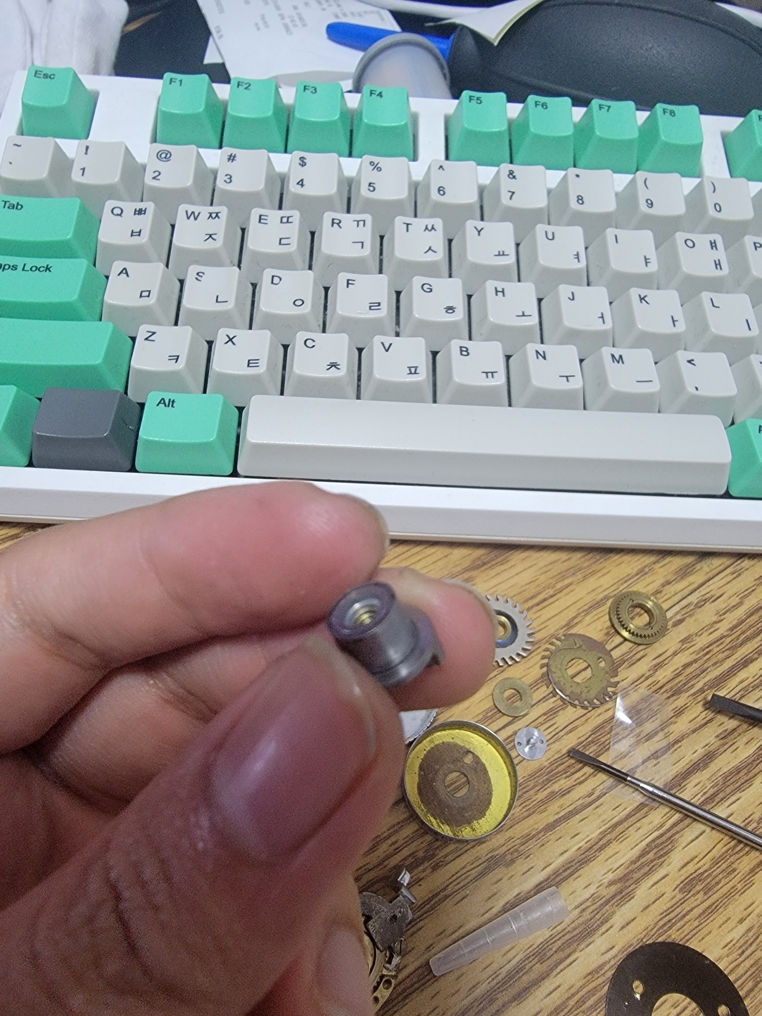

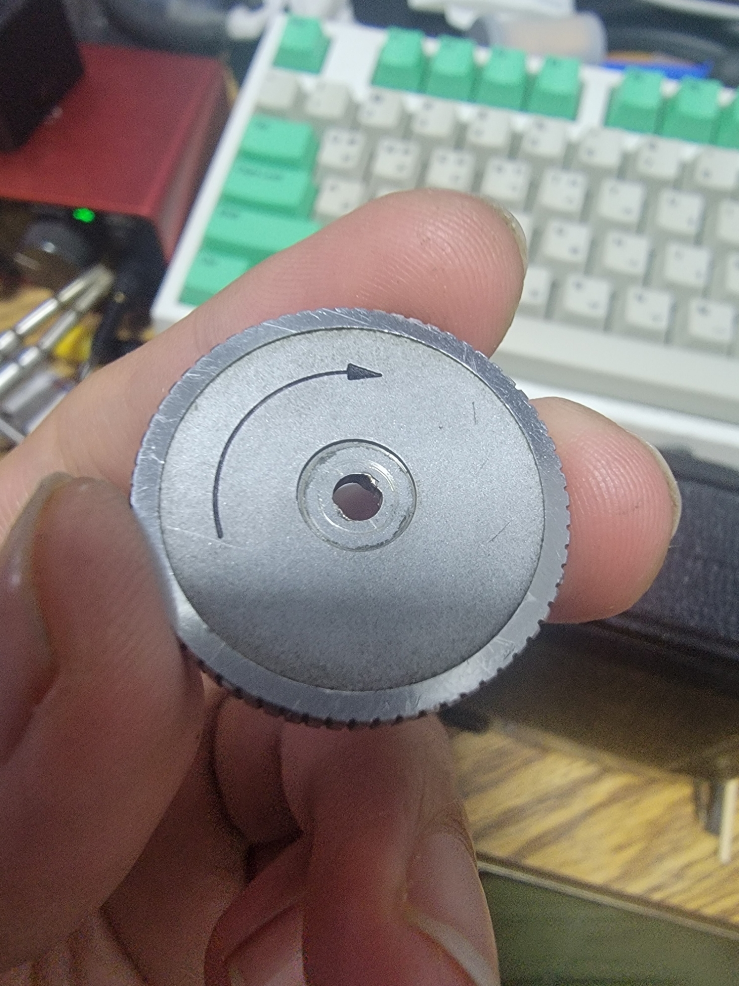

So earlier attempts of operating the advance knob, I stupidly forced it to turn. While it did advance a few more times, giving me hope. It also deformed the hole (first pic), which also deformed the piece where the screw goes (pic 2).
I was able to 3d print a peg to help fix it in place but it doesnt hold well enough to be a permanent fix
