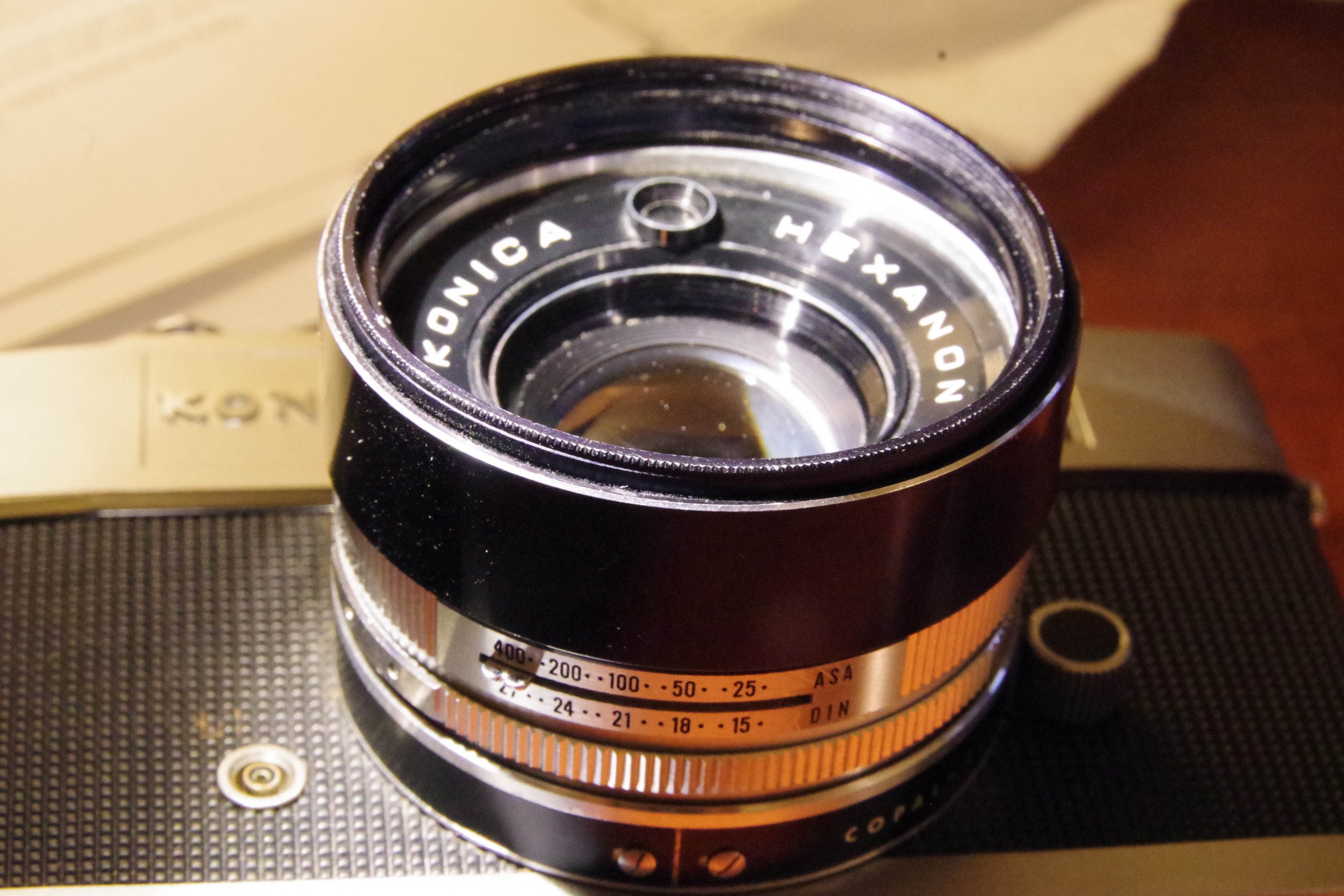

Here is a photo of a Konica Auto S2 with the lens hood off. I am shining a flashlight on the felt inside the hood so that you can see that it's got a slightly raised ridge that holds the hood on by friction. When retracted, the hood sticks out a bit too much to fit a modern lens cap. You can use a 55mm cap, or here I show an empty 55mm filter ring that screws on, allowing a 55mm snap in cap to fit.

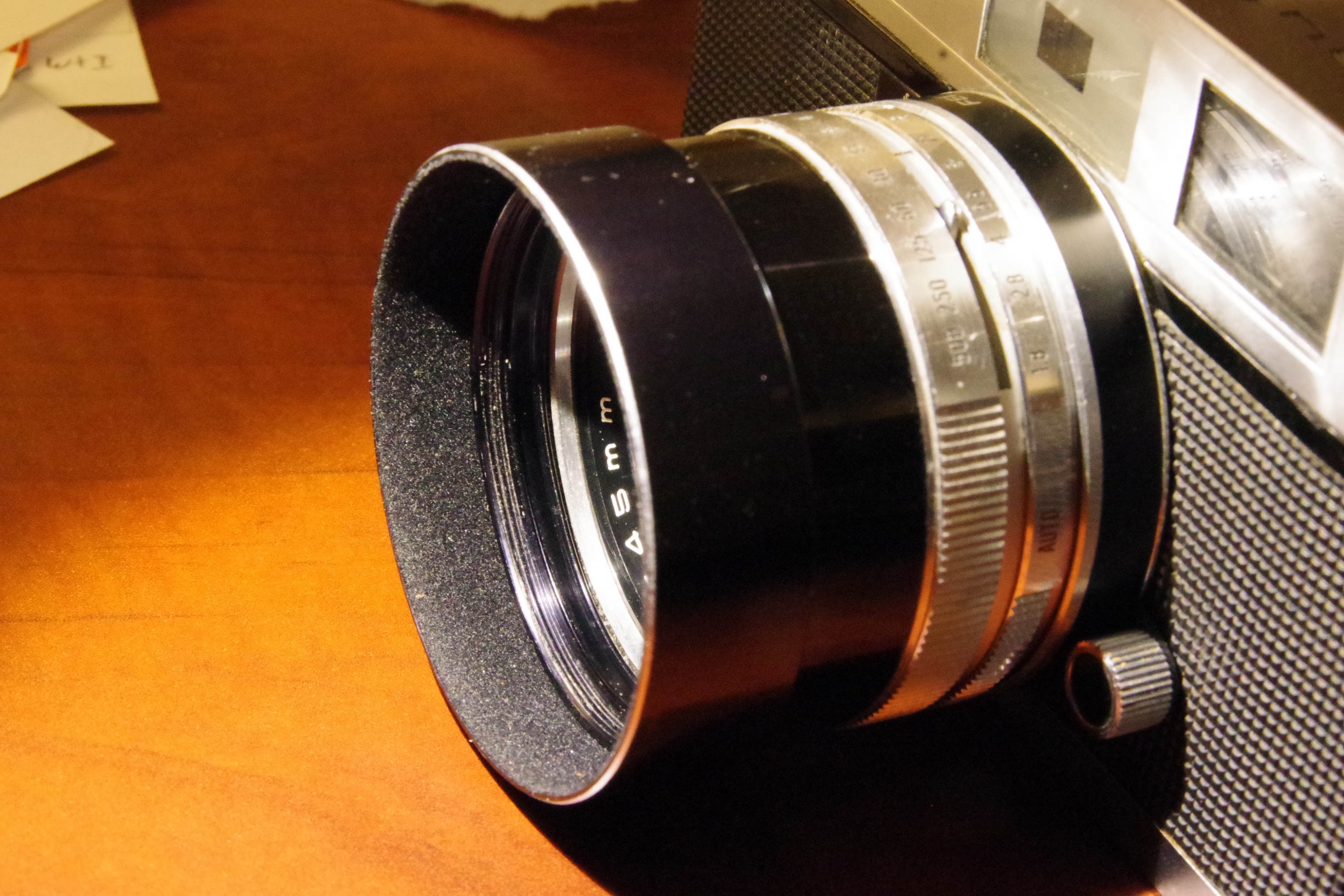

Thanks very much for the helpful comments. Here is what mine looks like. There is a threaded portion at the end of the lens with a slightly knurled edge. I at first thought this was a ring that could be unscrewed, but I can't unscrew it. Of course with this camera's lens I'm nervous about twisting too hard. These pics show the hood fully retracted and also fully extended. I can't pull it off. The hood will rotate freely, but is not loose (I suppose the felt friction holds it well). Is the camera supposed to look like mine? Do you thing I have a ring screwed in there?
It looks to me like someone may have added a step-up ring to your camera.
If so, with so little space to get any purchase on it, it isn't surprising that you are having trouble removing it.
You have a something-else screwed into the original 55mm filter threads. I don't know what it is, but it could be a filter with the glass removed, like the ring I showed in my picture above. If it is slightly fatter than the original lens barrel, that could keep the lens hood from coming off.
With the glass removed, filter rings are a little more flexible and less rigid, which makes them liable to bind when you try to remove them. I would try wrapping a rubber band around it and grabbing a large section of the circumference while you turn. Or you could put the camera lens-down on a grippy surface like a sheet of rubber or silicone (like a placemat or potholder) and try turning it off.
A more destructive method would be to cover the lens surface and then carefully cut slots in the ring to take it off with a spanner. This could cause other problems.

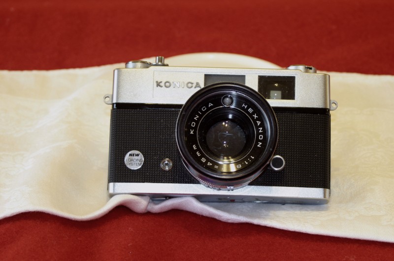

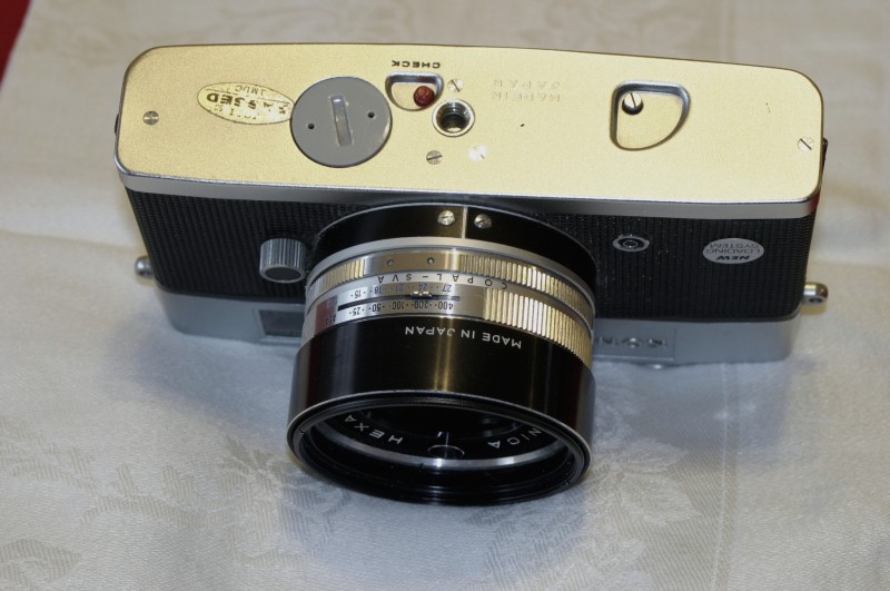

Thanks very much! Could someone post a close up picture of the front threads of the actual lens, so I have a better idea of what it should look like? Thanks!
From a camera I sold in 2012 - I don't know whether the angles will help you:
And yes, I still have stuff on file that sometimes amazes me!

Do you have a close up picture that shows the retaining ring?
That second picture isn't bad - however, the threads look similar to what I have, except you seem to have two notches in the ring that might be good to help removal. I have no notches.
