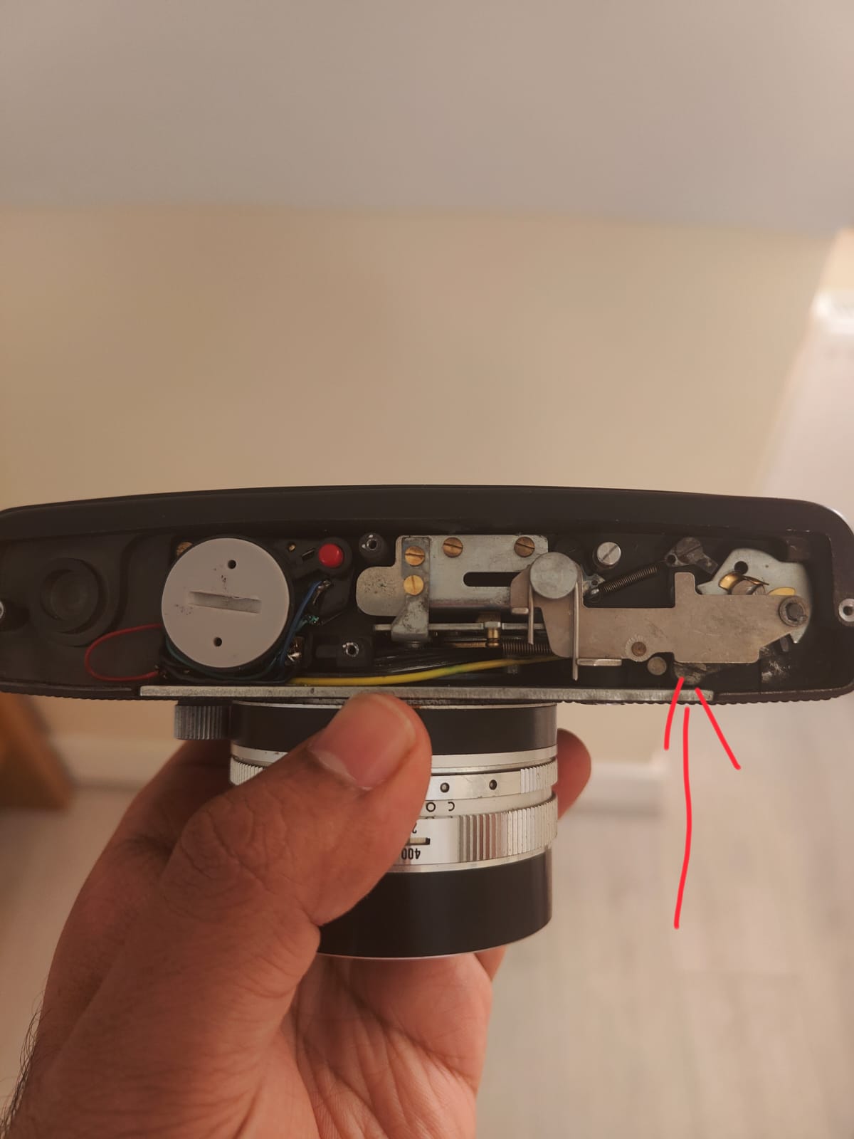

Picked up one recently for the price of a meal and got to know it has the same issue. The advance lever won't wind and the self timer is stuck half way. Since I neither have the money (student) nor the tools , I asked a watch repair guy to remove the base plate and found the marked lever to stop the catchment from rewinding.
I asked someone for a CLA and it's eight times the price of the camera. Except for the hazy VF everything looks solid.
If anyone could advise based on the image and what more could be done on the base instead of the lens element.
