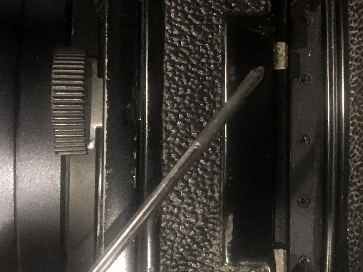

in the darkslide slot there is a small stopper on which you will reach the tip of the knife or the tip of the nail. if you push it you release the lens and you can remove it. Of. Of course you need to keep the film in a dark, remove it in a changing bag for example , then change the lens and attach the film back to a camera after

Dear alexroggero, I checked that pressing this stopper (the right one, where my screwdriver points) the lens lock is released. Hope you will find the dimension to get the slide, because this changing method is complicated.
Petr
Edit: I have learned that the “stopper” is correctly named “safety interlock”. Thank you ic-racer

Oh I see, a safety interlock
If it is like the Hasselblad and you work around the safety interlock to remove the lens, then it may not be safe to change the lens working around the safety lock and you could damage the lens or camera. Spend your effort finding the proper darkslide.
