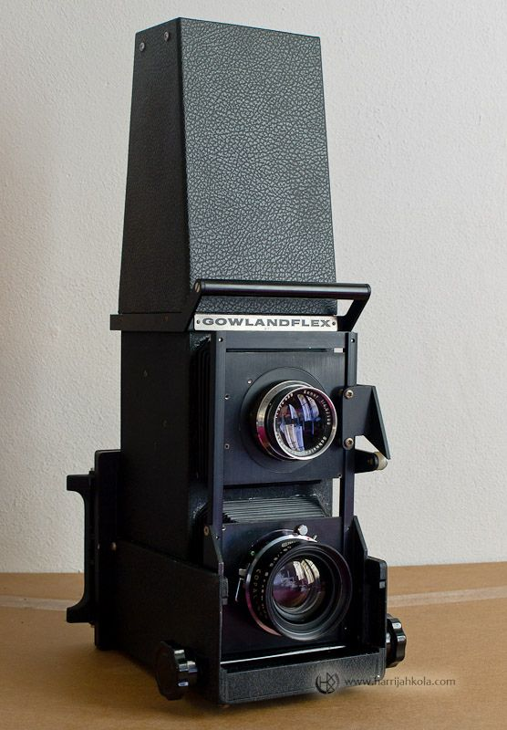

The Air Force used Konica Omega Rapid press cameras. I think the lens for the Omegaflex were same lens for the Rapid, the shutters were different as the Rapid used the ratchet advance. Now for an unusual TLR, the Growerflex is the ticket.

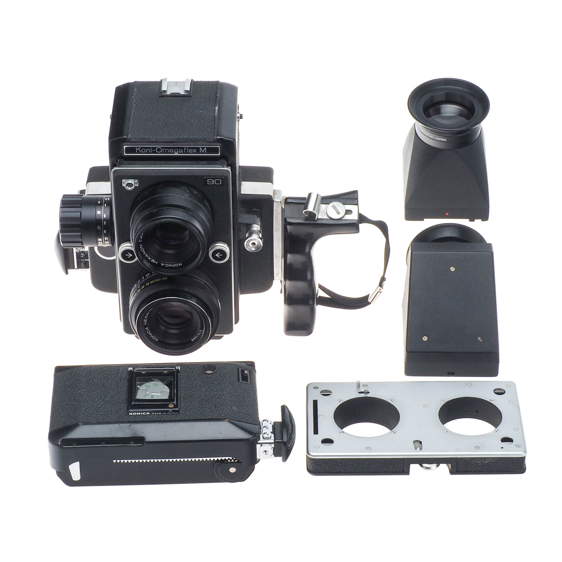

Which lens is included? And which viewer attachment? There are three viewing options: a basic look-ahead viewer (basically a shade on the built-in ground glass), a look-ahead magnifier and a reflex viewer. It should have at least one of them included, as they're not so easy to find on their own. Arguably the reflex viewer is most desirable to have. Having none of them is very undesirable.

I talked to someone and had them check the shutter for me and he says it's slow to close but the more times you fire the shutter the better it gets, so it just seems to be dirty. I just bought it for $299 and I guess the other back not showing is a 120 back. I don't know if this is something I would use enough but I figure if the camera is a dud I will get my money back on ebay and then some.
