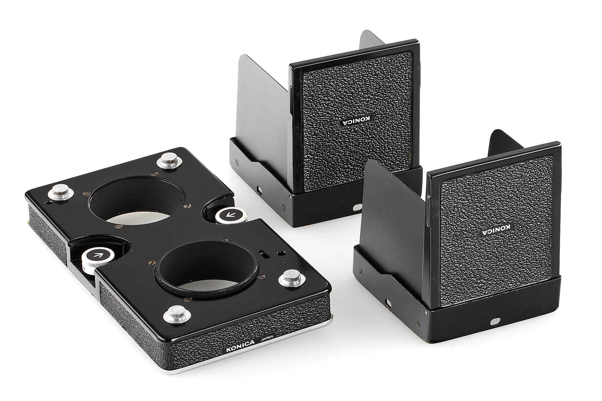

OrientPoint, do you happen to have the close-up kit and willing to sell it?
That 20mm spacer (pictured on the left) is hard to find.
I have an Omegaflex with 135mm lens-set coming in from eBay, and I would love to use it for close-ups.
And the lack of bellows makes me think that the focusing range is quite limited on the 135mm lens?'
If I can't find a 20mm spacer, I wonder if it is possible to 3D print one. The part seems simple enough.

I do have the 20mm spacer. I don't believe they made a specific "close-up kit" for this camera, although there are ones for the Koni Omega Rapid with googles, if memory serves.
With the 135mm, minimum focusing distance on the OmegaFlex is somewhat less than 1m. With the 20mm spacer it's more like 30cm. Not insanely close. With the 58mm lens and spacer minimum focus is maybe 10cm.
I'm not looking to sell my spacer, sorry. I supposed you can 3d print anything, but it looks to me like it might a bit challenging to get it to clip on reliably. The real thing does show up now and then, usually inexpensively. There are no Omegaflex fan clubs out there.
