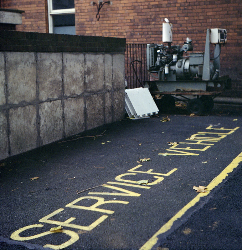

Here's an example, I had focused on that grey bit of machinery, you can see that the actual focal point is way closer to me. This was pretty consistent across the roll.
