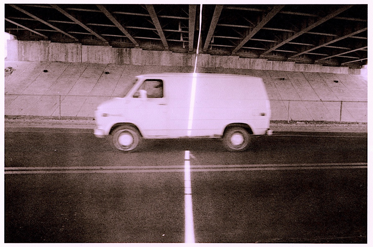

Here is a recent print I did on Fomatone Warmtone Classic. That may be one of the best current papers on the market.

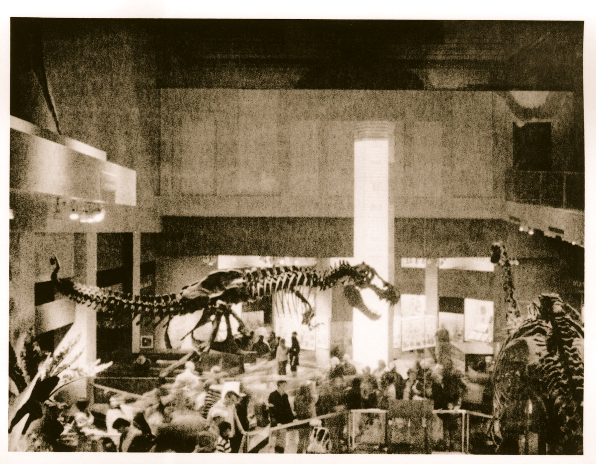

As a comparison is a print done about 15 years ago on Forte which is long gone from the market.
