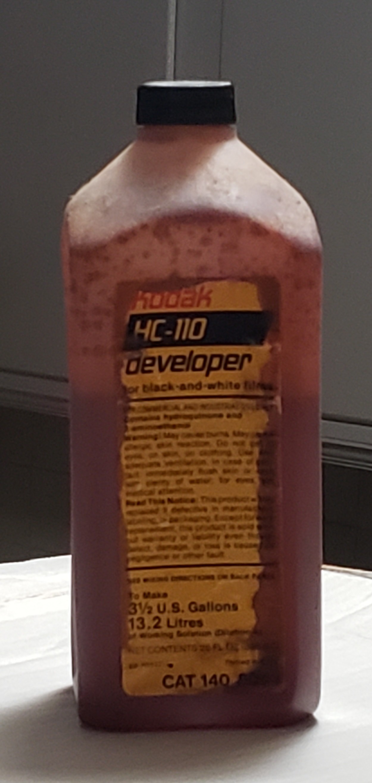

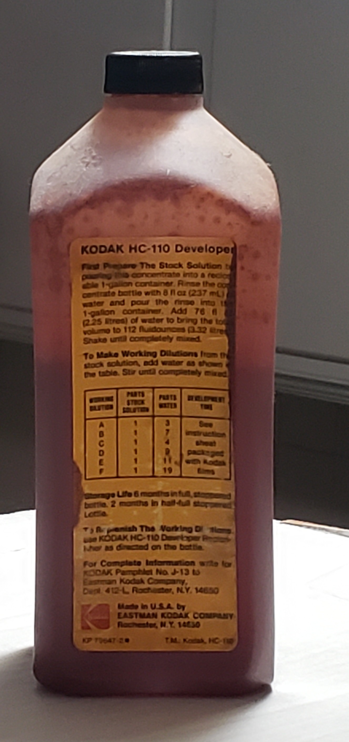

Presented for posterity and nostalgia:
A bottle of HC-110 concentrate acquired new circa 1984.
I used it only for large format deep tank & hanger film processing, for economy.
Unfortunately, I tested it recently...and it is dead. :sad:

The older version containing a sulfur dioxide adduct of an organic was a lot more difficult (and expensive) to make, but that ingredient was most likely what its legendary longevity could be attributed to.
