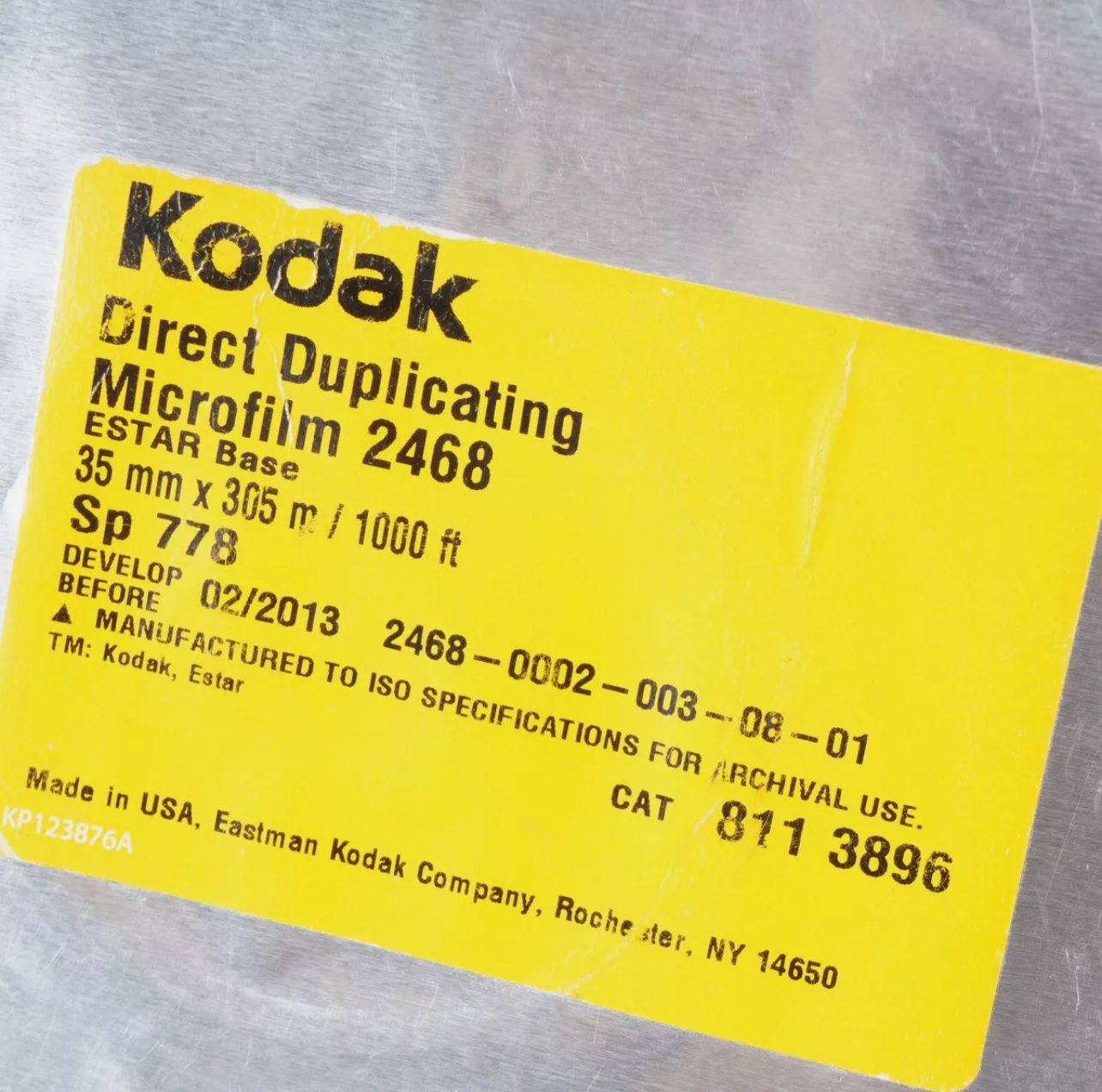

Found a roll online that I’m interested in getting, but I want to know if it’s perforated. If it is, then I’m absolutely going to get it. If not, I’ll have to think on it a bit. However, I have seen that both perforated and unperforated versions seem to exist. So, how can I tell the difference??

Oops, forgot to attach it. Here it is if that helps:

Unless my eyes fail me, that label is for 2468, not 2462 microfilm.
Yes, I made a typo in the title, oops.
And yes, I have seen that PDF, unfortunately that doesn’t help answer my question.

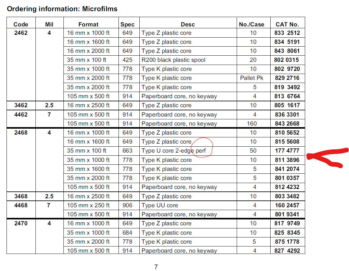

My interpretation of that is that only the 100-ft. rolls (Sp.663) are perforated.
I would agree.
The pictured catalog number doesn't have "perf" as part of the description:

Damn. Might reach out to Svema to see if they can perf it, buuut I think this idea is dead. Oh well…
typically Microfilm is used unperfed. (more image area that way!) {in a past life I must have shot 30,000 feet of the stuff in 16mm.}
