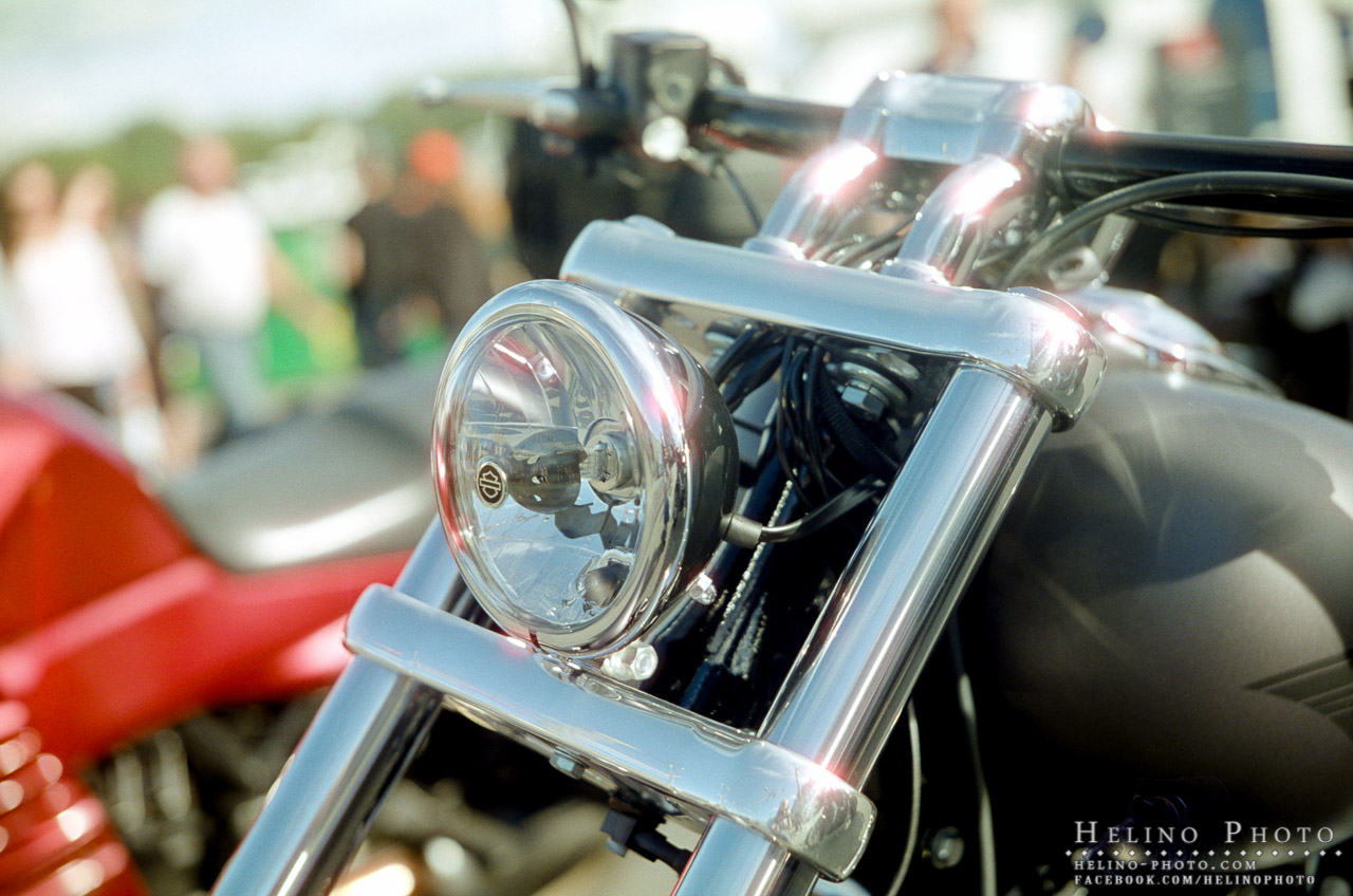

Here are two processed (in c-41) shots where I altered a few things after straight scanning.
(In fear of going off-topic; Basically, I set black and white points, gave it a touch of an 'S' curve and increased the saturation a good notch. )
- It is indeed very natural looking and very very close to what I did see with my own eye.
This does NOT mean that I believe that this is an accurate representation of what the film is actually supposed to look, I get that. As far as color-films go though, it's pretty damn good to use as-is. (imo).
Gives a different look from both Ektar and Portra and it tend, since it's daylight balanced, to yield very accurate colors. (strangely)
1g6syjPTW9BvBb8Z9

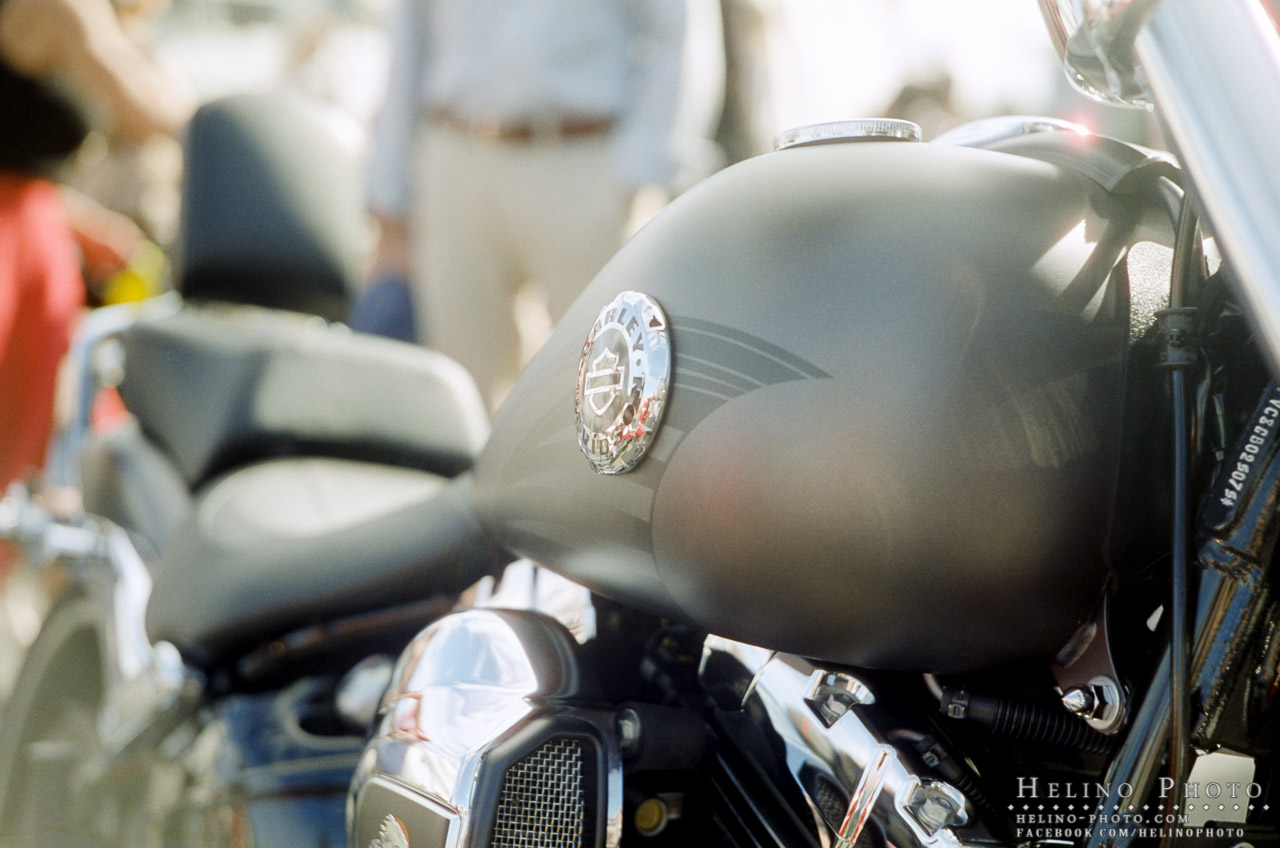

What I did not like,as you can also see on these, was the halo-effect in the highlights from the missing remjet coating on these Cinestill-films. The 50D is a daylight balanced negative film, so I would normally use that on sunny days, so it defeats the purpose if it "haloing-out" like this.
A few more examples, these have not been altered a whole lot regarding saturation, but they have been set a accurate black and white point (IE, initial scan was much lower in contrast):
The final photo explains why I want to get hold of the same film, only with the remjet intact.
The last shot shows how horrible the halo-effect really is (here in Norway, the sun is sharp as a razor until it dips below the horizon, all year, every year.....the few days it's sunny out :tongue: ).
