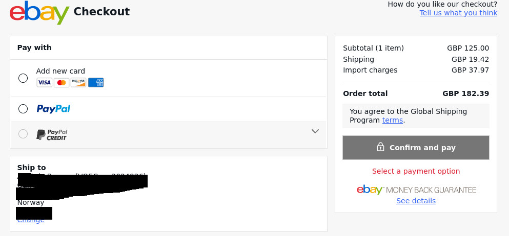

The Ebay listing you linked to, if I go ahead to buy on Ebay i get this: £57,39 of fees for £125 of item price, VAT is computed not on the item price but on the combined value item price+shipping cost. You ask me, norwegian treasury are a bunch of ****, but what can I do?
it would be more expensive if I don't buy on Ebay, because Ebay did register on the norwegian VOEC (Vat on E-commerce) portal, so VAT is collected and reverted to norwegian treasury without additional manual "processing fees" ie. 199NOK or 299NOK depending the amount (in this case it would be 199kr) from norwegian customs, and without a given courrier own "processing fees for customs declaration"... So Ebay is still the best. And in the case of Frame24 listings on Ebay, shipment is cheap, £19.42.
Alternatives are to find some private sale and the seller agreeing to mark the parcel as "gift" (even with declared value, so long it's under 3000kr, no vat added).
