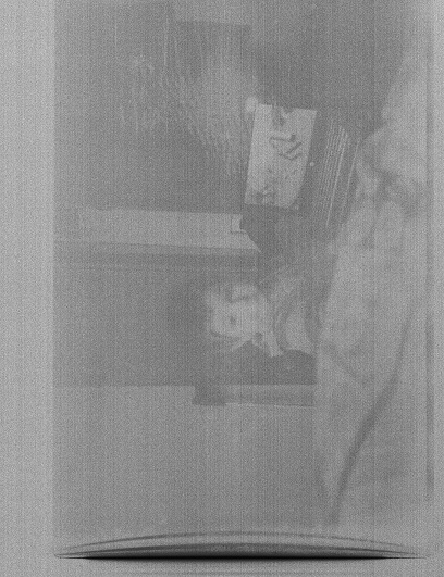

on the scanner, the negative is seen as almost completely white. Shifting the whitepoint in the levels setting all the way down helps a tiny little bit of image to appear.
I think is is properly darkened, not the kind which is scannable as you say. Also, what's with all those vertical lines?
