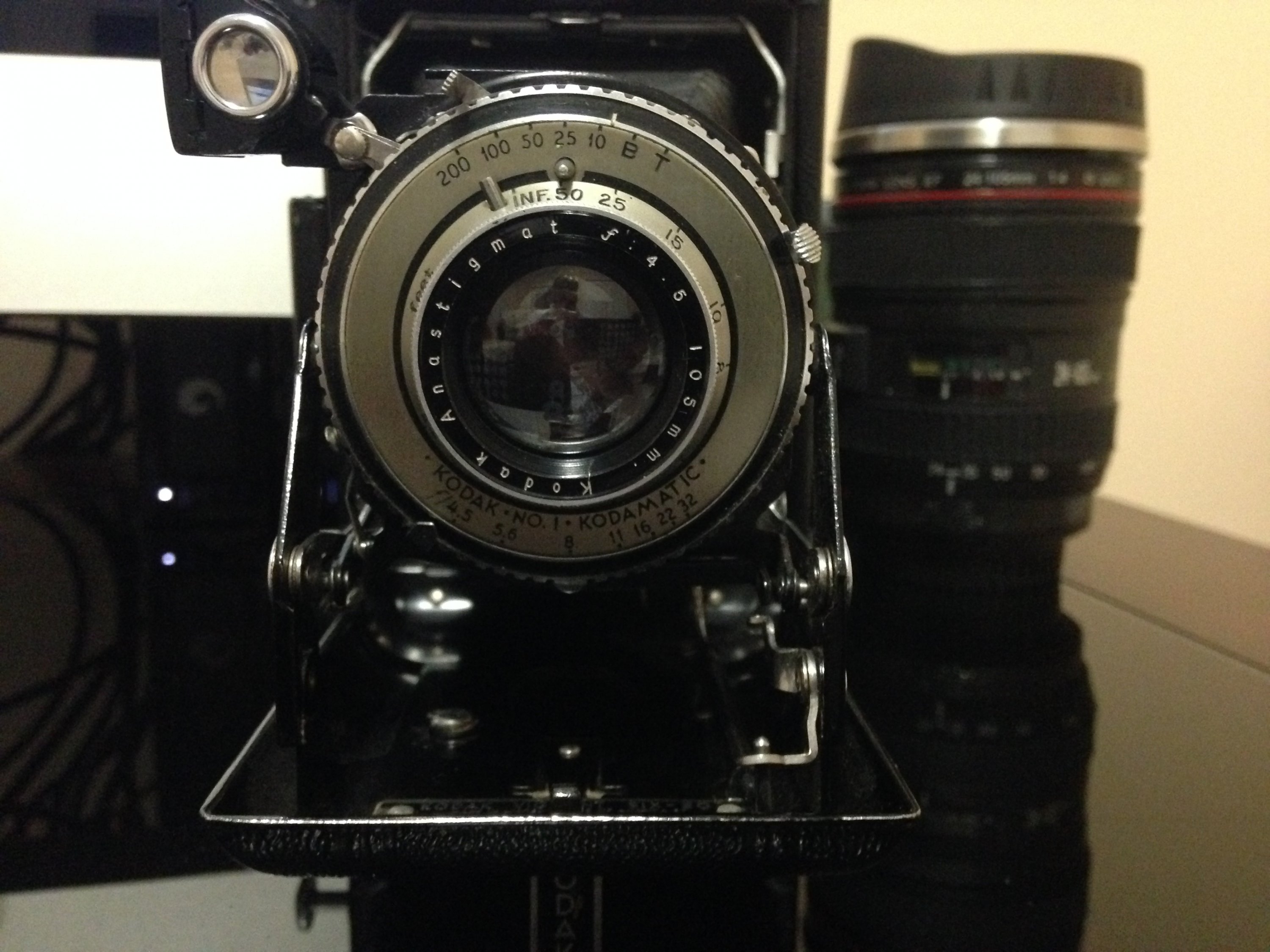

I just bought a Kodak Vigilant Six 20 camera and I was playing with different functions and everything was working fine until I pushed the little tab on the bottom and pushed it to one side. Here is the picture of the tab i am talking about.
www.flickr.com/photos/91509868@N05/25018386875/in/datetaken/
Now I can't cock or fire the shutter. I will appreciate any help.
Thanks

Thanks everyone. Yes the picture is from internet, it is not the original for my camera but it is almost same. On my camera it say Kodak No. 1 Kodamatic. Where can i find flash sync on the camera. Sorry, I am totally new to this.
Regards, Pendu
penduboy
Oct 6, 2013
37

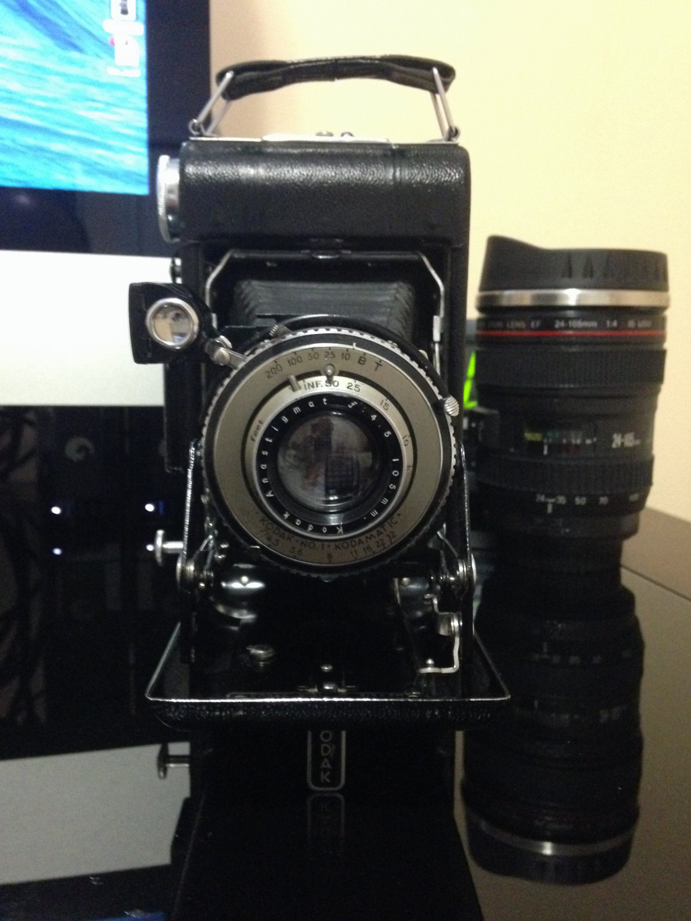

Ok thanks but as i said the picture is not the original picture of my camera. I don't have that option on my camera. But I managed to force back the self-timer tab (phew) and now I am able to cock the shutter but seams like shutter is only firing at maximum speed to 1/200 and bulb mode but in between I don't notice any difference between 1/200 and 1/10 and in-between.
Thank you everyone for great help, I am so happy that I posted this question on this helpful forum.
Pictures of my camera are attached here for reference.
Regards, Pendu

A Kodamatic does not have flash sync. A Flash Kodamatic has F and M flash bulb sync. A Kodamatic X has electronic flash sync only.
A Supermatic does not have flash sync. A Flash Supermatic has F and M flash bulb sync. A Supermatic X has electronic flash sync.
There is no flash sync for your shutter.
The Supermatic series of shutters do not have a self timer, they do have a Press to Focus that presses in toward the lens once the shutter is cocked. Cock the shutter-press and hold the Press to Focus ball-trip the shutter and it locks wide open-recock to release the Press to Focus.
Sounds like your shutter needs a CLA.
