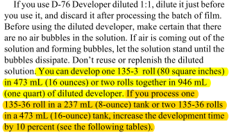

Generally agree with D-76 1+1. But keep in mind the info of the Kodak Datasheet (attached). Sure, one can argue that you will calibrate your own times. But, a 135-36 film and a 120 film have (roughly) the same area, yet one will require (according to Kodak) an extension of 10%, and the other not, with the usual developer volumes.
The reason for the wording in the data-sheet is that it is impossible to fit two 120 reels in a 16 ounce tank, whereas it is possible to fit two 35mm reels in a 16 ounce tank. If you put two 120 rolls on to a single reel (which I do fairly frequently) use the same time extension with 120 as with 35mm.
