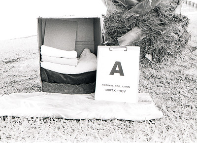

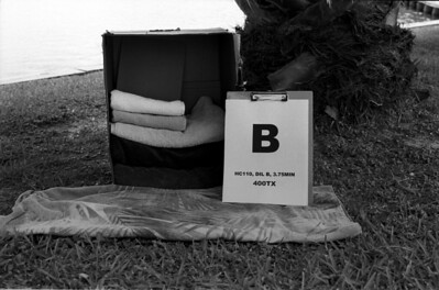

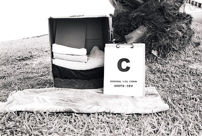

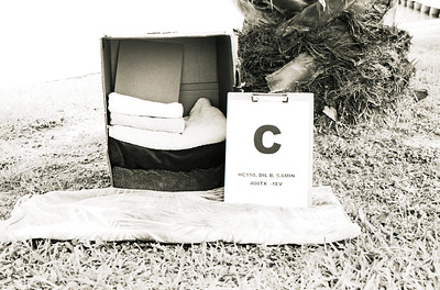

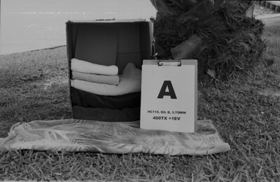

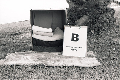

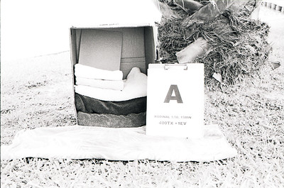

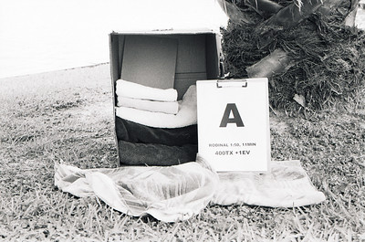

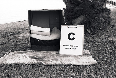

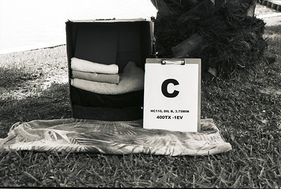

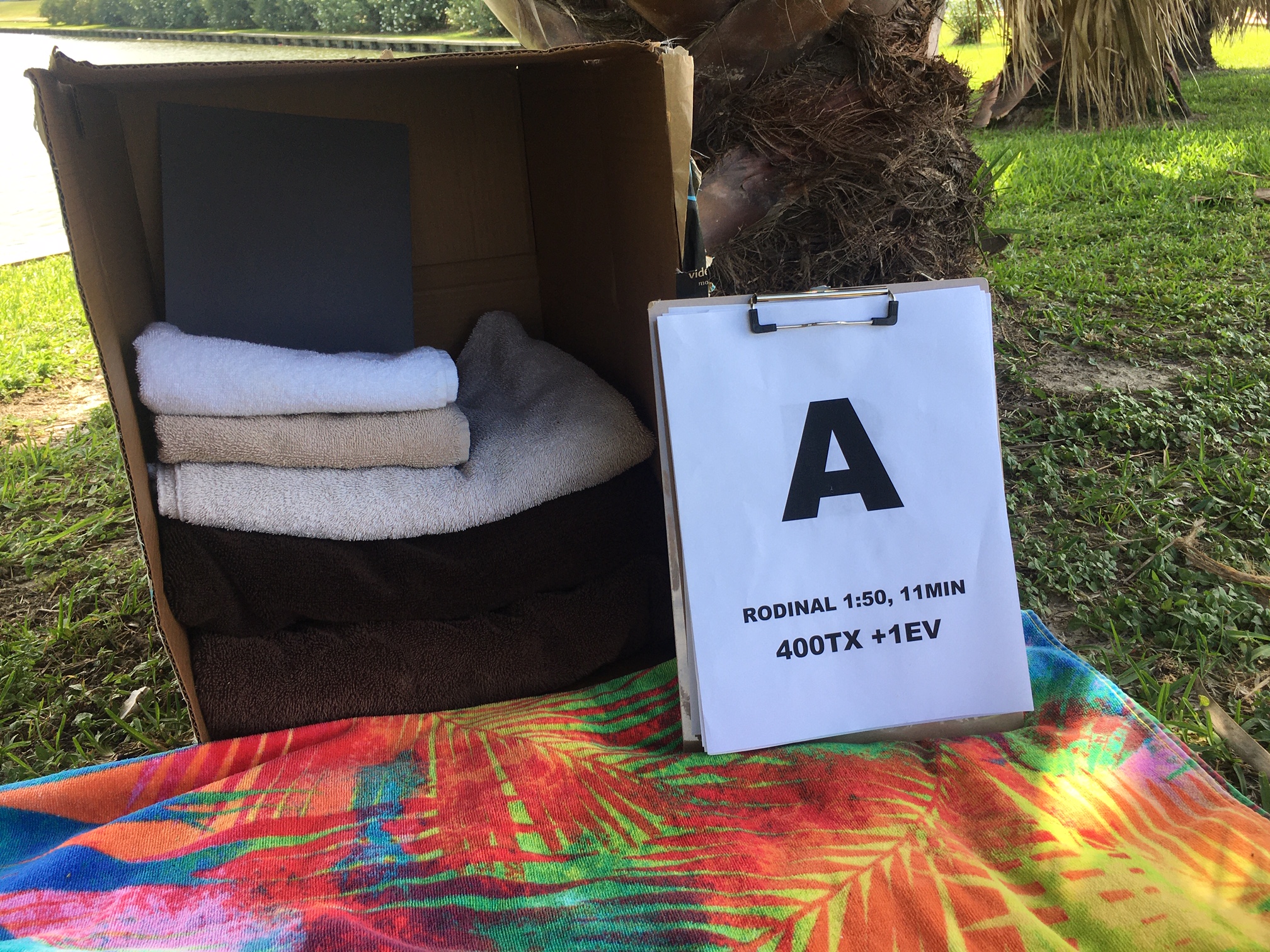

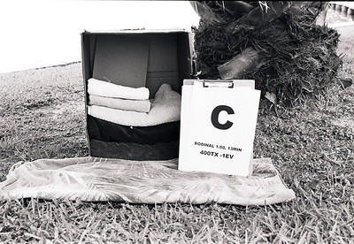

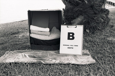

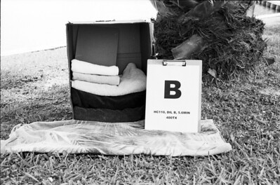

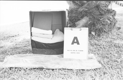

If you've been following my "Tri-X in Rodinal Failure" thread, these are the results.
Camera: Nikon F5
Lens: Nikon 50mm 1.8 G
Aperture Priority Mode
F/8
Center weighted TTL metering
Focus point was fixed on the left edge of the clipboard for all photos
Tripod
Rodinal Development: 1:50 dilution
1st Roll - 68 degrees, 11 minutes, agitation first 30 seconds, 5 inversions at the beginning of each subsequent minute.
2nd Roll - 68 degrees, 13 minutes, same agitation schedule
3rd Roll - 68 degrees, 15 minutes, same agitation schedule
HC110 Development: Dilution "B" 1:31
1st Roll - 68 degrees, 3 minutes 45 seconds per Kodaks instructions, same agitation as above
2nd Roll - 68 degrees, 5 minutes 36 seconds, same agitation schedule (5.6 minutes was obtained by averaging Kodaks 3.75 minute suggestion, and the unofficial dilution "H" suggestion of double dilution "B" times.
Scanning:
Epson 4990 with 35mm film strip holder
All auto functions turned off
Only adjustment was to black point and white point in histogram
I have shooting notes, and development notes for each roll written down that can be scanned if need be.d
The entire album can be viewed here. https://flic.kr/s/aHsmNjJP2n
R11+1EV by Christopher Coy, on Flickr. R11BoxSpeed by Christopher Coy, on Flickr R11-1EV by Christopher Coy, on Flickr
R13+1EV by Christopher Coy, on Flickr R13BoxSpeed by Christopher Coy, on Flickr R13-1EV by Christopher Coy, on Flickr
R15+1EV by Christopher Coy, on Flickr
R15BoxSpeed by Christopher Coy, on Flickr R15-1EV by Christopher Coy, on Flickr
HC375+1EV by Christopher Coy, on Flickr HC375BoxSpeed by Christopher Coy, on Flickr HC375-1EV by Christopher Coy, on Flickr
HC536+1EV by Christopher Coy, on Flickr HC536BoxSpeed by Christopher Coy, on Flickr HC536-1EV by Christopher Coy, on Flickr

There’s a gray card on top.
:D Christopher, although you haven’t asked... I’d be very happy with the Tri-X @ box & Rodinal 1:50 for 11minutes. Thanks for showing your work.
Good work Christopher. The ones at Kodak's official time in dil B look underdeveloped. That is what most folks expect, as it is undoubtedly a Kodak snafu. I would go with 6 mins for dilution B as a starting point. I hate part minutes less than .5 of a minute and tend to round up or down. Makes the maths easier too.
Two things worry me about your tests, the first is that that bright area on the top left which will be affect metering, and the second is changing light HC375BoxSpeed then the sun is out on the grass in HC375BoxSpeed. I think that's having too great an effect to really make the tests precise enough but it's getting you closer to the ballpark.
Ian
...I think the idea of texture (fluffy towels) your test target is a good idea, but they are unevenly lit because of the 'box'. Your target area is also much darker than it's background - there's a lot of veiling flare in your set up. It would be better using a really dark background - preferably in a studio where you can control the light. I think with really rigorous technique, people are more likely to spend time reading your article.
Surprisingly, you're not the first person to choose that one. In my initial conversations with @MattKing he also chose that exposure/development combo.
Ian
The light changed only minimally. If I remember my notes correctly, that roll only changed from 1/80th of a second to 1/60th of a second. I have exposure notes. Additionally, everything was shot with center weighted metering. But its a moot point,because HC110 at 3.75 minutes is underdeveloped anyway.
Well, the scene was set up based on what I typically shoot. Since I don't normally shoot with studio strobes, this was a more accurate portrayal of what would end up on my negatives. Additionally, I really wasn't doing this experiment for anyone other than myself, so if someone doesn't feel the need to read the notes and look at the pictures, there are plenty of other threads that they can view. Or better, they can perform their own experiment.
The towels and the grey card is a good idea but I always thought from reading about testing in respect of finding your own personal film speed that open shade in a North facing location was the best area to take the pictures then develop at the maker's recommended time. Examine the negs. One should have the correct level of shadow detail i.e a dark textured cloth/towel still shows some texture. That one is the right speed. Then look at the highlights in the "right speed negative. If these are white with no discernible texture as in say a white towel then lower the development time. If the white towel looks grey rather than white increase your dev time.
David Allen amongst others here wrote a good and comprehensive test procedure. Worth researching it
pentaxuser
.... that open shade in a North facing location was the best area to take the pictures then develop at the maker's recommended time.
That's funny, because the box IS actually facing north, maybe a little NE, and I shot it under the shade between palm trees.
I think box speed in Rodinal at 11 minutes gives the best detail in both the shadows and the highlights. The upper left corner of each image is water so I consider that an "extreme" since the specular highlights are overly exaggerated.
