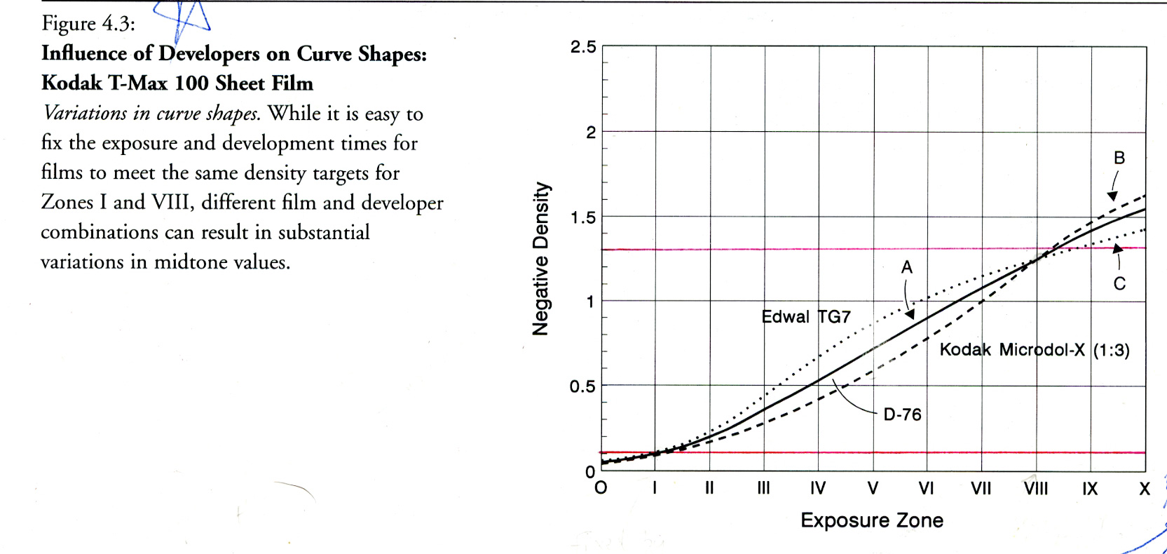

Also, are shadows an issue with Tri X/HC110 Dilution B at EI400?
Shadows are an issue anytime you don't expose for them adequately, regardless of the film/dev combination. In the abscense of any established testing regime, if you are consistently getting unsatisfactory shadows at 400, then bump the EI down a bit, see what happens, you may have to reduce development some to keep highlights controlled.
With that said, a shadow value in the toe region of an upswept curve will have a lower density than at the same location with very straightline curve----the straightline curve even lower than a more concave curve as seen with TG7----compare the density values in the toe at Zone III, for example, and even on up the rest of the scale to the "normal" development calibration density at VIII to VIII 1/2. The curves show how different gray scales would be produced with each curve.

Sounds like a myth to me. #76 produces more of a sag in the curve than HC-110, which is capable of a
perfectly straight line in films engineered with that characteristic.
Drew - I use HC110 Dil. B at 68F with Tmax100 and can't get away from a sag in the mid range of the curve. What do you have to do to get the curve to run straight?
Gord

CPorter,
You've got HC-110 curves, as I recall... they DO have a bit of an up-sweep.

I believe this up-swept curve would be beneficial to portraiture, where the customer's facial tones need the best separation...
But it would drive Ansel Adams nuts trying to hold highlights in check - thus leading him to conclude the diffusion enlarger is the only way to go...
Bill Burk
Feb 9, 2010
9,290
Yes, I think it would give you more details and information in the area where the viewer is looking. My curves in D-76 tend to be relatively straight-line until above 1.2 density, so the effect is "above Zone VII" for me. In my case, I tend to have my high-density step wedge values towards the outside of the film, where agitation effects provide more development action. So I ignore it.
