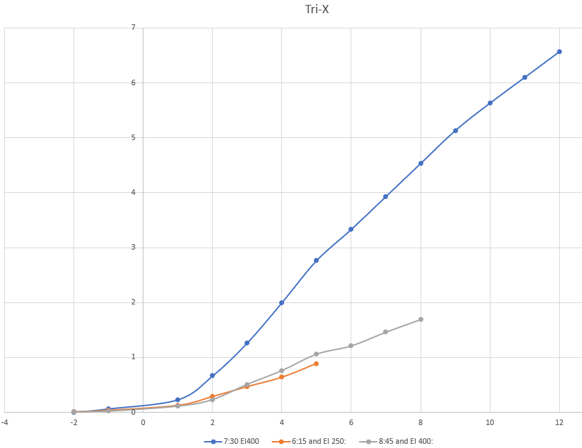

Kodak Tri-X 400TX H+D Curve with Replenished XTOL for 7:30 at 24C in a JOBO - A development time resource for replenished XTOL and Tri-X 400TX
For reference, and if anybody wants to discuss.
I've made these exposures as carefully as I could and eliminated as many variables as I realistically could. While it is not scientific, and certainly not up to ISO or probably manufacturer standards, it is as accurate as I can make it with what I have available to me, and certainly accurate enough that I thought it would be share-worthy.
Each of the curve points is a correctly exposed 18 percent grey card in full stop increments using a...

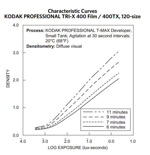

Not intriguing... it's just the behaviour shown in the TX400 datasheet. Nice to see a practical test matches the datasheet. That datasheet has not the Xtol plot, but it has the D-76 and the T-Max developer ones
This is the T-max one, also straight line at 1 lux·second (H Log = 0.0 in the graph) and beyond, which is 6 stops overexposure, with T-Max developer showing some speed advantage, 1/3 stop approx. higher than with xtol, as it could be predicted:
The D-76 plot is a bit more shouldered because that developer is semi-compensating type.

I plotted all in same and converted densities to stops and lux seconds to zones for example:
Adrian I think you have typo in EI 250 row "0.400" - I think it should be 0.04 ?

the chart I posted already shows stops and zones. Each dot is a different full stop of exposure. You can simply replace lux seconds with relative EV with zone 5 being 0 EV, everything to the right is plus, everything to the left, minus. Keep the density on the vertical axis as that is the optical transmission of the developed film for each point. Showing it as exposure stops isn’t useful.

Adrian: btw why the other measurements (orange + gray) are so much different to the blue one? And why did you measure just the toe?
different times and/or exposure indexes. I was measuring the toe because that’s how you determine film speed, and I was determining the best exposure index and development time to use. I included the measurements in the post for reference in case anybody wanted to use them as a starting point for something else. As I said before, doing this costs time and money, and I can’t please everybody.
Of course but why such radical difference, that is quite interesting. And developing longer seems to lower the density? That cannot be correct? I have probably understood something incorrectly.
Where are you seeing less density with longer development? The 8:45 time has more density than the 7:30 time. A lot more. You’re probably not converting to stops correctly.
I have made mistake, yes. I looked at your data and it has more density for sure. Sorry about that!
