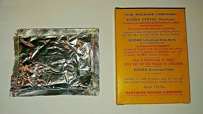

There's a Tri-Chem Pack I want to buy just for the fixer, since I'm currently out. The foil pack that says "Universal Fixer" is a dark green where the chemical is. Does anyone know if that means it's cooked, or possibly still OK? I buy old packs and tins of Dektol and D76 all the time, but this is the first time I've run into the Tri-Chem Pack.

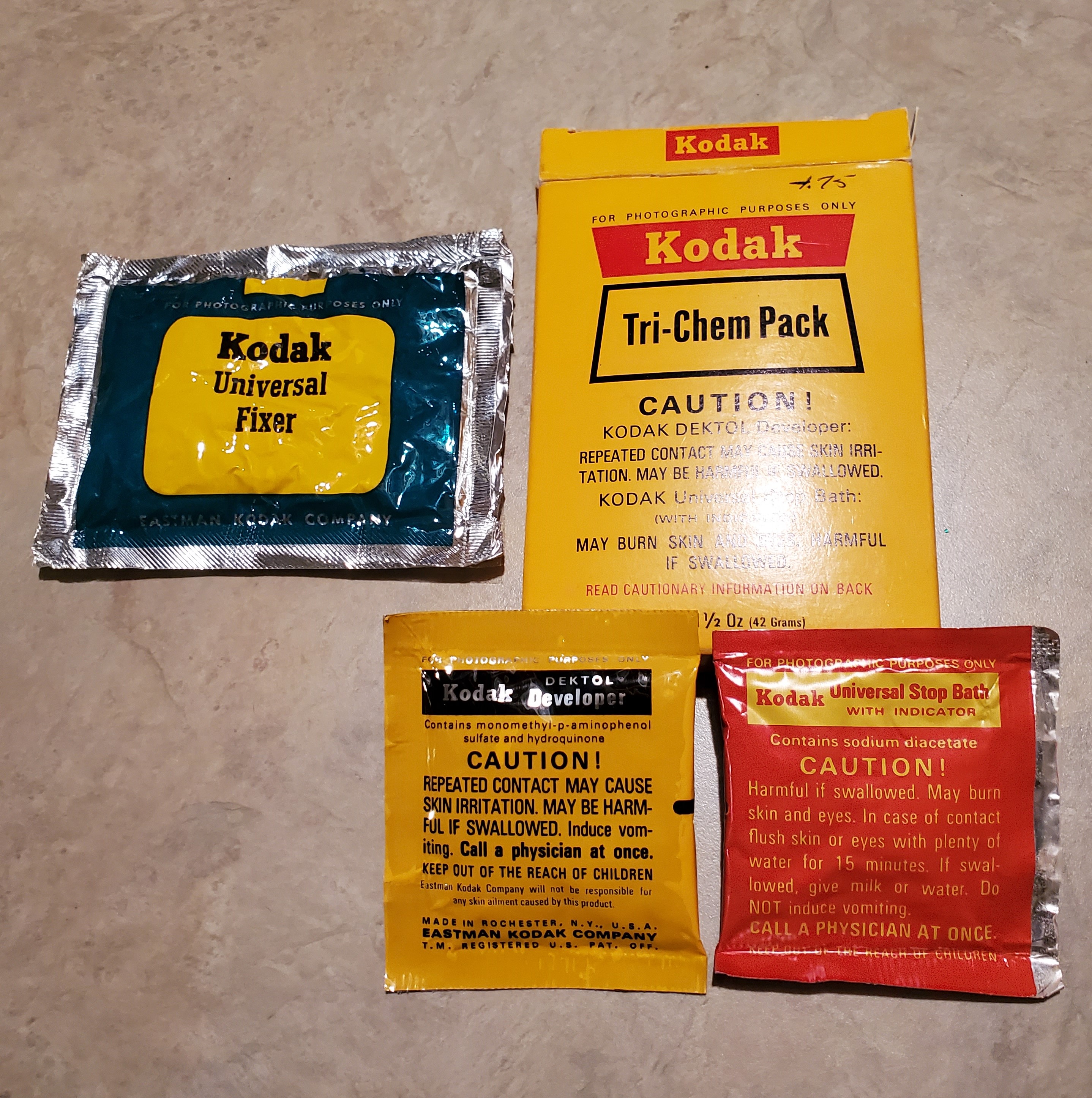

My experience with Tri-chem packs is from a slightly later era, but in that case the foil packs were color coded for identification.
Part A of the developer was in a yellow foil packet, part B of the developer was in a blue foil packet and the Universal fixer was in a green foil packet. I would assume your earlier example is color coded the same way, and that packet is dyed that color specifically, not discolored.
These packets don’t keep great after many decades though, I would expect the powder inside to be solidified and may be hard to dissolve. They may be good for experimentation, but not for reliable results. The cans are much better in that regard.
This is a Tri-Chem Pack from the mid 1960s. The package of Universal Fixer shows no color on the back just the silver colouring of the packet. The packet has a stiffness to it so I suspect the contents are passed their best before date.
Thanks for the help, I better pony up for some new chemicals. The D76/Dektol packages and cans from the olden days may still be good even after we're all gone, but sadly, not this stuff.

The yellow package in the picture above identifies the developer as Dektol - useable for both film and contact prints
