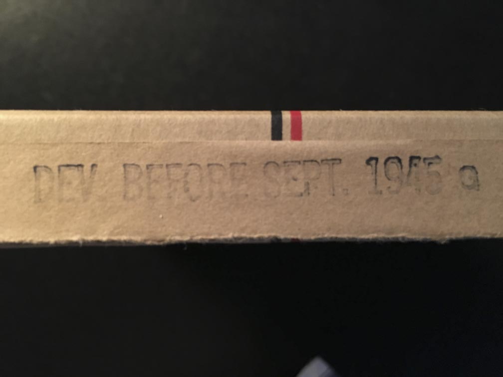

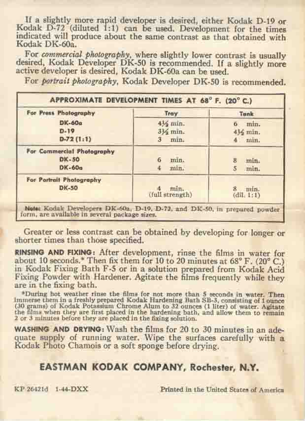

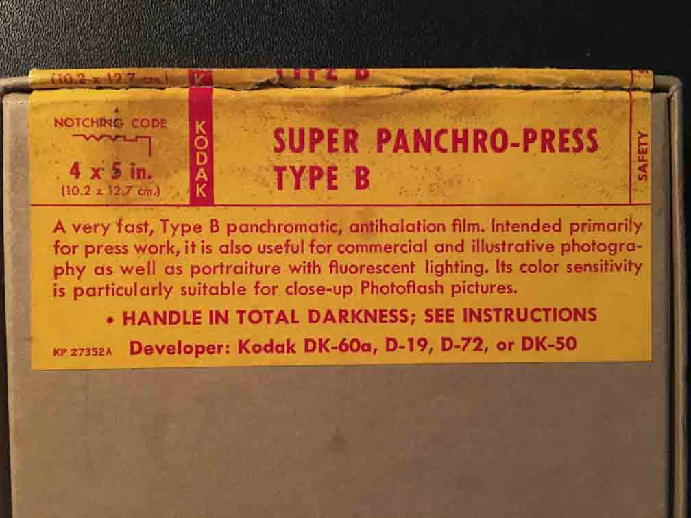

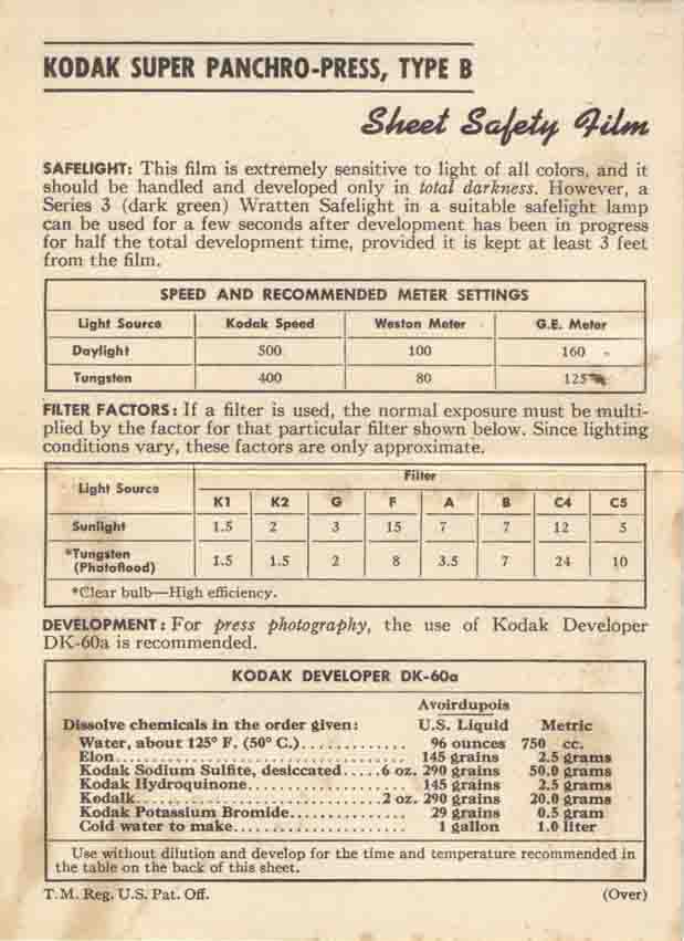

I've loaded up some 4x5 sheets of this to shoot tomorrow, and just glanced at the data sheet that was in the box. Even though the film expired in 1945, it's claiming a daylight speed of 500. For a 1940's emulsion, that seems awfully high to me. Can it be true?
I believe this is before ASA/ISO was standardised. If I recall reading something somewhere correctly, Weston speed 100 is roughly ASA 125.
I believe that Weston 100 was equivalent to ASA 125.
Ah, okay... that makes much more sense. Thanks, folks.
If my memory is still working, Weston was usually (always) 80% of ASA. The GE meters were closer to ASA though not the same. SPP type B was the standard film used by most Newspaper photogs and professional studios around here when it was made and it was usually rated at what was later ASA125......Regards!

Most of the users around here preferred to develop SPPtype B in DK-50. Wish we could buy that film fresh again......Regards!
I found this film in two references, Pocket Photo Guide and the Weston 100 equates to ASA 125. In a 1956 Kodak Films data guide... it gives ASA 125.
You'd think of it as ASA 250 now if you had the same emulsion in a fresh film.
But you'll probably have to shoot it as EI 50 due to fog.
