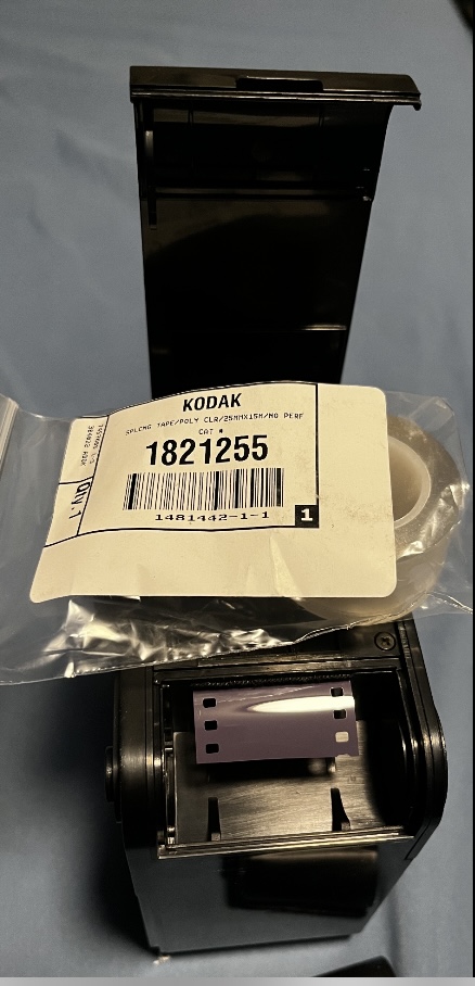

So I have been having issues with using regular office tape for bulk loading cassettes. At the end of the rolls “more often than not” the film would just rip out of the tape.
A friend who works with cine film told me to get Kodak splicing tape.
I purchased some and I am really happy with how tin it is and how strong it holds the film. Highly recommended.

the Splicing tape is used to join Polyester film, and generaly used in a splicer that also Punches new perforations. the Old splicing method of using Film Cement does not work for splicing Polyester. I imagine it will work for Bulk loading.

The splicing tape is good for the folks that attach their new bulk load to the stub film sticking out of a cassette (not my practice, I use reloadable cassettes, including Kodak Snap Caps). These folks are usually making do so that they can use the DX feature on their camera. I keep a roll of mini-lab splicing tape around for this and other uses.
