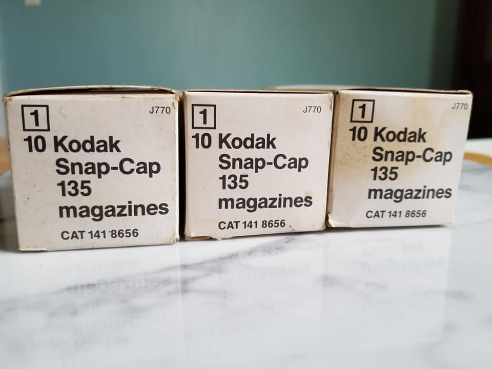

I love Kodak Snap-Caps. All I used in the early 1990's. Could walk into B&H and pick up a box of ten, cheap. Must have had fifty of them at one time. Wish I had known they were going to disappear, would have held onto them. Found a box of ten in 2011 and snatched it up, and found 11 loose ones that I also bought. Haven't opened the box of ten yet, but the other 11 are always loaded with Tri-X or Double-XX. As others have mentioned, an easy way to put the cap back on is start at the felt opening, get the cap securely attached there, then run your thumb around the outer edge until you hear it Snap into place, ergo the name Snap-Cap.

The old Kodak Snap-Cap cartridges for reloading bulk film were no big deal at the time. Until the early 1960s, Kodak and others sold their retail film in such snap top cartridges. Note that both ends were snap-on, and the base end was NOT crimped. Whether you reloaded them or not, you opened them (in the dark) by slapping the cartridge end with the spool end protruding down on a counter and the other end popped off. You reloaded it by snapping the end back onto the cartridge, pinching the cartridge body at the felt trap and starting the cap on at that point. I have at least three dozen of them in a box in my basement right now. When Kodak started staking on the cartridge ends, they continued to make the old cartridges because the staked cartridges were destroyed in the film removal process - same old cartridge. (Frankly, the old Agfa cartridges were made with better material and tolerances, and made much better reloads). Today, the plastic cartridges with screw-on ends seem much more convenient and likely to last longer.
