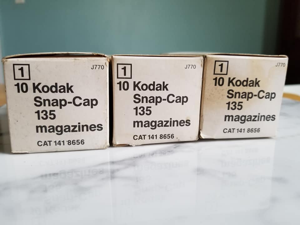

Any advice on using snapping the cap back on? Fortunately, when the Alden loader arrived it had almost a full roll of mystery film that had been exposed to light and was worthless as useable film but great to use for practice my loading skills. I found a box of NOS Kodak Snap Caps and thought I give them a try. I've tried squeezing the cassette a bit to aid in replacing the cap and that works occasionally. I've also tried leveraging the cap on starting at the felt opening. I've had some success with that but most of the time I have a cap that is mostly on and would allow light to leak in. I have a bag of plastic ones as a backup and know they will work when I start loading.

Just to clarify, it’s the entire cartridge with one end that snaps in place to secure the spool and make the cassette light tight.

I always hated the Kodak Snap Cap cartridge, (these are 1960s-70s reloadable metal cassettes sold by EKCo) I got rid of most everything several years ago, now I kinda wish I would have kept the nice plastic cassettes. I still have Snap Caps :smile:

And the other end cap was crimped on?
Yes, one end is crimped and the other snaps in place. I have found by starting the cap where the opening is, then pressing down while squeezing the cassette, the cap will snap into place. I’ll keep working at it and try to get to the point the cap snaps in every time.

What he said. I've had good luck with Kodak snap caps.

I leave a tab of film sticking out and tape to it. The snap isn’t very snappy.

I bought some of the Kodak cassettes. They are much nicer than the Kalt metal reloadble casettes, but I wouldn't call them thick walled. You do have to be careful not to bend the corners. I attach the caps by squeezing the felt trap shut, then pressing on the cap starting at the point 180 degrees from the felt trap, then sliding my finger around in a circular motion until it pops on. Overall the plastic ones are easiest to recap because it just screws on a quarter turn. In fact the only thing I don't like about the plastic casettes is the felt is is not on very well (these are the current new plastic caps on the market.) I find I have to carefully apply pressure to the felt to get it to stick in place.

Thanks for the suggestion. Once I stopped squeezing the cassette too hard, the cap snaps on securely.
