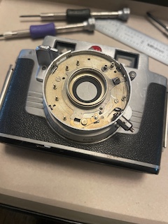

Does the entire element unscrew from the front or the retaining ring inside needs to be removed first? I'm stuck either way.

If you are asking about removing the shutter from the camera body, then you will need a lens spanner to unscrew the retaining ring from the inside of the camera. However, the earlier models of the Signet 35 have a retaining ring that is often impossible to remove. Either it has been torqued on very tightly or LocTite (or similar) has been used to glue it in place. I have had several of the early versions and could not remove the shutter ring no matter what I tried.
What is the serial number on the front lens group? Signets with a serial number starting with RC, RA or RM are the earlier versions, and those will have a retaining ring that you won't likely be able to remove. Signets with a serial number of RE, RR, or RO will have the retaining ring that is far easier to unscrew.
If you cannot remove the shutter from the camera body, then you won't be able to do any more work on the shutter than you have already. If you have cleaned and lubricated the components accessible from the front (as you've pictured) then you have done the important work and the shutter should perform well.
Thanks for the response.
Yes, The spanner attempt did nothing. I assumed glue must be in there. The lens is RC16576(L). I'm quite new to this and was resolved that I've gone as far as I can. I was hoping to remove more parts for cleaning but will stop here and do what I can. I don't want to break anything.
In my experience you don't have to remove the shutter housing from the focusing helical in order to service it. If you get as far as the photo in post #6, you can go ahead and remove the mechanism plate from the shutter housing by removing its fastening screws and lifting it out. The one catch you will find is that the cocking lever and its ring are in the way. I believe originally Kodak would have punched out the knob on the cocking lever, removed the lever and then lifted out the mechanism plate.
I've found you can leave the cocking lever in place and slide the mechanism plate out from underneath it if you tip up the cocking lever so that its ring can clear. It's slightly more annoying, but not impossible.
Thanks. I would like to clean the shutter and aperture parts, but maybe another day. I did remove the two screws from the plate and held the ring out of the way, but the plate would not budge. I assumed there may glue here as well as at the rear retaining ring. Being new, I'm in no rush. I may try again but don't want to force anything without being sure of what is usual for these mechanisms.
Edit ...I gently tried again with your advice. It's out! It may not need it but I mostly just want the experience.
