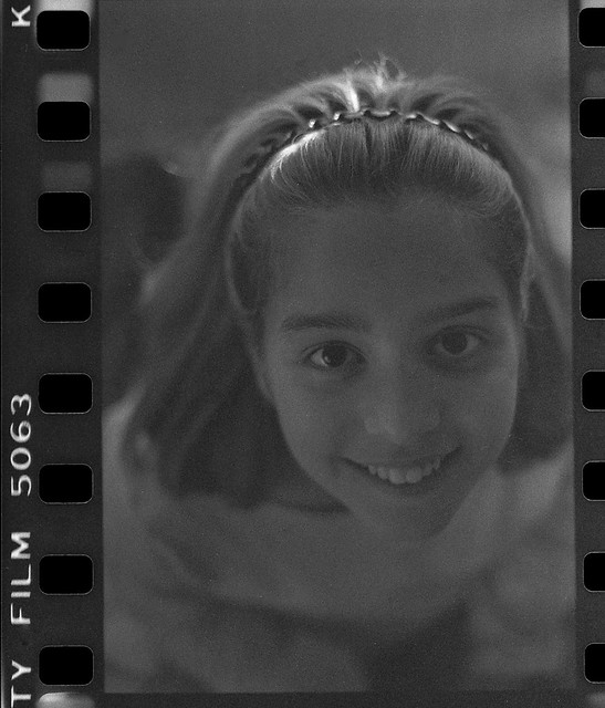

I purchased a Lloyd bulk film loader in USA. It came with a roll inside. I didn't know wich film it was but I had a clue ... there was a fact-sheet of Tri-X Pan inside the box.
So I shot ten photos at ISO 400 and developed the roll with rodinal 1+100
It is Kodak Safety film 5063 aka KODAK TRI-X Pan Film.
I've found this table in the web:
http://www.taphilo.com/Photo/kodakfilmnumxref.shtml
And this one in the web "archive":
https://web.archive.org/web/20150919064145/http://www.kodak.com/global/en/service/faqs/faq0034.shtml
It seems that there are more than 30 meters left ... it weights more or less the same than the loader I have with 30meter of HP5+
I shot some pics and developed the roll with rodinal 1+100:
1.
2.
3.
What do you think?
Should I give it a second chance with a more agressive soup?
Best regards
Antonio

Try shooting it at ISO 50 or 100.
I found a similar roll on a used bulk loader and had fun figuring it out. I optimized my process right as the roll ran out.

I have bought an alden 74 with the same stuff inside. Mine has to be at EI 25 for good shadow detail. I use HC-110, it gives me surprisingly low fog, though the grain is huge.

5063 is old emulsion Tri-X, your negatives are flat but not really underexposed, try developing a test for 25% more time, and bracket exposures to find an EI you can live with.

Judging by the difference between the perforations and the film-base it seems to be under-developed and probably under exposed (there are highlights, but that could come from electronic post-processing and a contrast 'balance'). If you have a picture of the negs, without reversal or further processing, then it would be handy.

I really belive they are flat and underexposed. I think I'll shoot at 100 and develope at 400 with HC-110, what do you think?

I think it is underdeveloped and underexposed, right. I'll try to do some pics of the negs !!

I too had similar experience recently. I ended up using semi-stand HC110 1:100.
Still a lot of fog so I shoot it at 50 or 100, but it's definitely worth shooting.
