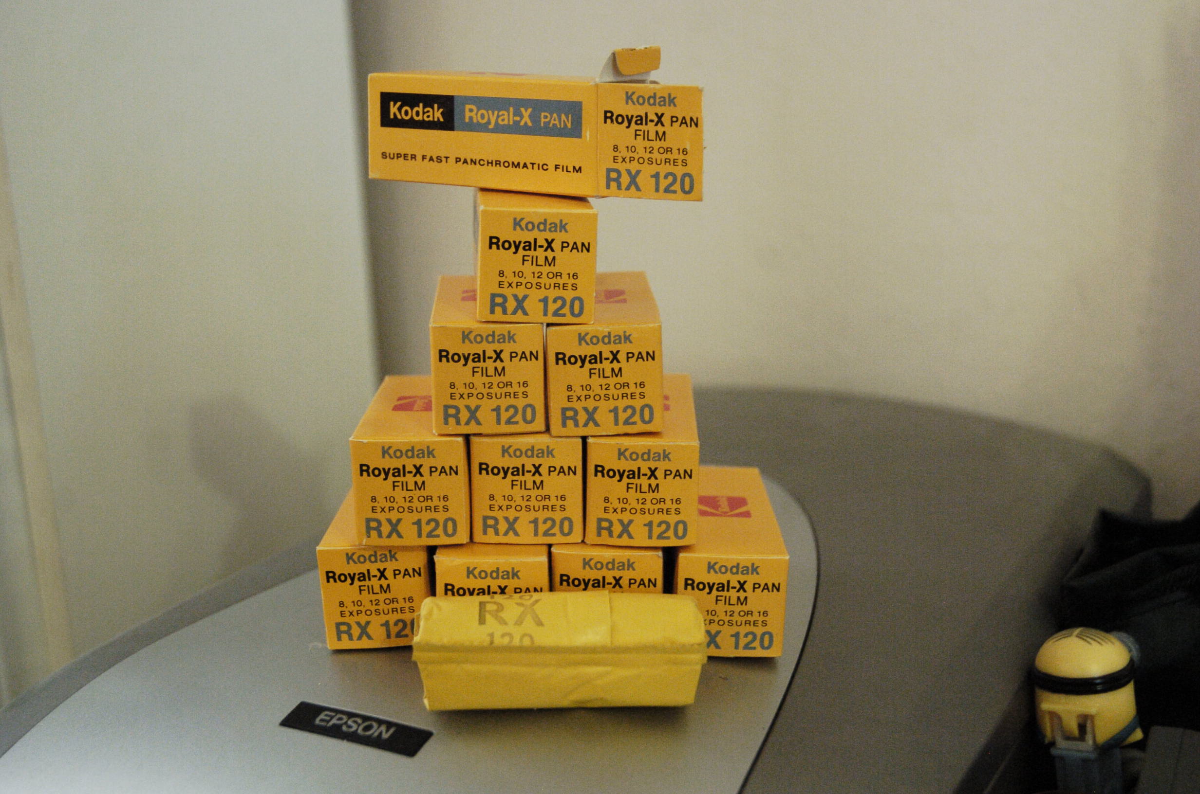

I shot a couple of those "recording films". And I have a roll of Royal-X 120 in the fridge. As I recall the recording films lacked antihalation backings and were on Estar base for high speed cameras and dried very curled. I shot a bit of 2475 and 2484 for the golf ball sized grain on figure studies and night shots. Others shot it at night time sporting events.

Expiration date on this batch in 1981.
Wow! Nice stash! Go shoot some and let see what it looks like. I would consider doing this in DK-50 1;1 at least once.
