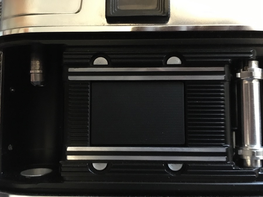

I just bought a Retina Reflex III locally for pretty cheap. Cosmetically it is in great condition, but has some functional issues I expect may need to be fixed. Not sure if I will try to get that done. There is one thing that has me puzzled, and I don't know what to make of it. When I open the back like I'm going to load film, the entire film gate ares is covered by a metal blockoff plate (see attachment). I don't know what moves this plate into place, and what moves it out of place. Its not something that the user is supposed to remove because it is on the wrong side for that. I assume it is a "shutter open for focusing" block off plate to protect the film from exposure, but I don't see it move at all when I advance film or trigger the release.
Also, has anyone dealt with a jammed shutter on one of these? I can see the tips of the shutter blades, and they don't seem to close.
I suspect both of these issues are connected.
That's called a capping shutter. Check the edges of the back opening for a lever/pin that depresses when the back is closed. Press it in fully to trick the camera into operating as though the back is closed.
The shutter is a #00 Synchro Compur . https://learncamerarepair.com/downloads/pdf/Compur-Factory-Shutter-Repair-Manual.pdf
This manual only covers the basic shutter, not the adapted version used in the camera, only has engineers drawings, special instructions, and a lubrication diagram. It assumes you know how to service shutters.
When the shutter blades do not close fully the shutter requires a CLA.
That "plate" that blocks the film gate is the backside of the mirror. The mirror does not return to the rest position automatically - you have to wind the film to the next frame and that moves the mirror back to its rest position. If that mirror assembly remains blocking the film gate after you've cocked the shutter, then something is seriously wrong and the camera needs servicing/repair. Only Chris Sherlock will service the Reflex models. I wouldn't recommend attempting it yourself - by the time you get to reassembling things like the meter cord drum, you're likely in way over your head.
