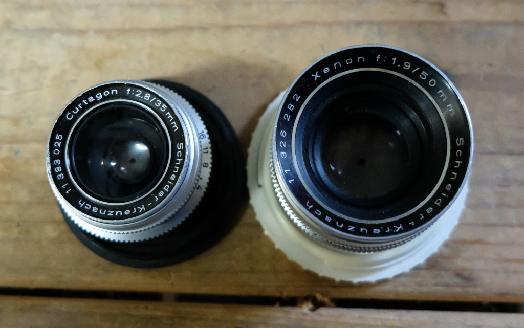

I see there are some Kodak Retina experts here. I came across a couple of DTL mount lenses; both Schneider Kreuznach- but neither marked "Retina". I have the 50mm Xenon f1.9. It looks like the standard Retina version of this lens screws apart so the front optics can be replaced to create an 80mm and 100 mm lens. I can find no explicit reference to a non-Retina version of this. I do find a link with a photograph with the same markings as mine, but no explanation. (http://lensbubbles.com/my-favourite-lenses-series-schneider-kreuznach-xenon-50mm-f1-9-dkl/)
Mine has the same markings as the one on the right. I.e. it is a "Xenon" not a "Retina-Xenon".
Anyone know the story behind this? Mine does not seem to easily part.
The other lens is a Schneider-Kreuznach Curtagon 35mm f2.8 (not marked "Retina" either).

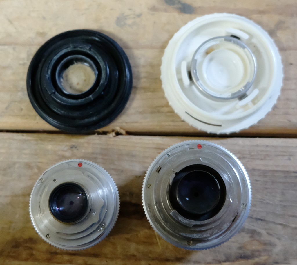

I have the Retina-Xenon 50mm 1.9 and it definitely doesn't screw apart to take multiple elements from other lenses. As far as I know, no DKL mount lenses did that, and even then it was a bayonet mount, only the lenses for some of the folding and non-folding bodies took the interchangeable front elements. Good luck on solving the mystery of the lens. The DKL mount is not mutually compatible across the different brands of camera, there were minor variations of slots on the tabs on the mount. It would be best if you'd post a picture of the mount side of your lens. I'm sure the knowledgeable people could better help you with that information. My first inclination is to say it's a Voigtlander lens, because those didn't usually have the camera prefix, but I don't know if Schneider even made DKL mount lenses for those cameras.

So maybe the "Retina-Xenon" and "Xenon" are more or less the same. Maybe the "Retina-Xenon" has the rangefinder coupling built-in while the :"Xenon" does not. As I said, I have the "Xenon" and it appears to be a DKL mount. The picture I showed in the OP shows the differences from a front view, but not rear, but ostensibly, both are DKL mount lenses. I will get some pictures an upload them.
In this picture later in the same thread, you see the "Retina-Xenon" has a rangefinder coupling mechanism (the long slot). Mine does not have that. (use link- photo will not show; the third photo in the linked post)

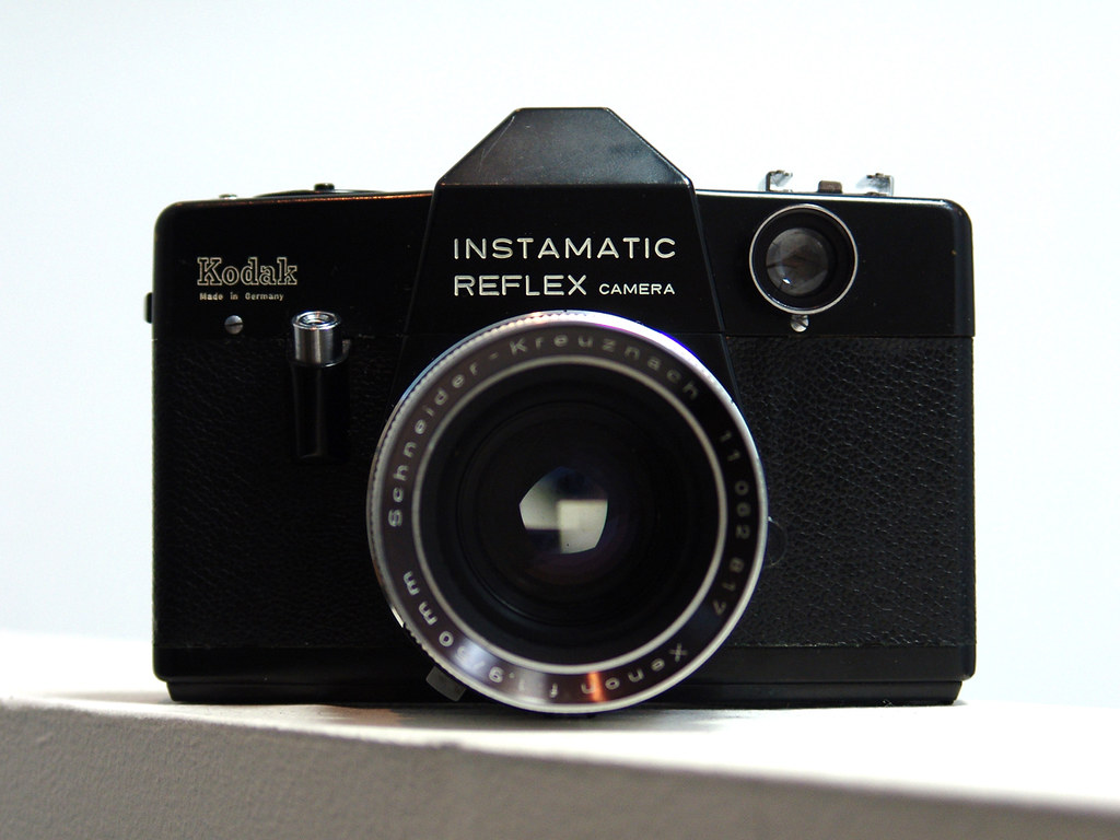

Perhaps the mystery lens is from the 126 Instamatic Reflex?
