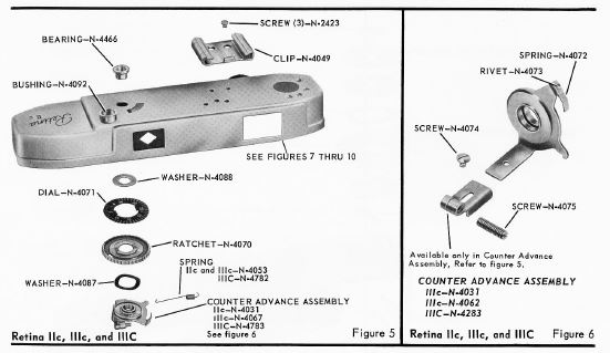

The film counter mechanism in that camera has a screw that hits an arm on the shutter cocking rack, if the screw is backed too far out it can advance the counter more than one position. If this is the case, the top cover can be removed, the screw tightened a bit and then the top cover replaced and checked. The correct position of that screw will be such that the counter advances only one position each time the advance lever is pulled and the corresponding white line on the counter dial lines up with the notch cut in the top cover.

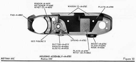

Additional details to supplement post #4
Wow! Thanks Hunter and Brian! That looks like something I should be able to do. The description and pictures help immensely.
This is correct. Turn the screw 1/4 turn, test and repeat until it's correct. The screw in question is the part labeled N-4075 in the above diagram.
I've just finished adjusting the counter in my Retina. It's now working beautifully. I watched a Chris Sherlock video to see how to remove the top cover, and the advice here on this thread to adjust the counter. It required several full turns of the screw to get it down to a single step advance. I have no idea how it got out of adjustment so badly. I know it wasn't anything I would have done.
