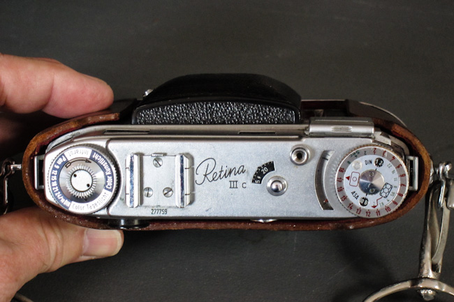

*So I posted this originally in the 35mm forum*
Hello all,
I just purchased a Retina IIc about a couple of weeks ago. I am currently brainstorming a photo project which will involve indoors portraiture. Here are my obstacles:

1. What sort of flash can my camera take on it's hotshoe?
2. How can a fire multiple (3) flashes at once? I read something about a remote receiver (or something along those lines) that can be used to trigger multiple off-camera flashes.

Your camera does not have a hotshoe. That is a cold shoe. It simply holds the flash in place.
On the outer barrel of the lens should be a 'PC' connector. This will look like a small round nub with a metal outer barrel and a hole in the middle. You will need to connect a flash to this for sync. And you will need to make certain that the flash sync lever (green??) is set to X, for electronic flash.
One nice thing about your camera is that it has a leaf shutter. This will sync up to 1/500 speed, nice for fill and balancing ambient light.
When I have done multi-flash work with old leaf shutters, I found the best thing was to use a small cheap flash on the camera connected to the PC terminal as a trigger for the other flashes. You will find that many flashes and accessories are hotshoe only, no PC cord. There are PC to hotshoe adapters available with cords- you plug in the cord and mount the adapter's hotshoe block in your cold shoe.
The Strobist site is a good place to learn tons about the kind of work you want to do.

1. The accessory shoe of the RetinaII is a "cold" shoe: as you can see on the photo that you supplied, there is no electrical contact.
2. Checking my Retina IIa, above and to the left of the lens (looking at the camera front side) there is a small green lever with two positions: M and X. Use X for electronic flash.
3. Below and to the left of the lens (looking at the camera front side) there is a coaxial contact, pointing downwards, that seems to match the (standard) coaxial cable of my vivitar283.
If I had to do what you plan, I would wait for an occasion to buy on the auction site an Y junction and two long cables for the two flashes. Rather than embark into wireless, seems not consistent with the vintage of the Retina. But that's your choice.
Check with a simple one-flash setup that the sync contact of the Retina is functional, before purchasing fancy equipment.
