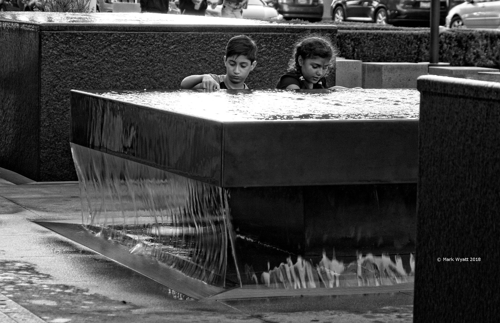

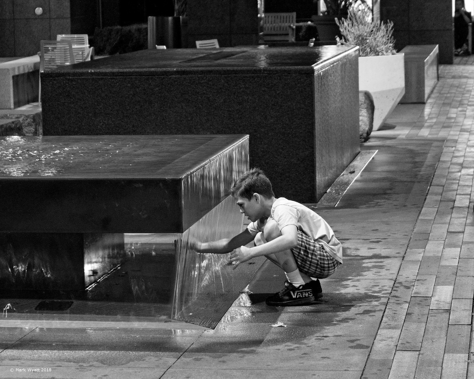

Here are a couple of examples of curtains on some unique fountains near where I live. The two larger fountains are vertical slides. The smaller one in the middle has a short vertical slide and a curtain. It also shows what happens when you do not use edge guides.
Fountain Kids
by Mark Wyatt, on Flickr
This curtain appears very stable. Some curtains will become unstable if disturbed.
Curiosity
Curiosity
