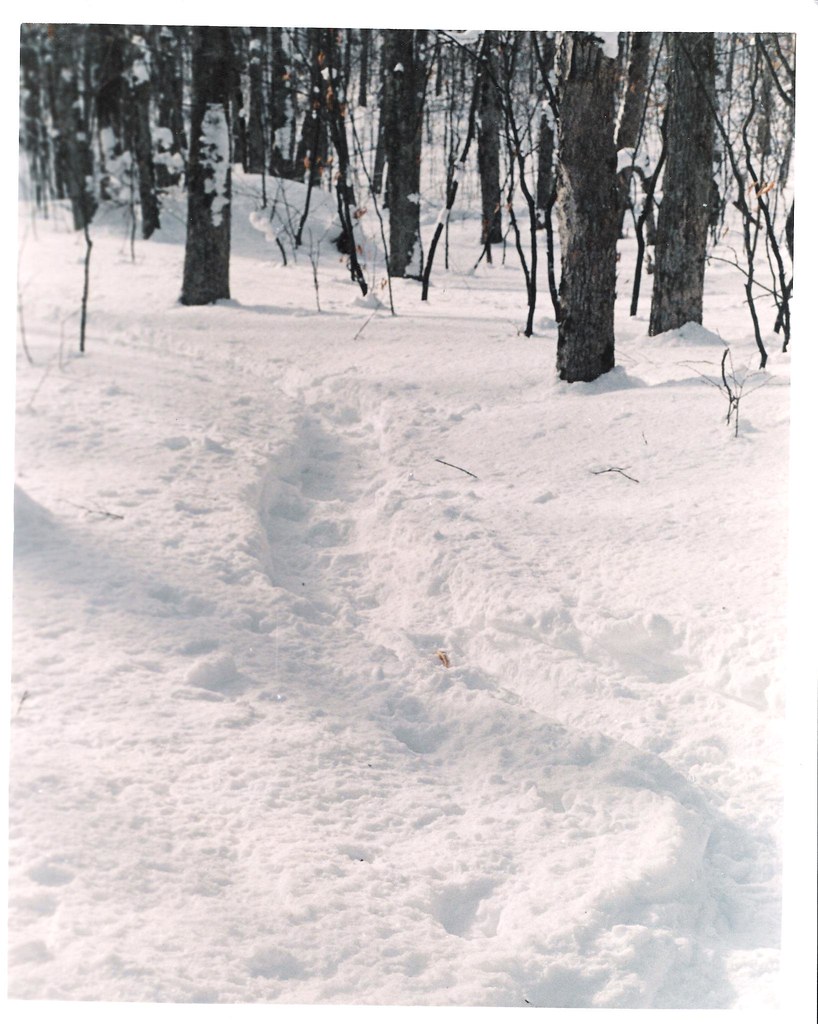

Not a very color sample, but it came out well I think!
mikecnichols
Aug 24, 2010
345
Marion, VA
Mike, is that you first ever colour print?
Yes, I'm going to do something a little more "colorful" tonight. This is from my lastest roll of film and was easy to grab from.
The print is printed on Fuji CA Type II.
Enlarger: Beseler 23DGA Dichro
Lens: El Nikkor 1:4 50mm at 5.6
Exposure: 4 second
Filtration: 50M & 40Y

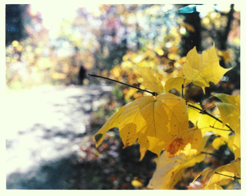

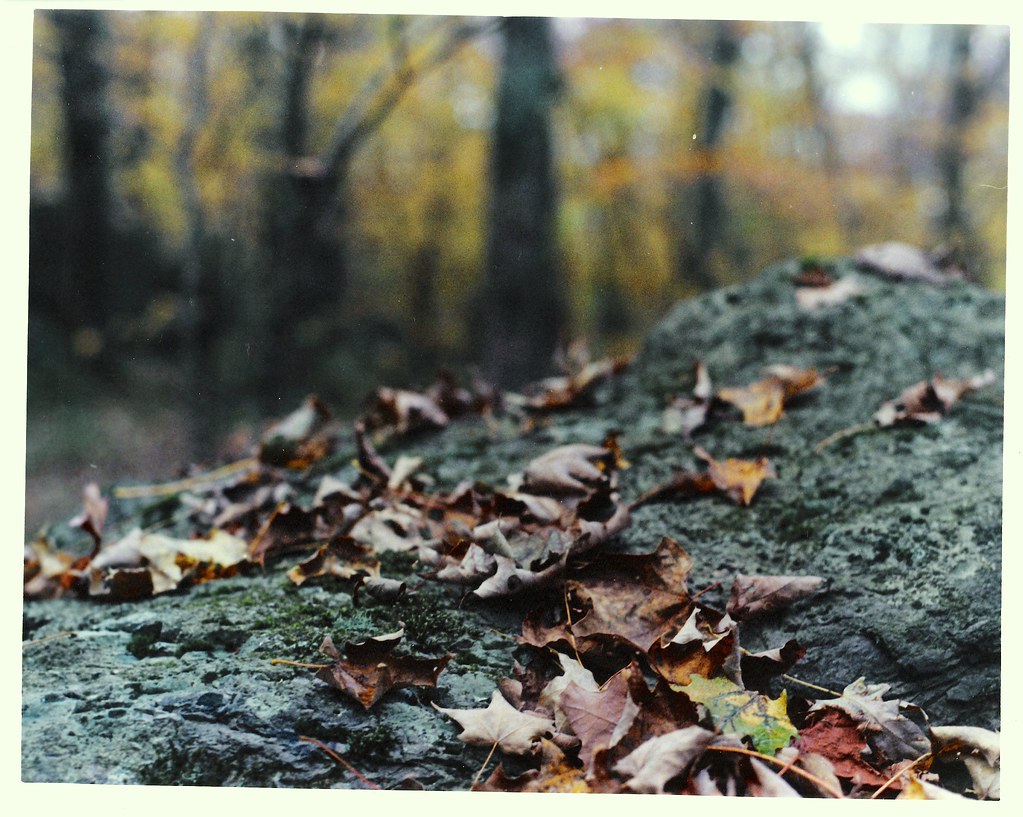

Here are the two images I printed last night. The scans were a bit "cooler" than what I printed, especially with the first one. I digitally fixed this so that the scans represent what the actual prints look like.
Okay, as for my questions for analyzing. What I did to print these was to take the first image I printed and did an integrated reading with my PM2L Color Analyzer and based the filter settings as such. The first shot I exposed for 5 seconds as I had based from the first print. The second one, I thought I'd experiment with a longer exposure which ended up being 8 seconds. Now, what I would like to ask is what should I take from the prints I received? Obviously, 8 seconds was too long as the image is a little too dark for my tastes. The print did have a cool look to it when I would rather have a warmer look. The leaves on the rock should be more red-brown than they are. From here, what should I do to adjust? I'm still figuring out how to manipulate the color filtration. Thanks for any help you guys can offer.

I see a bit of blue or cyan-blue in the prints. If I were you I would do some test strips with a variety of red and yellow adjustments.
The subjects themselves may not be the best to learn on. It looks to me that the foreground is probably illuminated by open shade, while the background is illuminated by sun.
If I were you I would try to take some test shots of subjects with known colours, in even light. If you can have something like a colour chart in the scene, that would help to.

Use a MacBeth color checker or something like that, and match it up in a well lighted print. Once you do that and stick to the same film, you will have less than a 10 correction between R, M and Y. Probably even less!

I don't have any special colour checkers so when I first print a new type of film I make sure I've got a photo of a person in one frame in normal light. This is usually my wife and I find I can balance the colour quite well by looking for casts on her skin. Once I've found a 'base' value for a film, the difference between frames is very small and often there is no difference.
