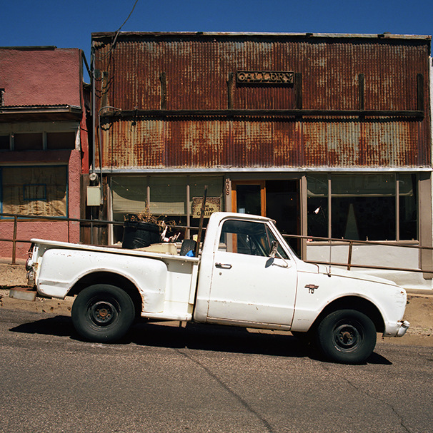

Here is the image in question. The particulars, not that I think it matters, are:
Kodak Ektar 100
Norita 66 body, 40mm f/4 lens
Commercially developed, scanned on Epson 4490 scanner.

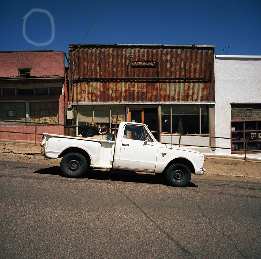

Here is the image with the number 6 circled. It's very faint but quite distinct when you see it.

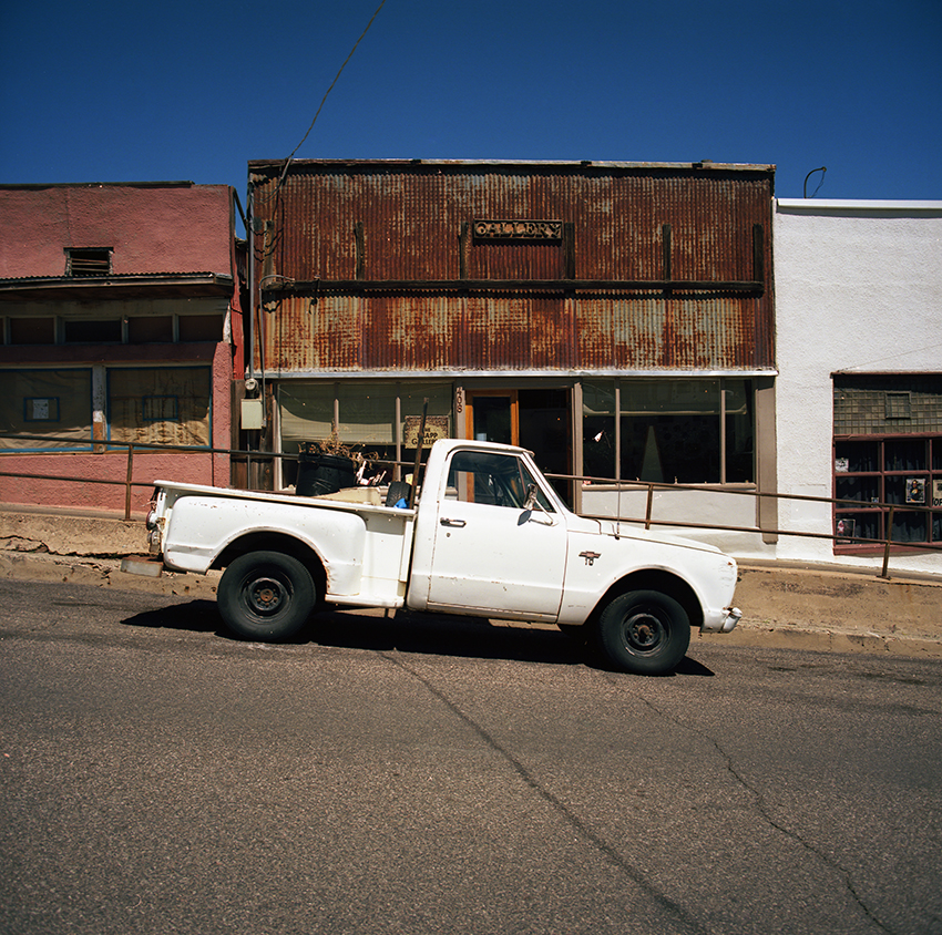

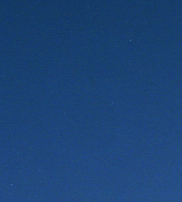

Here's the number in its natural state, and then next, outlined so you can compare.

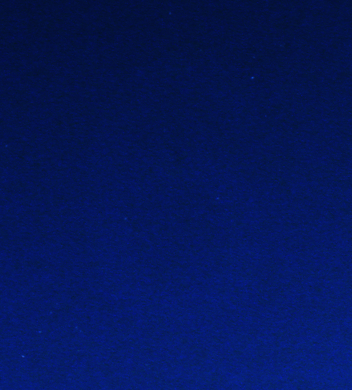

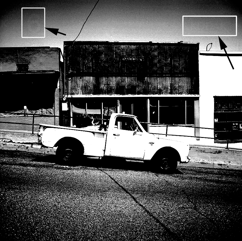

I tortured the colors a bit in Photoshop to try to bring the six out a little more.
Any ideas as to what happened here? As time permits, I'll be going back through the rest of the negatives and checking them, and I'll report further if there are other developments.

It is hard to see, but it is there. The problem could be the same paper backing problem we saw earlier. Let Kodak know, but they are probably aware to the problem since the problem had already risen on black & white films.

I can read Kodak in the sky on the right side.
Roger
Wow, now that you mention it, so can I.
