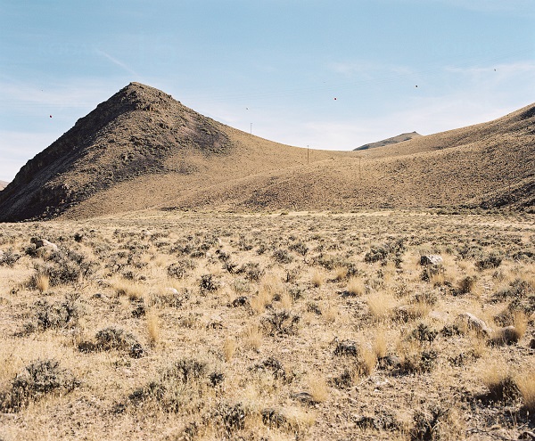

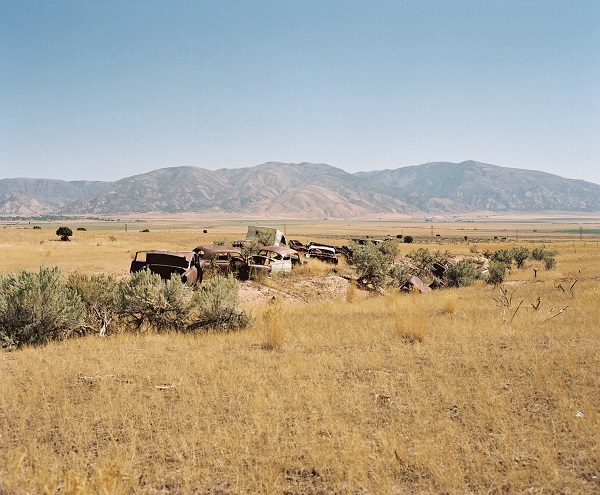

These are from my rolls of Portra 160. I have more examples but I am only posting these.
Picture 1:
Above the hill on the left says "Kodak 15" and on the right it says "Kodak".
Picture 2:
The sky says "Kodak 12" multiple times on the left and again "Kodak" on the right.
If this is something I have to start worrying about, I think my time with film might be over...
Joking apart from my previous comment and returning to the subject in a serious way (without abandoning the good humor in my case) with all due respect to this problem and the person behind, I do not understand any kind of decisions. Switching from one system to another does not remove stains or markings on sensitive material. In fact the sensors are much more delicate in that sense (I do not say that this will be your case, of course)
Back on film - which is what interests in this electronic land -, it is very complicated to be/stay away from all kinds of marks 100% (Water, dust, scratches, ... etc) there are many examples as we all know. Again, we also know that they are, of course, of quite different condition than this "brand-case" to be treated, but as I said above with other words, "fighting & whistling while working" in a healthy way, with lots of good information, will help better.
Generally speaking (not only in these kind of cases) I also do not understand not having our notebooks with us (but I can understand that it goes with the way of working for each one, and I am not pointing to anyone with this), perhaps I see it easy, because I always carry one notebook with me at all times and understand it as a fundamental tool, enriching and fun part of the process.
It would be a very good idea, if in these types of posts we also have that other reference for those type of problems, as much information as possible about the film, and its treatment from its purchase to its archiving, and not only posting the visual reference as a complaint. I know again that it implies that the user has the control and the desire as a personal way of working and keeping things (If I may compare, just simple as when we keep official documents and discard them after a while because they prescribe) ... In my opinion certain data would help to shorten various factors trying to sort these issues out, and all those things & info. are what I miss in this new post, just like before with my #10 interrogation ...
Resign or give up is not the option, and I do not say that is your case either TimVance, but is not a helping message either, although again respectable. I encourage you to continue with film, and if anything must be done, you have too many other options, like trying another "trade name", which in my view is not the solution either, we all know, from our own experience in the dark, that different brands have different results & qualities (according to the intentions of each one) and that would also be lost. To each his own.
Best Regards and Good Luck!
Picture 1:
Picture 2:
View attachment 170221 View attachment 170222

As written here and in other thread multiple times, the problem is known for some time now (one of the threads you linked to is two years old!), it has been acknowledged by Kodak and they have taken steps to correct it.
These "Me too!" kind of posts are not really helpful at all, unless someone can tell us WHEN this happened, and provide the batch number and expiry date of the film used, so it can be determined if we are talking about yesterday's news (= the film was from an older batch that is known to be susceptible to the problem) OR from a batch that was made AFTER Kodak took corrective measures, which would indeed be alarming.
Other relevant information: How much time elapsed between exposure and development and whether the film was subjected to any extreme heat/humidity.
And last but not least, this should also be reported to Kodak Alaris
