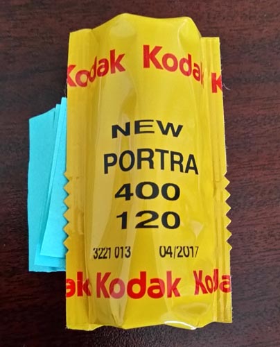

Apologies if an updated emulsion list exists elsewhere; I didn't come across it. My latest affected stash (I've had both Tri-X and TMY2 with this ink offset issue previously) is emulsion batch 3221 013, date 04/2017. This propack has already been replaced promptly by Kodak, but if anyone wants the three remaining rolls of Portra 400, they're yours for the cost of shipping (from Philadelphia, USA). Send me a PM if interested.
