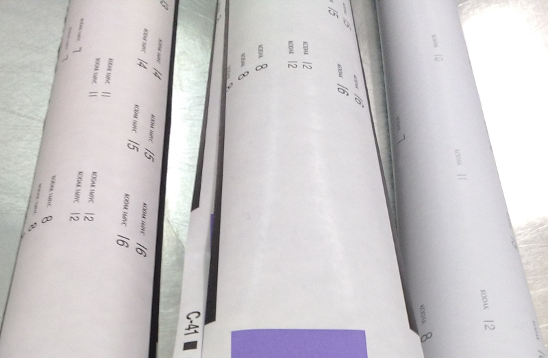

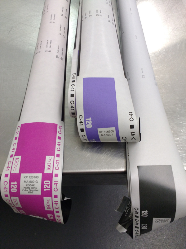

For what it's worth here are a few backing papers of some Kodak C-41 120 films I processed on Tuesday - exp 2007 160VC on left, exp 2011 160nc in middle, exp 08/2018 Portra 160 on right. The new printing style is clearly obvious & there is no evidence of offsetting etc from any of the films on the high-res scans I have done (Hasselblad X5 for reference). The older films were given to me shortly before Christmas & I bought the Portra 160 pro-pack about 1 month ago. The ink density on the 08/18 is in the range of Ilford's 120 films I think.
View attachment 171076 View attachment 171077
There are other examples of backing papers (there was a url link here which no longer exists) even with the papers appreciated under ultraviolet light.
Very kind of you to share this anyway, should you have any other information about that, do not hesitate to share, I would be grateful
Thank you Lachlan

The irony inherent in your post (which is still much appreciated by me) is that to the best of my knowledge the backing papers you show are outside what I understand to be the problem batch(es). 2007 and 2011 develop before dates are too old, and 2018 is too recent.
Should've put that in my post - the point was to show that the problem is (hopefully) in the past.
