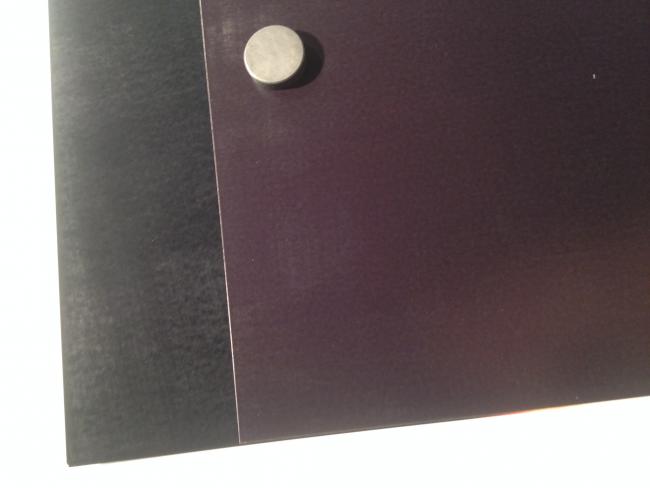

The Paper on the right is the D-Max of Fuji CAII and on the left is the D-Max of Kodak PROFESSIONAL Endura Premier.
Both were exposed under white light for 10 seconds under the same enlarger with the same settings. The paper was then put through a temperature controlled RT paper processor. The results are clear...
**Please exuse the crude image, it was taken on my iphone. The paper is dirty because it fell out of the processor onto the floor, oops.
Hmmm...That is such a large difference as to be difficult to believe. Not that I doubt you, but I can't help but wonder if some other variable came into play
Hmmm indeed!.. Look at the off-color. I've never seen anything like that with Fuji paper. Never. Or maybe it's just the cell phone and web
I haven't printed color in many years but, based on experience with different B&W papers, I think your testing procedure is flawed. The different B&W papers I use require different exposure/developing time to reach D-Max. All you've shown is that, at 10 seconds, you think Endura reaches D-Max, while the Fuji does not. It doesn't show that the Fuji wouldn't hit it (and perhaps match/surpass the Endura) at 20, or 25, or 30 seconds.
I'll leave it to those that have extensive use of both to tell me if I'm wrong, but I can't imagine a paper which displays as you've shown to have lasted more than a week on the market.
What Eddie said. That test really doesn't prove anything, except perhaps that CAII produces a color cast with your enlarger set for white, which can no doubt be filtered to neutral.

I'm not saying Fuji as a company sucks, nor am I discouraging home C-printing. I really like Fuji professional transparency and negative film. I'm saying that Fuji Crystal Archive Type II Color Enlarging Paper SUCKS as a product itself. It is a minilab paper whether you want to believe it or not (the characteristic curve on the tech sheet says it all). Pro labs don't use Fuji CAII, they use Fuji PROFESSIONAL Enlarging Paper which is Fuji Crystal Archive Professional Super Type P, Fuji Crystal Archive Professional Super Type PDN, Fuji Crystal Archive Professional Super Type CN, Fuji Crystal Archive Professional Super Type PDII. Notice that all these papers have the word PROFESSIONAL in their title. Thats because they are professional papers. Nowhere will you ever find documentation that says Fuji Crystal Archive Type II is a professional paper because it is NOT. If you claim to achieve great results with this paper, then great! But I personally find this paper inferior to any other professional paper out there. I do not like it, so I will not advocate for it. I will advocate for Professional papers such as Kodak Professional Endura Premier or Fuji Crystal Archive Professional Super Type CN.
It sucks just because, either you haven't gotten to first base yet (i.e., you don't actually know how to use it properly), or perhaps you've gotten ahold of the wrong type of paper altogether. I'm sorry, mcgyvr, but your information is complete nonsense on all counts, and frankly, I suspect your methodology is flawed. CAII is a broad product category in various surfaces, sizes, and even different substrates entirely, and implies certain improvements in image stability and printing characteristics over the old Super C and P. But the processing variables and even color balance are only a tiny bit different. If you prefer Kodak paper that's fine ... glad it works for you, and by all means get the word out what you like about it. But in terms of wisecracking about the incompetence of Fuji paper, two or three people on a web forum aren't going to sway the opinion of the many labs worldwide which routinely use CAII with proficiency, nor people like me who know from experience that it's a very fine product directly descended from Super C, and damn easy to print. In fact, the Fuji Supergloss
