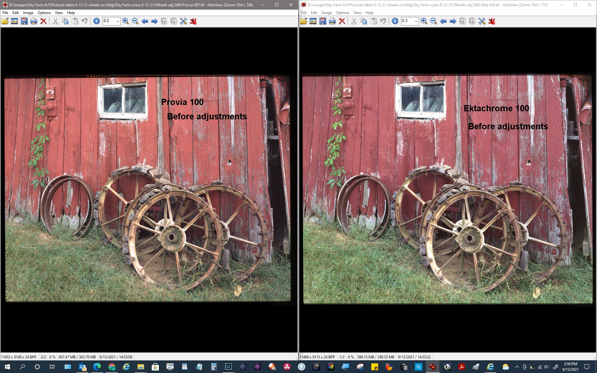

Here's my test of Provia and Ektachrome. Ektachrome has redder reds and more intense greens. (4x5 originals scanned with Epson V850 edited in Lightroom).
