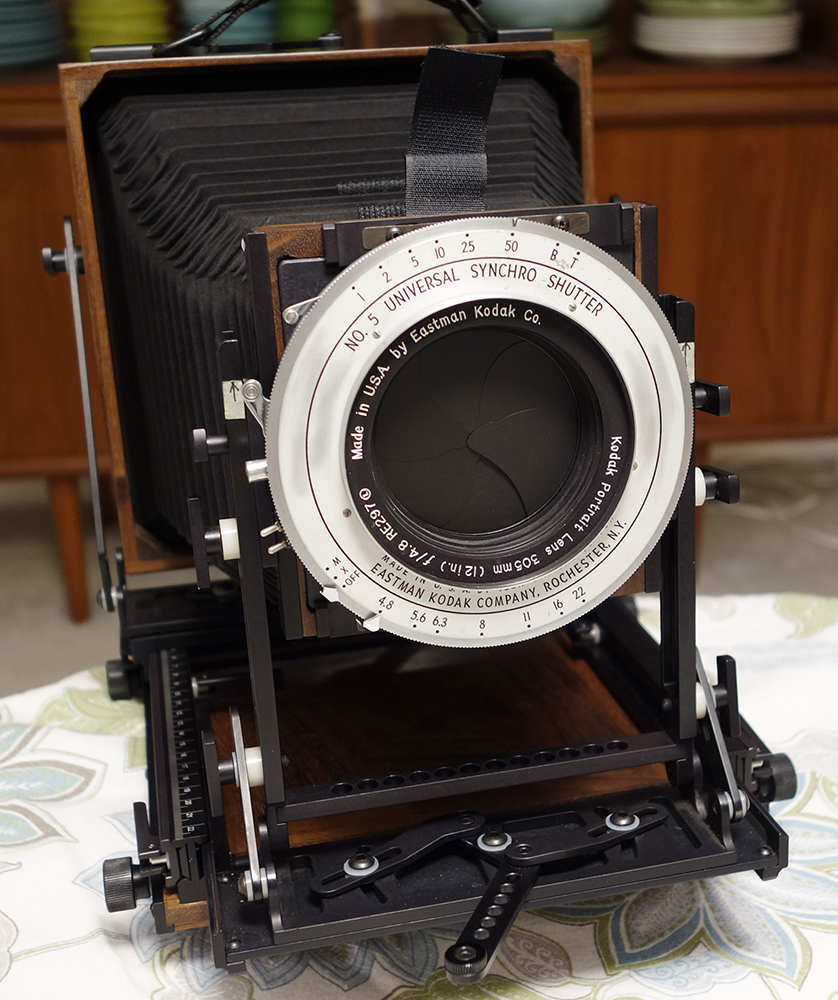

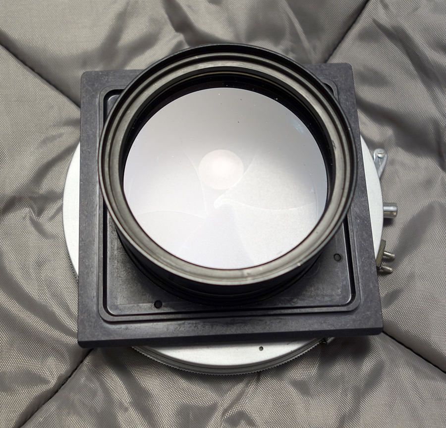

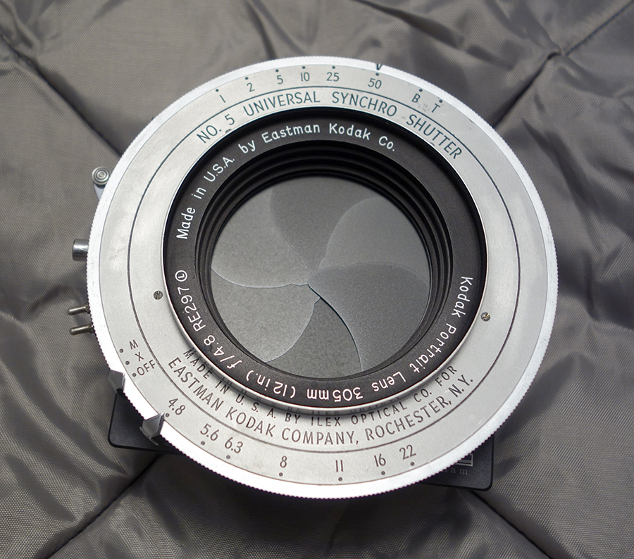

So here you are - the Kodak Portrait 305mm mounted on a standard Canham lens board. Front view - the lens board is just barely visible behind the #5 shutter. Rear view, you can see how the lens element dwarfs the lensboard. Mounted on the Canham 4x5/5x7 camera - it just fits! S.K. Grimes added a spacer on the front side of the lens board which pushes the shutter out just enough from the lensboard so that nothing interferes with the front standard.
